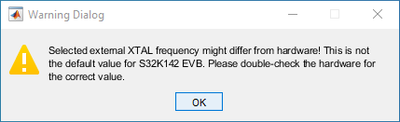

This is a minor issue.
We are using a custom board with S32k processor that uses 40mhz crystal instead of the 8mhz on the evb. When we are compiling from simulink we get a warning that the selected XTAL frequency does not match the one found on the evb.
I'm wondering if there is a way to turn off this warning.
Thank you

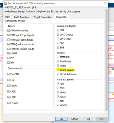

Hi @ruihang_wu ,
To disable this warning, you have to uncheck this highlighted check from "Diagnostic" tab of MCU config. block.
Adrian
