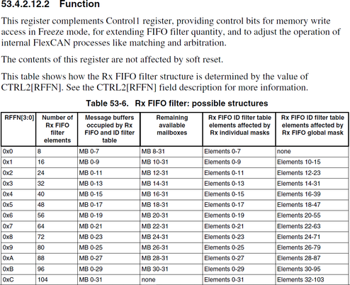

Hi, I have a CAN bus which receives 85 messages every 100ms. I currently use 18 MB's to split these as I have 16 external modules which send all of the CAN messages and each space their messages out over the 100ms (each module at same time sending 5 messages 10ms apart).
I was wondering if using a Rx FIFO would be better and just as reliable as using the 18 MB method that I currently use? Will changing would allow me to use CAN transmit in non-blocking mode as I will have enough MB's available? I am not sure how many MB's the filtering we occupy.

@paulvlase would Rx_FIFO be the better option for my application of 85 messages every 100ms? And how many MB's will that occupy?

Hi @Poley ,
Well the use of Rx FIFO depends on if you can fit your received message IDs into the available Rx FIFO filter elements.
As you can see in the following table, the 4th configuration will allow you to configure 32 filter elements, and having the remaining 18 MBs, 14-31, for Tx. Now the only problem is that only the first 0-13 filter elements have individual ID mask, all the other have a shared global ID mask.
From what I know there isn't a way to detect when a certain message has been put onto the bus, not until it is received by the FlexCAN peripheral. If you use the 4th Rx FIFO configuration, you will have 18 MBs, 17 MBs for Tx, and the remaining 1 MB you could use for normal Rx, non Fifo. This way the Rx Complete event will be triggered as soon as possible once that message is received and in the triggered subsystem you will initiate the receiving of other CAN messages.

I have 16 nodes sending the same amount of messages to the S32K148 board. Each node is increased by 10 hex. So I have board 1 send 0x301-0x305 and board 2 sends 0x311-0x315 and so on up to 0x3F1-0x3F5. I also have messages 0x521, 0x522 and 0x523 that needs reading. All messages are at 100ms and the 16 boards send their messages out at 12ms apart. so will receive 16 messages every 12ms at the same time. I can change the ID's on the 16 boards. Does this look like RxFIFO would work for my case?
For the last part, do you mean I transmit 0x3F0 for example but I also use a receive block for 0x3F0 and then I can use that receive to indicate that the message is on the bus?
Lastly do you have any idea why when I send all 85 messages to the main board it slows my model down by 6%? I have the time step to 5ms now as well.
