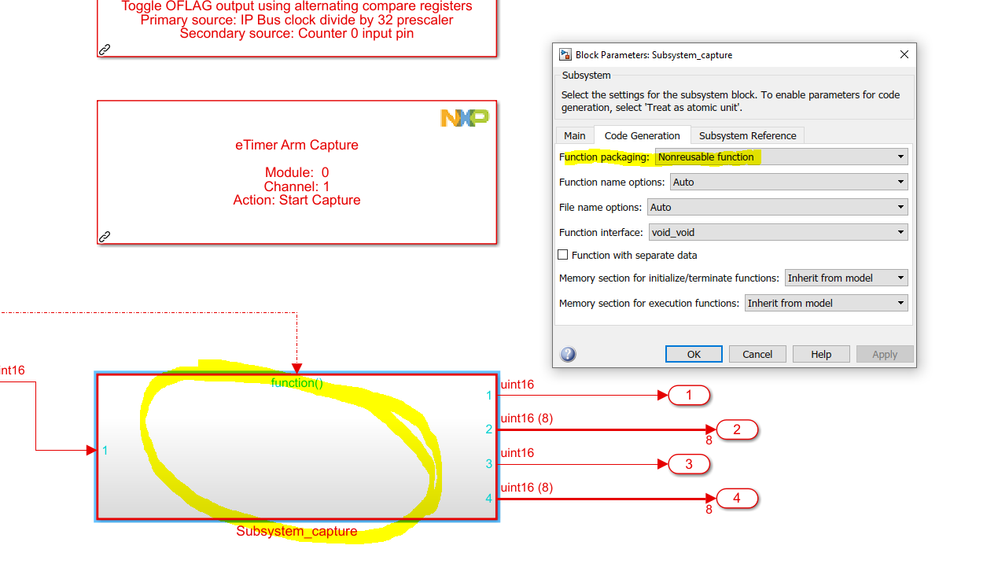

   I am using the input capture unit in the eTimer example (Simulink Model based) to output the frequency and duty cycle value of a FlexPWM signal, the model is successfully built and the outputs are correct, BUT when I try performing PIL I always get this error ("The + operator only works on numeric arguments") related to a .tlc file.
Does anyone know how to fix it?

mariuslucianand
Hello @Dina_ayoub
Thanks to @paulvlase the fix is pretty simple.
You have to go to the capture subsystem, right click on it, select "Block Parameters" and under "Code generation" you have to select the Function packaging as  "Nonreusable function".
The measured values looks like this:
Hope this helps,
Marius

Dina_ayoub
  I tried your solution but when I went on running the PIL I got the attached  error. I am using Simulink 2018b, NXP_MBDToolbox_MPC57xx version 3.2.0
