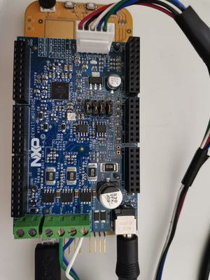

Please be sure that you have connected motor phases as it should be and jumpers must be in the right position.
Adrian

Thanks for the reply. I noticed that the comment box set to set J9/J10/J11 to 2-3. Looking at the nu bers printed on the underside of the MOTORGD board, I believe your photo has J9/10/11 jumpered from 1 to 2... Which is correct?
With this configuration, the motor jitters back and forth but doesn't spin. It also doesn't have an IDC fault, which seems like progress.

J9/J10/J11 must be in 1-2 position (PMSM position).

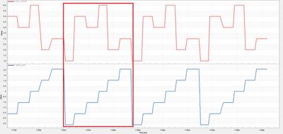

Please use this model to synchronize the Hall sensor with motor phases. This model is the PMSM open-loop model modified with Hall sensors observer.
You have to flash this model, open the FreeMaster project, and load the '.elf' file then click on connect. Then start the motor by pressing the SW2 or SW3 button and look at the Hall scope in the Freemaster project. The graph should look like in this photo. If not, then push the reset button on the S32K144EVB board, switch two of the motor wire phases in the J13 connector and start the motor again. You have to do that until the graph it looks like in this photo.

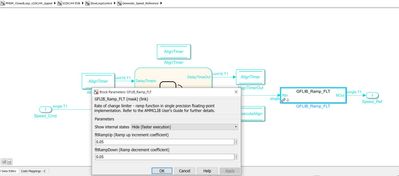

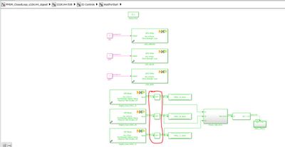

If the motor doesn't spin at the beginning but if you turn it a little and then it spins normally, then you should try to remove those three blocks (logical not). In this subsystem, it's detected the default position. These types of motors are not identical. The hall sensors are not perfectly aligned for all of those motors.
You can adjust the ramp of speed changes, if your motor it start to speed up very fast, by adjusting the GFLIB_Ramp_FLT coefficients.
But if your motor looks like it oscillating (speed up very fast then it speed down or it starts to speed up until it enters in current limitation) try to adjust the Ki and Kp coefficients of current controllers using FreeMASTER and you can try even to adjust Ki and Pi coefficients of the speed controller.
