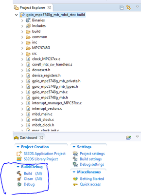

gaoyuelei
Hello, @mariuslucianand
It has been modified according to your suggestion, but it still can't be compiled, as shown in the following screenshot:
What changes are needed later,THANKS.
4,013 Views
mariuslucianand
Hello @gaoyuelei ,
These should be the only changes to do. At least it works on my side.

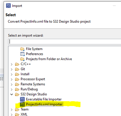

How do you import the project?
I've tried File -> Import -> S32DS and select ProjectInfo.xml Importer and select that XML file.

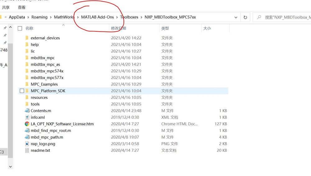

gaoyuelei
The import method is as follows, but I found that the path folder where MBD toolbox is installed contains spaces. Does this affect?
3,979 Views
mariuslucianand
Hello @gaoyuelei ,
I think the spaces affect the importer. Please install our toolbox in a path with no spaces, this should solve many issues as well.
