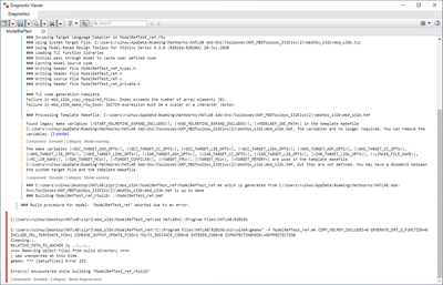

I am trying to use model references in my project. If I compile the model without any references it works fine. But if I convert a subsystem to a model reference, error occur when compiling.
I have double checked the system target file and the template makefile on the model reference are the same as the main project file. Is there anything I need to change when creating a model reference?
I have attached a simple test model where the error occurs during build

Hello @ruihang_wu,
I am sorry for my delayed answer. Unfortunately, when it comes to reference models, the limitation we have on the S32K toolbox is that our main Configuration Block must also be in the reference models, even the referenced block has no NXP block in it. This should not affect the simulation.
Hope this helps,
Marius
