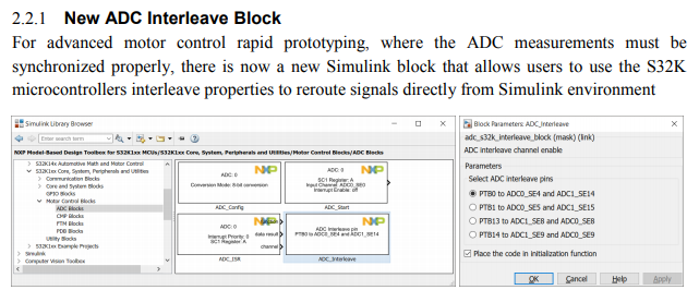

Daniel_Popa
Hi alexisberthon‌,
Sorry for the delay caused mainly by Easter break.
Here are my comments:
He needs to control a motor of 12V/30A and for evaluation he needs the closest configuration to evaluate S32K plateform.
I know you propose some kits with DC motor included (S32K Development Kits 3-phase PMSM and BLDC Development Kits | NXP ).
Any of the kits should be fine. The main difference between the kits consists in the default jumpers configurations, resistors placed on the S32K144 carrying MCU board and the SW flashed into the memory. All these can be updated by the final customer based on his/her setup requirements.
Now, considering the 12V/30A requirement, you should be aware that the MotorGD shield cannot deliver such power. The maximum power should not exceed 60W or 5Amps RMS.
What could be the best choice for the customer ?
The customer could start with the kit, but then he/she must design a custom inverter to deal with the power requirements for his/her own motor.
Another alternative would be this evaluation board: https://www.nxp.com/design/designs/s32k142-24-v-motor-control-reference-design:S32K142-MC24
Customer could manage to adapt their motor on the kit after ?
It is possible to increase the range of the MotorGD inverter, but there is extensive rework that needs to be done in order to make capable of running higher currents. Transistors and the current shunts need to be changed.
Regarding SW configuration, what tools are needed in this case ?
There are multiple offers:
You say that the ADC are not available in simulation but into the specification its look working well. Do this is link to the fact that the motor is simulated?
The ADC converters blocks supported by NXP Toolbox can't be used for Simulink Simulation. If the customer wants to use if for Simulink modeling, then he/she should implement a simple A/D conversion.
The block you have shown above ADC Interleave is a special block supported by the NXP Toolbox that allows the users to enable the ADC interleave option in the generated code. The HW has a special functionality that allows you to reroute internally some of the ADC inputs to various instances of the ADC peripherals. This way you can synchronize the current measurements easily.
Hope this helps!

alexisberthon
Hello Daniel,
thanks for your feedback.
In fact, the target of the customer is to use an interface shield to use their motor with an S32K eval board.
Thanks a lot for your support, as I'm a little bit confused about how to give the best answer to my customer.
Alexis
