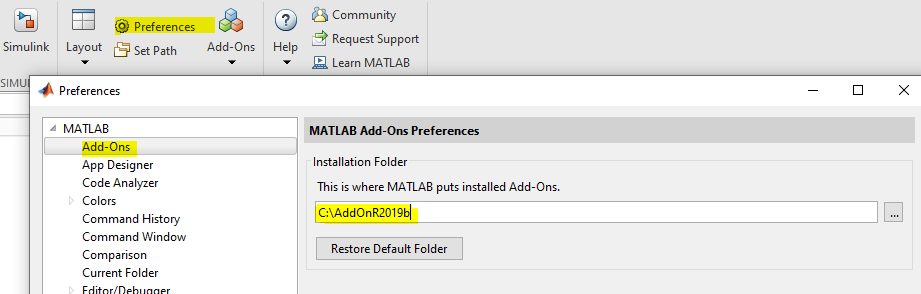

saranya_chitta
I have MATLAB R2019b and working with NXP S32K144. I have the 4.1.0 version of MBDT downloaded and when I try to drag drop it to Command window in MATLAB R2019b, and I also accept the license agreement, I see an error saying
"Installation Error
Toolbox cannot be installed. Installation path is not accessible."
I tried another way. From MATLAB Add-on manager, I tried to add NXP support package for S32K1xx V2.1.0 and it doesn't get added to the add-on manager.

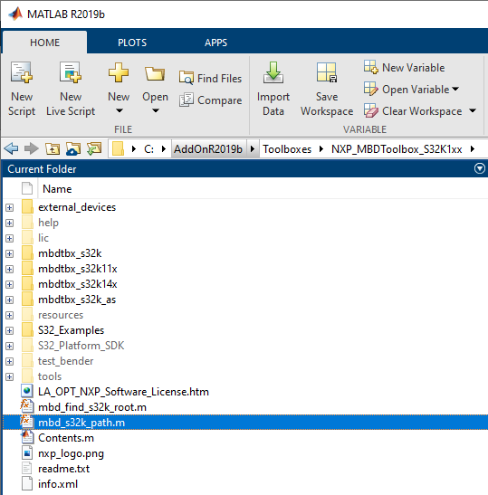

In order to install the toolbox on the R2019b, you can try two other methods or workarounds:
1. Since the error message is "Installation path is not accessible" you can try changing the R2019b AddOns to a location for you to know that your user has the permissions to write. Now you can try again to install the toolbox.
2. If the installation is not working using the previous approach since you already have the tool installed on R2018b, you can perform the following setup. Basically you can keep the installation files in the location for the R2019a, but use them inside R2019b.
For this, go to the path where the toolbox has been installed on R2018b. Default is C:\Users\{your user}\AppData\Roaming\MathWorks\MATLAB Add-Ons and locate the toolbox folder. Now, access that location from the R2019b. it should look like this. By running the mbd_s32k_path script in R2019b you should be able now to successfully run the S32K Toolbox in R2019b.

mariuslucianand
Just for the future similar issues, for saranya.chitta@magna.com‌, changing the default Matlab's path (first approach) solved the issue.

You can install the toolbox in R2019b by simply drag and drop the mltbx in the command Window of R2019b. Also, if you have a common location for the toolbox between the both Matlab versions you can run the NXP_MBDToolbox_S32K1xx\code\mbd_s32k_path.m script in the Matlab version you need. This will add our toolbox in the Matlab version path and you will be able to use our toolbox.
Regarding the version 3.0.0 and 4.1.0 you can have both toolboxes, but do NOT keep both of them in Maltab's version path. When you need to switch between versions, please remove the one which is not needed from Matlab's path by going to SetPath->Default-> Save and then run the mbd_s32k_path.m for the version needed.
