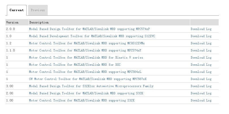

        Thank you very much.Your answer has solved my problem. But I have another question. Why can't I find the model based design for matlab /simulink MBD supporting MPC5604P?Can you give me some information based on model control for 3-Phase PMSM Kit with Qorivva MPC5604P MCU? What I'm using is 3-Phase PMSM Motor Control Development Kit with Qorivva MPC5604P MCU.)$[M[[~Y$3`7}4`Q(UT`HBD.png
4,358 次查看
Daniel_Popa
For the second question the answer is here: https://community.nxp.com/thread/462635#comment-954320
