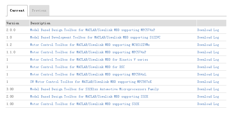

Hello, If I want to use the 3-phase PMSM Moter Control Development Kit with Qorivva MPC5604P MCU this platform for model based control,generate code automatically .What software and information is required?
 I can not find the model based design for matlab /simulink MBD supporting MPC5604P?Can you give me some information based on model control for 3-Phase PMSM Kit with Qorivva MPC5604P MCU? Demo or others. Thank you !

Hi zhuaoci‌,
Unfortunately we do not have a Model-Based Design toolbox for MPC5604P. That is an older family of processors that were released far before we started the work on Matlab Toolboxes.
For your reference here you can find all the SW available for this MCU: MPC560xP|32-bit MCU|Chassis-Safety|NXP
Hope you will find something to start with.
