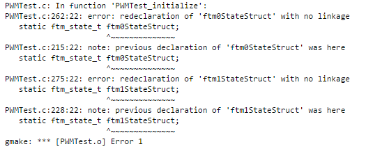

i want to read two PWM Signals with known frequency. So I use 2 "FTM Dual Edge Capture" Blocks, with following parameters:
Capture mode:       continuous
Measurement:       positive Pulse (rising-falling)
prescale factor:      32
first Block:
Module:            0
Channel pair:    2-3
FTM input pin: PTC2
second block:
Module:            1
Channel pair:    2-3
FTM input pin:   PTA15
When I want to compile it, I get an error:
When I comment one out, it works, for both. But when I want to use both together I get that Error.
Can help anyone to find the problem?
Thank you.
Felix

mariuslucianand
Hi [email protected]‌,
I think it was "Really great" if I was careful enough to provide the full patch. Sorry, my bad! :smileygrin:
Anyway, please also update at the same location "src\mbdtbx_s32k\blocks\ftm" the attached file ftm_s32k_common_input.tlc.
It was not working now because the clock for the FTM module 1 was not initialized, the generated code now was only initializing the clock for the FTM0 module used.
I tested the fix using the attached example, but I did not change the description, so you need to connect the PWM2 outputs PTD10 and PTD11 to PTC2 and PTA15.
Hope this helps,
Marius

felix_boeckmann
Hi Marius-Iucian Andrei,
Thank you for your fast help. Really great.
I tried it out, now he generate. But the application on the board doesn't start. I have a blinky LED to see if its running, but now its just on. When i comment one FTM block out, the board works (and my LED blinks).

felix_boeckmann
You are right, now it works. And now its in fact "really great" :smileyhappy:
Thank you!
Felix

mariuslucianand
Thank you for reporting this issue on our MBDT Community!
I was able to replicate your error: indeed, when the code was generated, two sections were generated twice. I attached two files that must be replaced under src\mbdtbx_s32k\blocks\ftm folder path. Before that, please backup your existing files.
Please test them and confirm if this solved your problem.
Hope this helps,
Marius
