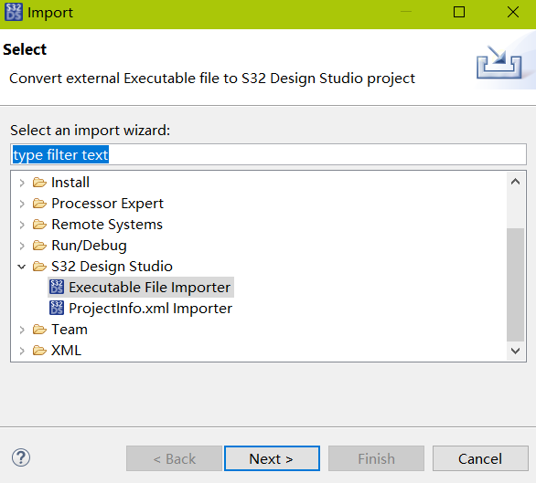

I want to import the generated code in the S32 Design Studio in order to run the debugger.

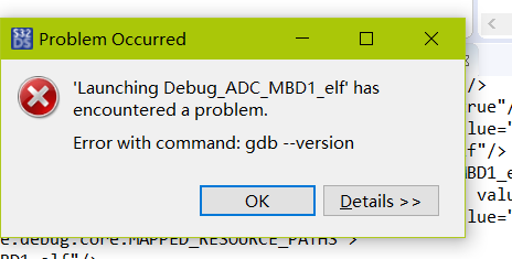

I follow the steps in 搭建好模型之后编译生成的文件,怎么通过IAR和S32DS下载到板子上? but  there is an error.
please confirm the process  and the error,thank you very much.

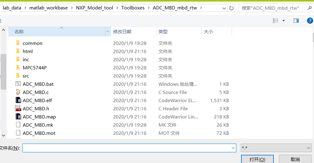

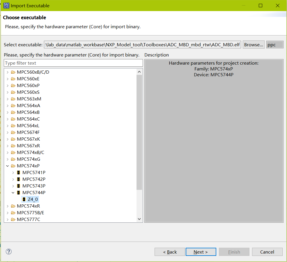

step one: import the .elf file

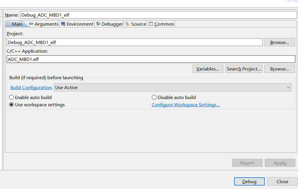

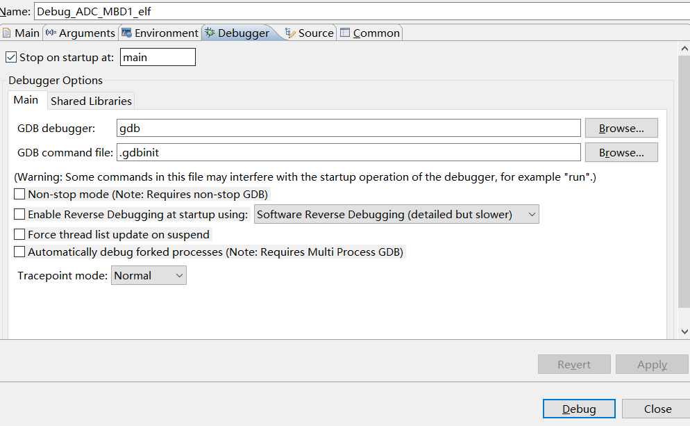

step two: debug the configuration
step three: debug

Hello [email protected],
You could import your whole project into S32Design Studio (source files, startup files, etc.) -- you can follow the steps here - it is for an older version, but the process is the same. The only difference is that the 'Generate S32 Design Studio ProjectInfo.xml file' checkbox was moved into the main configuration block.
Can you try that and tell us if you are still facing issues with it?
