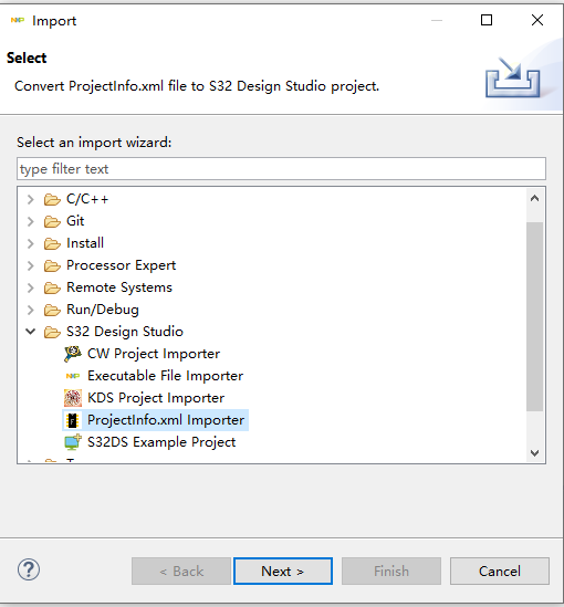

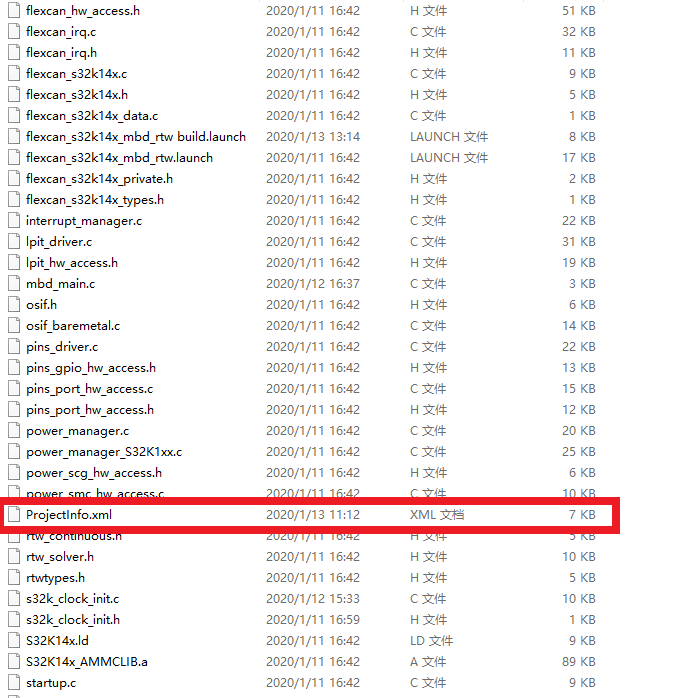

Build the Simulink model as normal. Open S32DS and select Import/S32 Design Studio/ProjectInfo.xml Importer.
Then select the ProjectInfo.xml from the location used to generated the C code for the Simulink model. Also, select the ARM32  Executable option.
Open the debug configuration interface by default.Because I use J-link, I closed the interface first and build the project:

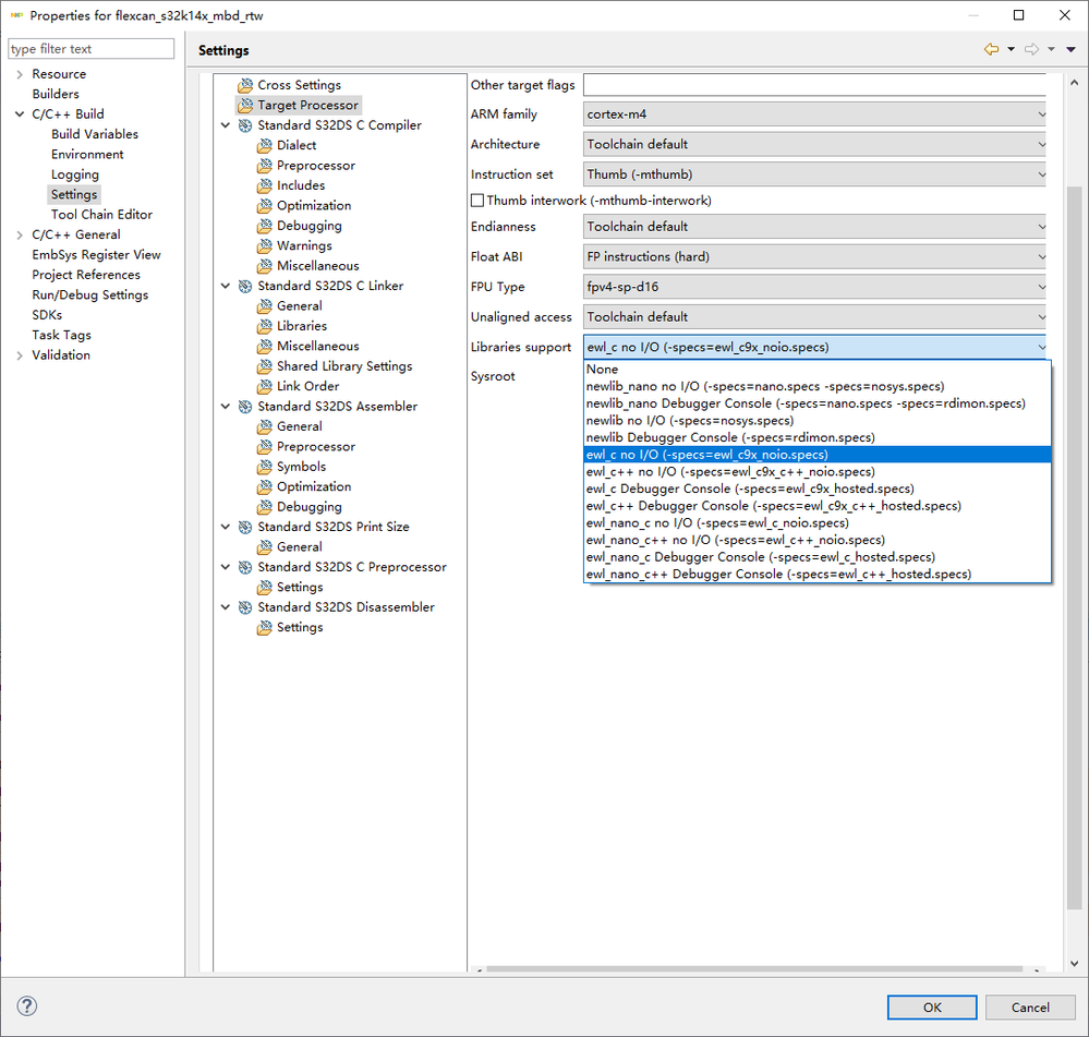

I found a configuration from How to export Generated Code to S32 Design Studio IDE (applicable for MBDT for MPC5744P v2.0)”.
But there's only one similar, I choose the following:
Because my development board uses an external 16MHz crystal oscillator,so I modified the clock profile  as shown in the figure below:

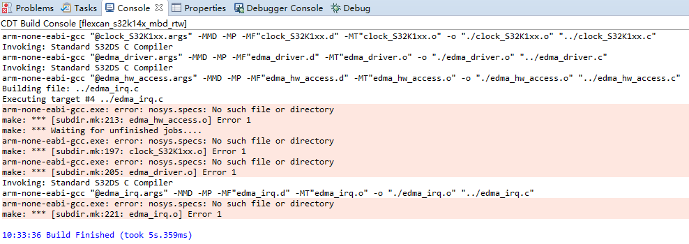

Now the project builded successfully:

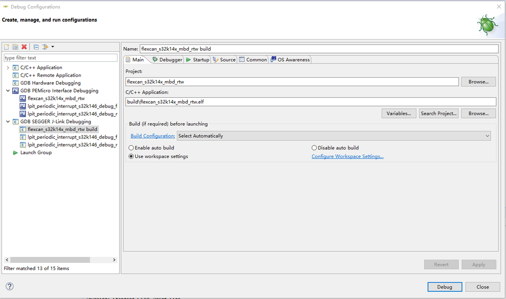

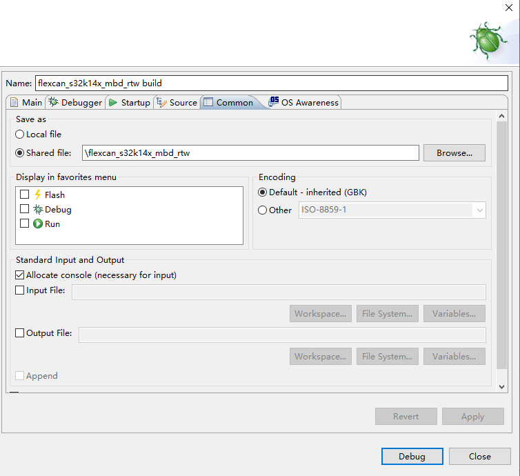

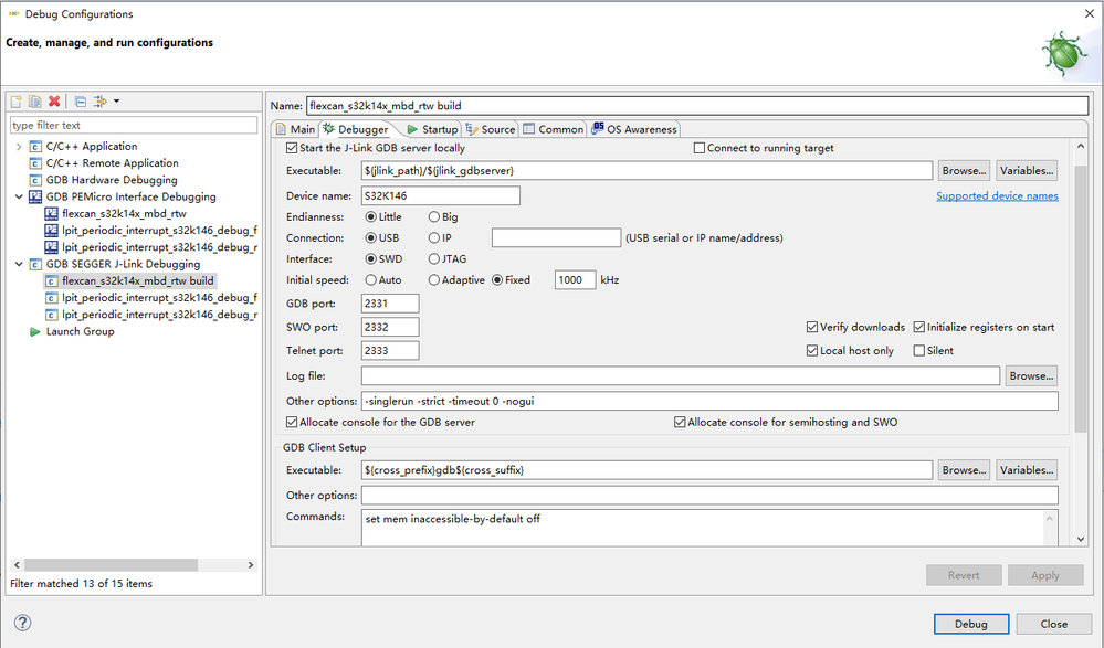

Next, I configure debug as follows:

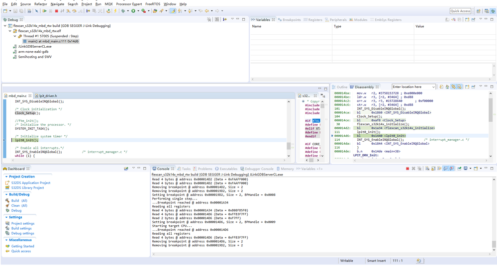

I started to debug the project.It seems to work,but I can't get the data.I'm not familiar with hardware,who can tell me what's wrong?

My mistake,there is no problem with the configuration.I forgot to give the STB pin of TJA1042 low level.You can also remove the peripheral configuration in the clock configuration file,it doesn't matter.
