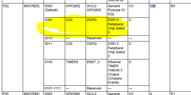

Hello All
I am using SPI0 for communication and I want to use Chipselect 6 (as in our hardware design).
But in MBD Toolbox the CS is limited to 0-3 where.
How shall I manage/overcome the limitation of the toolbox?
Help is appreciated.

constantinrazva
Hello abhishek.kumar@chassisbrakes.com‌,
You are right - this is a limitation that we'll fix. I'll post a patch for it by the end of the week, so you won't need any workarounds; it will work like the others CS work now.

constantinrazva
I have updated our library so we have all CS present. Can you please confirm everything is working on your end? I have provided here a self extracting zip (like we do for our community patches), so all you have to do is select the root directory of our toolbox - you should be then asked if you want to overwrite some files. If this happens, then the patch is working and the path you inserted is correct. I would recommend you to save  a copy of mbd_mpc574x_ec_toolbox as backup (the old version of our library) - you can just rename it as mbd_mpc574x_ec_toolbox_old.
Now the CS pins should be dynamically updated (CS0-7 should be present for your part in the Pins tab).

abhishek_kumar1
Dear  constantinrazvan.chivu
The update is good for configuration block, but for the transfer block we only can select til CS_3. (see snapshot)
So it does not solve the problem as of yet.
Maybe a small oversight.

abhishek_kumar1
It works. We tested it, thanks for the support
