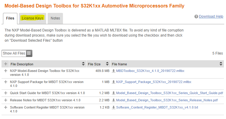

1. How do we purchase license for Mathworks libraries for motor control?
You can register, download and get a license from this location:
https://www.nxp.com/webapp/swlicensing/sso/downloadSoftware.sp?catid=MCTB-EX

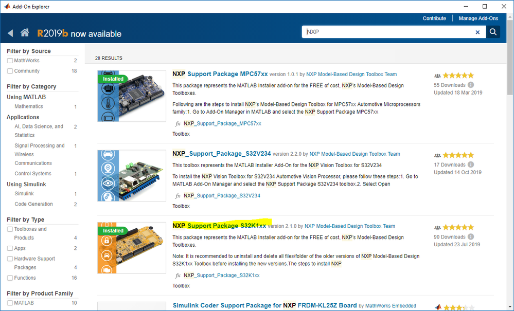

2.  How do we purchase NXP’s Model-Based Design Toolbox for S32K1xx version 2018.R1?
You can install the MBDT toolbox as a regular Add-Ons directly in Matlab and you will be guided through all the process, including getting a license.
You can also download the mltbx from the following location:
