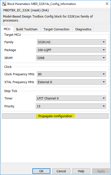

The Config block must be added in all the referenced models. Besides the .tlc file, there are other changes that the Config block performs on the model.
If you need to change something in the Config Block, just change in the main model and just press the "Propagate configuration" button. It will automatically apply the changes to all Config Blocks from the referenced models.

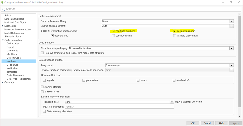

When I double click on "Propagate Configuration" as you mentioned above, it also changes some of the model configuration parameters. For example, it changes support for non-finite numbers and complex numbers, among other things. This is reproducible everytime.
Is there a way to avoid this?
Also, with Model References, it is recommended to use Configuration References. "Propagate Configuration" doesn't work in that case.
