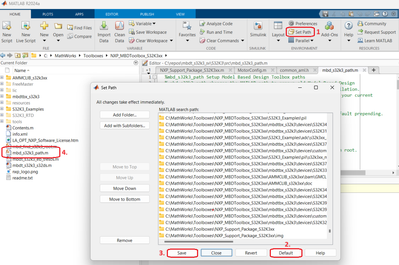

Can you provide screenshots for the MATLAB:
  1. Add-Ons
  2. Set Path

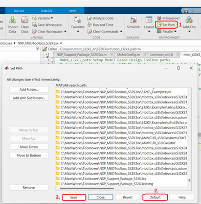

For next steps to work i recommend you start fresh,
  • Uninstall all previous Toolboxes from MATLAB Manage Add-Ons, then delete the local folders+files, if any remain in:
C:\Users\MAHMADI\AppData\Roaming\MathWorks\MATLAB Add-Ons\Toolboxes\NXP_MBDToolbox_S32K3xx or
C:\MATLABAddOns\Toolboxes\NXP_MBDToolbox_S32K3xx\

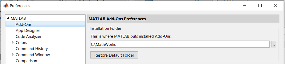

  • Go to MATLAB -> Preferences and set Add-Ons location to the following location:
This should be the default location.
  • Open MATLAB Set Path -> Default -> Save ->Close and then restart MATLAB:stefanvlad_1-1724354056397.pngstefanvlad_1-1724354056397.png
  • Install the latest MBDT V1.5.0 from NXP Model-Based Design Toolbox for S32K3xx version 1.5.0.

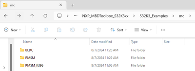

  • Delete the BLDC and PMSM folders, and copy the ones from the mc_v1.5.0_tppsdk_rtd_P19.zip
  • Enter the following path to the MATLAB Current Path C:\Matworks\Toolboxes\NXP_MBDToolbox_S32K3xx\S32K3_Examples\mc\PMSM\s32k344_mc_pmsm_2sh_ebt:stefanvlad_2-1724354275743.pngstefanvlad_2-1724354275743.png
  • Open the s32k344_mc_pmsm_2sh_ebt.mdl and build&deploy.
Please provide pictures and details on your side, when replicating the steps above.

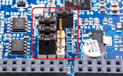

Thank you for the explanation and can i ask what is the exact error in the picture? the uploaded image quality is too small 400x239pixels.
First I recommend using the latest MBDT V1.5.0 from NXP Model-Based Design Toolbox for S32K3xx version 1.5.0 - Product Release Announcement - NXP Commun...
Secondly i will check the Jumper position on the DEVKIT-MOTORGD (GD3000) jumpers J9J10, and J11 are in positions 2-1 and J8 is open, this configuration works with all MBDT BLDC/PMSM models:
In the case of the PMSM models, if the Jumpers are not as in the configuration above, the USERLED_0 will be RED indication a fault.

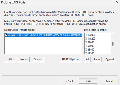

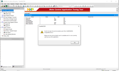

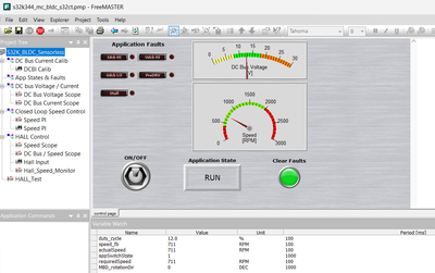

Then regarding the FreeMASTER connection to the board, you need to check your PC COM Port, for example:
In my case it is COM8 and then i need to set up the FreeMASTER communication:
Select the COM8 Port and speed 115200 as above, it should connect and work well with the board:
Let me know if this helps you,

Thanks for your response! We have confirmed all the items you mentioned. Basically we are seeing this error on two different eval boards we have ordered from digikey on two different laptops so it confirms something is not right! Is there a difference between the hardware you have with the ones on digikey? The one we have has a sticker with " SCH-53148 REVB". Do we need to DNP or populate something else on the board in addition to the jumpers configuration ?

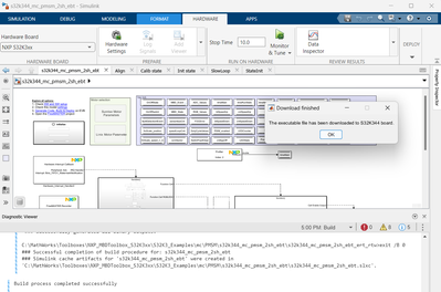

PS: there is a faster way to load the .elf on the S32K344 board, by using MATLAB Command Window:
>> mbd_s32k3.nxp.download.jtag('s32k344_mc_pmsm_2sh_ebt.elf','S32K344')
This will load the pre-generated binary into the S32K344 board, without the need to open the model.

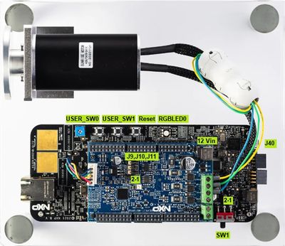

PS2: regarding "Second, every time we press the SW4, the LED D3 goes red indicating a fault I think." this is normal, because SW4 is the Reset button, and LED D3 is the Reset LED for the S32K344 board.
My advice is to press User_SW0 or User_SW1, see below picture:
  • Overview of the location of USER_SW0/SW1, RGBLED0, 12 Vin DC power, USB J40 connector, SW1 for powering ON, board jumpers J8, J9, J10, and J11:

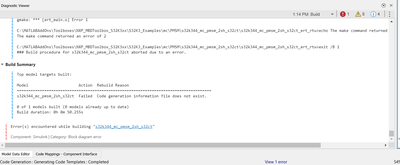

We replaced the mc folder with the files you sent and tried to build the .mdl files in the bldc and pmsm folders. First of all, the models no longer are built successfully and we get the following error for all of them:
"s32k344_mc_pmsm_2sh_s32ct       Failed Code generation information file does not exist"
Any thoughts why are getting this error now?

stefanvlad
Hi @Eduardo2000 ,
Can you include the complete log file, copy paste it in a log_error.txt file and attach it here.
Also there is no reason why s32ct.elf files don't work, as all files have been tested successfully working on the S32K344 board with the Sunrise and Linix motor spinning.
My guess is that you need to properly clean-up (delete all files) in the BLDC and PMSM folders, then add the files from the  mc_v1.5.0_tppsdk_rtd_P19.zip and the in the MATLAB File Explorer, go to C:\MATLABAddOns\ToolBoxes\NXP_MBDToolbox_S32K3xx\S32K3xx_Examples\mc\
And select BLDC, PMSM folders and right click and select Add to Path -> Selected Folders and Subfolders:
Then enter the path in MATLAB current window
  • C:\MATLABAddOns\ToolBoxes\NXP_MBDToolbox_S32K3xx\S32K3xx_Examples\mc\PMSM\s32k344_mc_pmsm_2sh_ebt\
This will result in seeing only the files from s32k344_mc_pmsm_2sh_ebt in the MATLAB Current Folder.
Now open the s32k344_mc_pmsm_2sh_ebt.mdl and after the model opens, press Build&Deploy(or CTRL+B keyboard shortcut).
This should build successfully,
Stefan V.

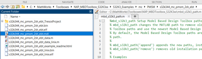

stefanvlad
Hi @Eduardo2000 ,
Looking into the log_error.txt file , i see two different paths for NXP_MBDToolbox_S32K3xx:
  1. C:\MATLABAddOns\Toolboxes\NXP_MBDToolbox_S32K3xx\S32K3_Examples\
  2. C:\Users\MAHMADI\AppData\Roaming\MathWorks\MATLAB Add-Ons\Toolboxes\NXP_MBDToolbox_S32K3xx\
This can be a problem, my advice is to remove previous Toolboxes installation from path no.2 then go into MATLAB:
  1. Click on -> Set Path
  2. Select Default
  3. Click Save, then Close
  4. Run the mbd_s32k3_path.m script
After running the mbd_s32k3_path.m script, it should give the Successful message:
After this you can restart MATLAB r2024a.

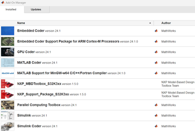

Can you also check the Add-Ons Manager, mine has the following installed:
Let me know what do you have installed.
After this go to the MC folder in MATLAB C:\MATLABAddOns\Toolboxes\NXP_MBDToolbox_S32K3xx\S32K3_Examples\mc\PMSM\s32k344_mc_pmsm_2sh_ebt:
Open the s32k344_mc_pmsm_2sh_ebt.mdl and build it, it should be successfully:
Stefan V.
