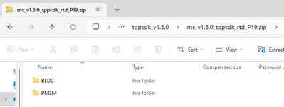

To fix this we have a new version for that GD3000 Driver, based on The new TPPSDK (GD3000 driver) based on RTD for S32K3 - NXP Community.

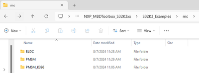

I have integrated this driver into the MBDT v1.5.0 release, to use it, you need first to delete all files inside the BLDC and PMSM folders:
Then unzip the attached mc_v1.5.0_tppsdk_rtd_P19.zip archive and paste it in the mc folder
After this you should be able to run the models with no issues, we have been tested this on multiple boards, in multiple regions, with success.

We replaced the mc folder with the files you sent and tried to build the .mdl files in the bldc and pmsm folders. First of all, the models no longer are built successfully and we get the following error for all of them:
"s32k344_mc_pmsm_2sh_s32ct       Failed Code generation information file does not exist"
Any thoughts why are getting this error now?
