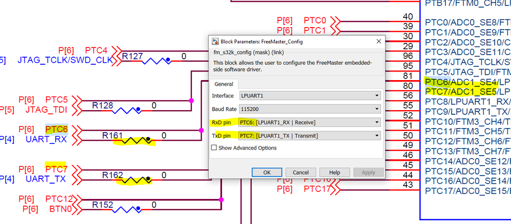

rathi_tg
Hello Sir,
I have Performed an ADC test on pin number PTB6 and PTB7 on NXP S32K144 Evaluation Board.
 After the test the PinPTB7 works fine and the voltage varies from  0 to 5 volt as required. But, when the same test was performed on  pin PTB6 the values of the Pin do not vary.
Please let me know the reason if you face the same and solution to avaoid the problem
Gopal Rathi.

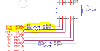

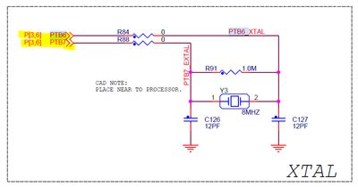

mariuslucianand
Hello @rathi_tg ,
On the S32K144EVB, the PTB6 and PTB7 are used as XTAL PINS, connected to an *Mhz oscillator.
The pins on the J3 connectors are not connected to the processor, you can see those resister R81 and R90.
Hope this helps,
Marius

rathi_tg
Hello Marius
I have mistaken with the pins.
 The Experiment was conducted on pins number PTC7 and PTC6 and abrupt Behavior was absorbed on PTC6.
I am sorry for the error
Gopal Rathi.
5,188 Views
mariuslucianand
Hello @rathi_tg ,
Unfortunately with the PTC6 and PTC7 is the same situation as above. Both pins are shared on the S32K144EVB with the UART serial connected to the OpenSDA. You can not use them in the same time both for ADC and UART communication, unless if you change the serial. But on this design, the pins are connected to the OpenSDA so this might be the reason why the PTC6 is kept low.
I strongly suggest to have a look on the schematics before starting using the board pins. The schematics and be found here. https://www.nxp.com/webapp/Download?colCode=S32K144EVB-SCH-29248-RB1
Hope this helps,
Marius
