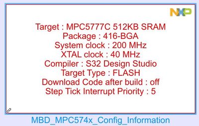

The MBDT for MPC57XX supports code generation for a couple of MCU families controllers. The error you are facing is because the toolbox must identify the target part for which the code is generated, to display the right options, and include the right files. This can be specified by inserting in your model the Config Information. This will change the System target file, (the one that the error refers to) with a proprietary one, but based on the Simulink's ert.tlc.

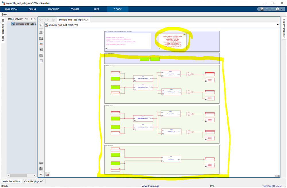

Let's use an example that already comes with our toolbox. I will choose the ammclib_mlib_add_mpc5777c.mdl file from our toolbox. You can see that the model already contains our config block, which has the MPC5777C controller selected. We will consider the yellow block as your desired algorithm that needs to be generated.

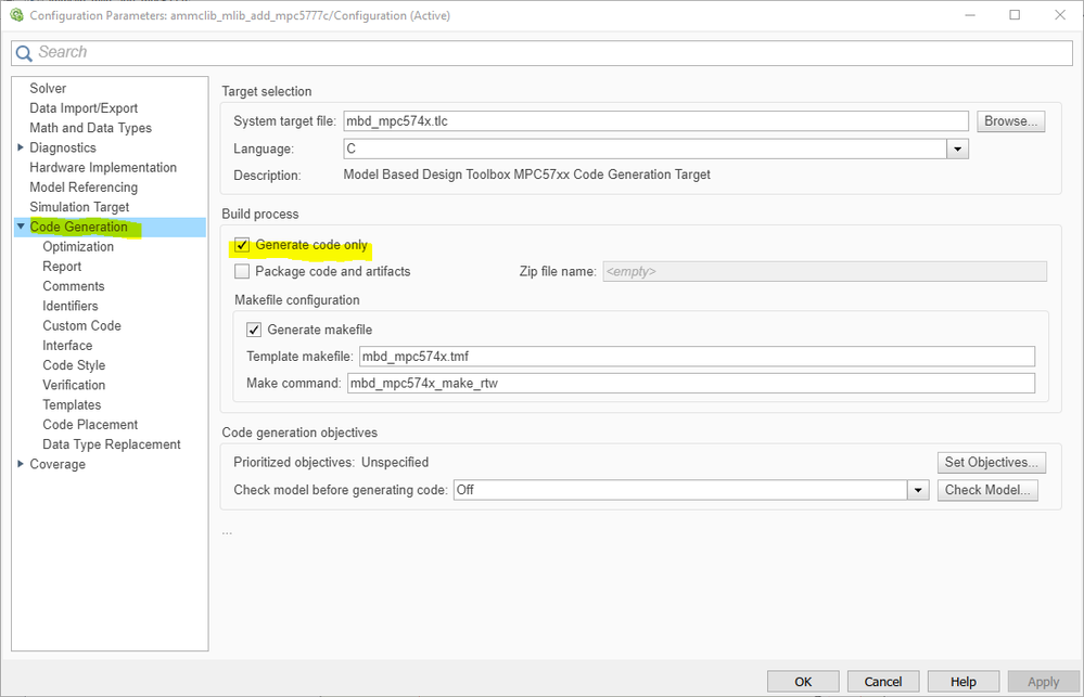

We only want to generate the code, and not compile and deploy the code to the target, so for that, you have to go to Model settings -> Code generation -> and check the Generate code only.

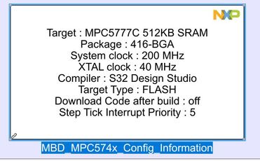

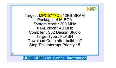

All the examples in my installed MBDT have the designation MPC574x. In the error description above you see that the function "mbd_mpc574x_make_rtw_hook" was searched. I opened the MPC574x-example file, renamed it for MPC5777C and changed in the config-block (which have MPC574X in its name too!) to MPC5777C.
Is this so correct? Or do i have the wrong MBDT after all? My MBDT has the description "MPC57xx". Is there a further location where i have to choose the MPC5777C, as in the config block?

Regarding the block name, it will generate code for the target selected inside the block. For this example, it uses the MPC5777C. Initially, the toolbox supported only the mpc574x parts but during the time we started adding more families. So, to try keeping the back compatibility we did not renamed our critical functions.
