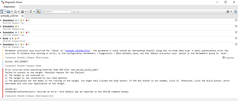

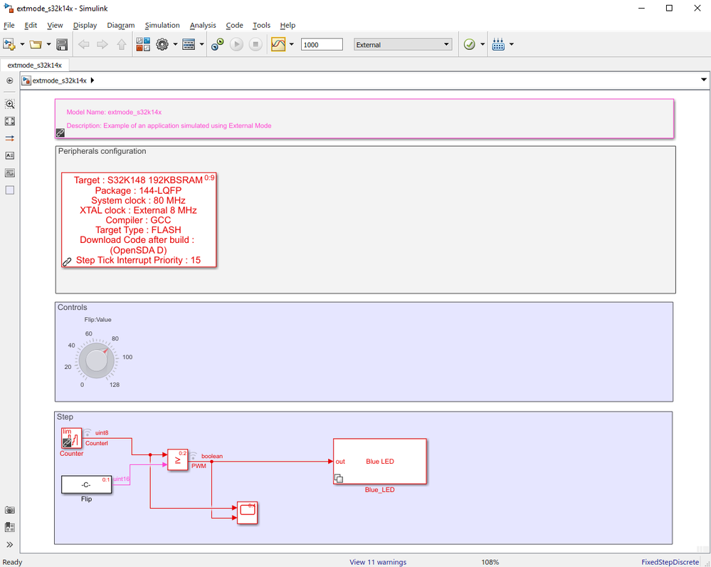

I am trying the run the Simulink example of External Model (see photo below) on the S32K148EVB.
I am able to build the model (see image below):
When I click "connect to the target" button, I usually receive that error (see image below):

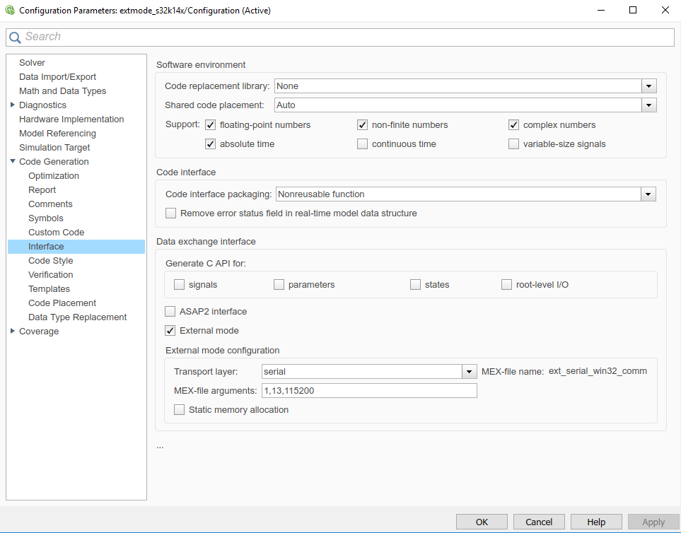

Kindly find below image of the model configurations:
Can someone help?

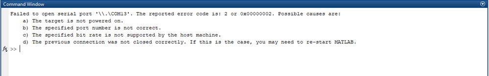

Someone in our team will look over this and reply you later on. A quick tip: can you try with a lower UART baud rate?
Also, are you absolutely sure the board is connected via COM Port 13 ? Just check in your Windows OS Device Manager on which COM Port the board is communicating with.

mfarag
Thanks dumitru-daniel.popa
Changed the COM port to the one specified by the Windows OS Device Manager and lowered the UART baud rate. It's working now
