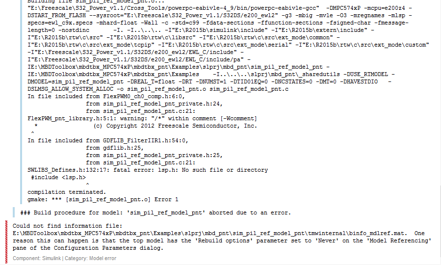

There 's a problem when running PIL with mpc5744p.Can you help me solve it?
Thanks a lot.

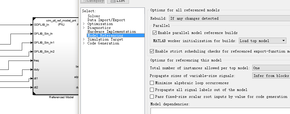

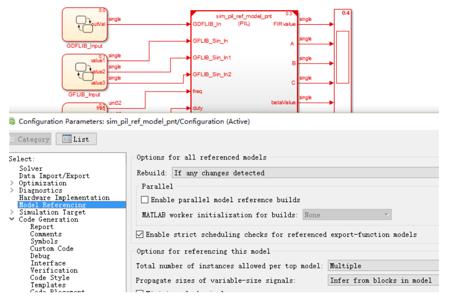

sivabalaji_rama
We also facing same problem (Could not find information file: D:\LocalData\CPU_measure\Matlab_PIL\slprj\mbd_pnt\Model_16\tmwinternal\binfo_mdlref.mat.  One reason this can happen is that the top model has the 'Rebuild options' parameter set to 'Never' on the 'Model Referencing' pane of the Configuration Parameters dialog.)
I have followed the above suggestions still the issue is not resolved. Could you please help me in solving dumitru-daniel.popa and paulvlase

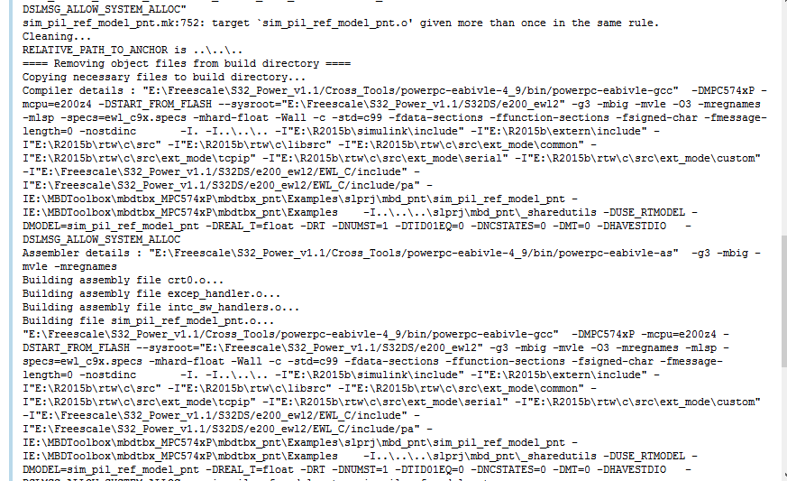

hjhjhj
Hi Daniel,
    There's still something wrong with the PIL simulation .Can you help me solve it ?

paulvlase
Hi hjhjhj,
Can you attach the model or the generated source folder? Or send me an email to [email protected]?

hjhjhj
Hi Paul,
  Check the attachment ,please.

Daniel_Popa
Hi hjhjhj‌,
As paulvlase‌ mentioned i would start by uninstalling the older v1.0.0 toolbox. It looks like for some unknown issue the new toolbox v2.0.0 is trying to use the the AMMCLIB files from the the older toolbox and that creates issues.
Have you tried that ?

paulvlase
7,628 Views
paulvlase
In the attached error message I see that you have both versions of MPC574xP toolbox installed, the MCToolbox for MPC574xP 1.x.x and MBDToolbox for MPC574xP 2.x.x. Please remove the old one (MCToolbox for MPC574xP 1.x.x) from the Matlab path using pathtool .
