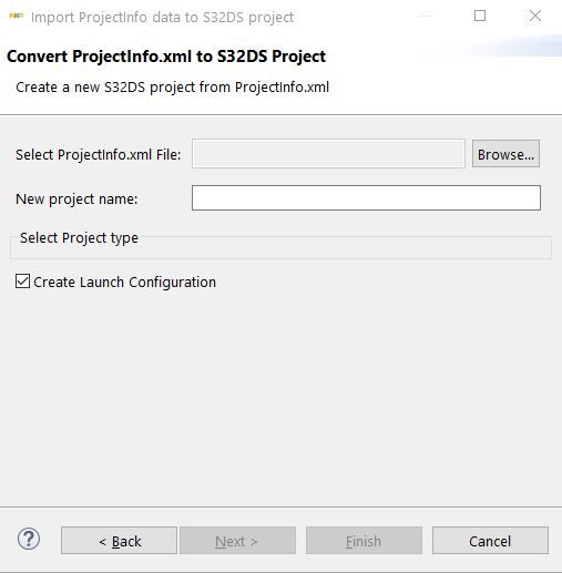

Hello eautopower‌,

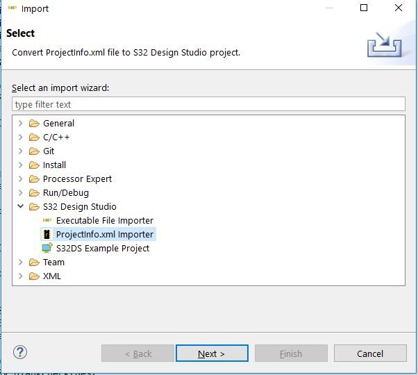

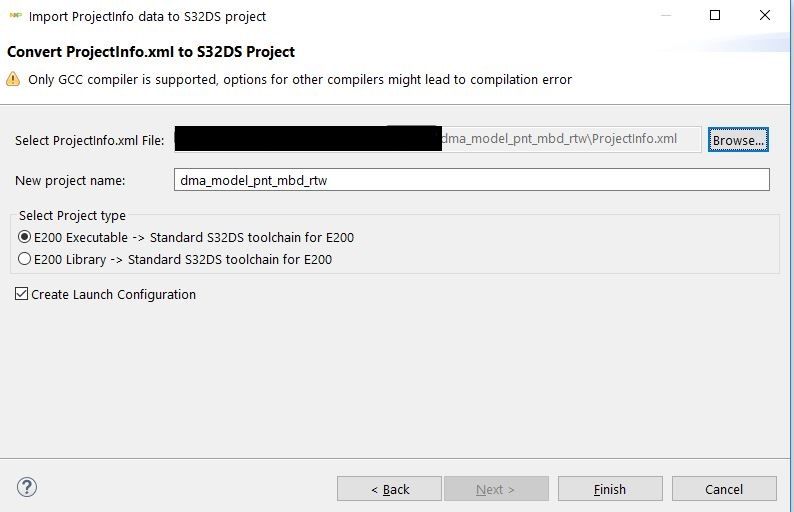

In order to import your MPC5744P project into S32 Design Studio you must first build your model. A file named ProjectInfo.xml will be generated into <model_name>_rtw folder.
Now for the Design Studio part you'll have to do the following:
Import -> ProjectInfo.xml Importer -> Next -> Browse -> Select ProjectInfo.xml file generated at build -> Open -> Finish
I've imported the dma example in the pictures below:
Let us know if you encounter any other problems.
Hope this helps,
Razvan

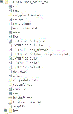

eautopower
hello:
 thanks for you  reply,I use the  MATLAB API of eclipseide,and I can't find the projectinfo.xml file:
Could you tell me  the eclipseid API use process ?

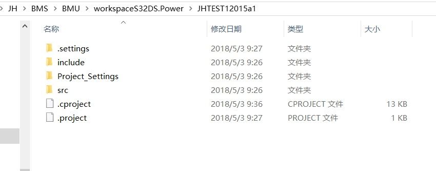

eautopower
hello:

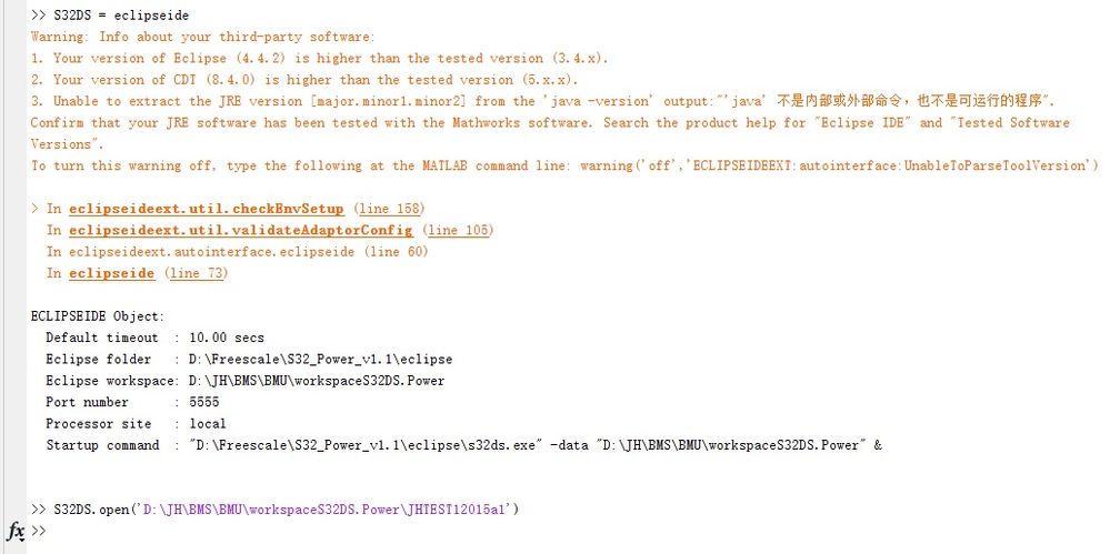

 I mean when I use the eclipseide API open the 'JHTEST12015a1'  project:
and there is a difference from the project I manually imported:

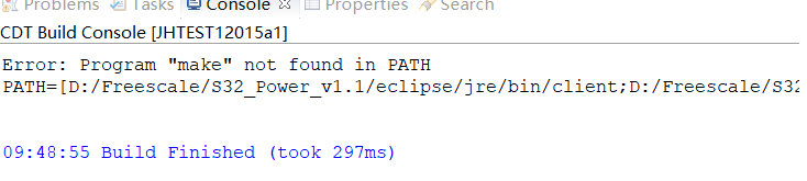

the 'JHTEST12015a1' Project can't be built:

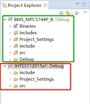

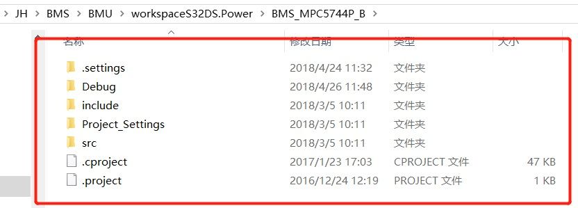

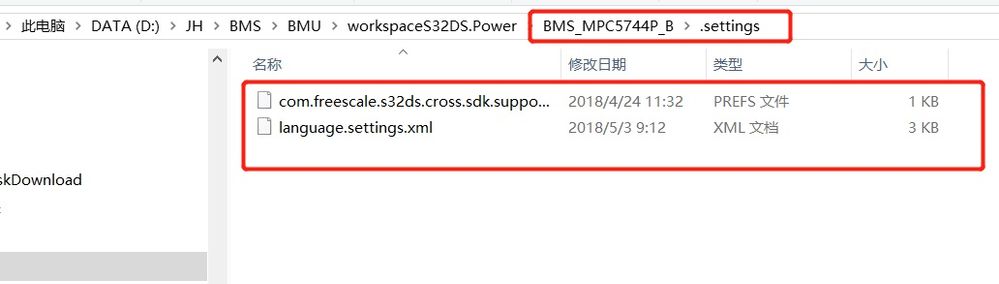

Comparison of two projects:

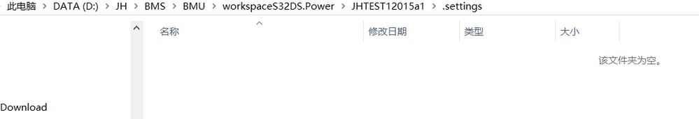

the 'JHTEST12015a1\.setting' is nothing:
How does use API function to import the project to be compiled as well as the manual import project?
