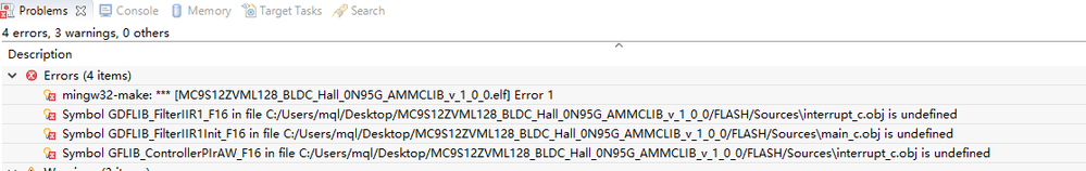

why my codewarrior 10.7 make elf file error ?

Hi meng qingli,
I general there is a matching between the version of the AMMCLIB and the version of the CW MCU. This should be visible in the release notes/readme files.
If you do not match the versions it might be possible to run into issues due to configurations/include paths into CW MCU.
