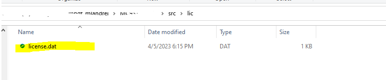

mcmackin
Marius,
Thank you for your feedback. Using the winopen(fullfile(mbd_find_s12z_root, 'lic')) command i was able to confirm my license was in the correct spot. It had a .lic file type, i changed it to be .dat and now get this error. I also tried restarting matlab, same error.
3,104 Views
mariuslucianand
Hello @mcmackin,
I am sorry that did not work! I think it will be a good idea to try regenerating the license.
First, you have to go to the S12ZVM License information and Return the current license.
Now, please go and generate it again, You need to specify the Host ID of your Local Disk. To find the Host ID, please open the Windows command prompt (cmd.exe) and type the "vol" command. Now, this will return a code from 8 digits. I have replaced mine with XXXX-XXXX.
Please let me know if this helped.
