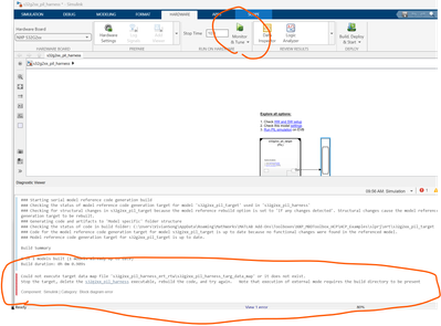

I have some issue to run the “HCP_examples/s32g2/pil/simple/s32g2_pil_hardness.mdl” with the MBDTToolbox_HCP.
I was told by NXP field Application engineer that “we have consulted with internal team and they have stated the MBDT 1.2.0 G2X release will work with G3, and it has been used with RDB3 board”
Here is my step-by-step procedure to try to download and deploy the simple pil_hardness.mdl on to my s32g3 gold box RDB3.

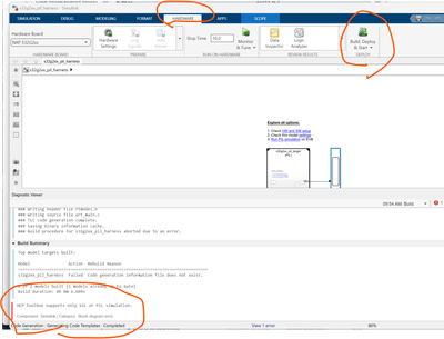

3. If I run the simulation from similation->run, or modeling->run, it compiled with output in scope.  (I guess the SIL is running ok)
4. If I use Hardware->Build, Deploy & Start, it shows “0 of 2 models built (1 models already up to date)”, Apparently, SIL model is built, but PIL is not.  So the deployment is not happening.

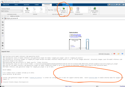

5. I tried hardware->monitor & tune->connect, it failed and ask me to enable the interface as “external mode”
6. Again, even I enable the “external mode”, I didn’t see the compile go through.vsong_5-1695063632331.png

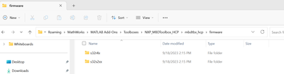

By looking at the add-on toolbox, I didn’t even find s32G2 firmware under my add-on.  Could that be an issue?
What will be the critical firmware link, I need to add/update to make my simple example works?
