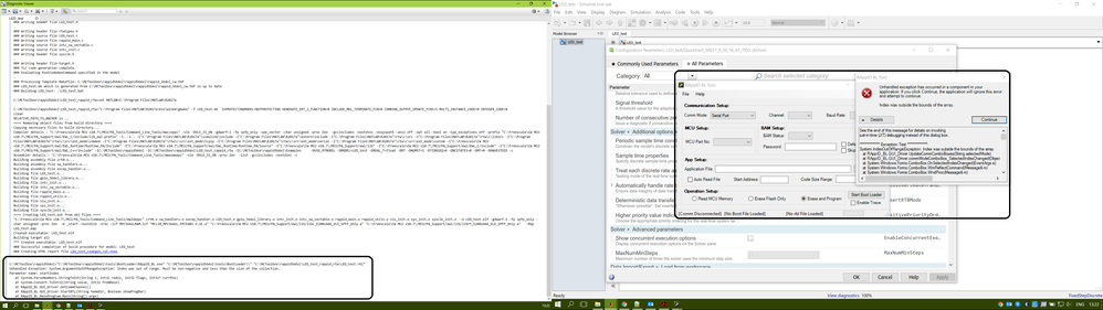

I used simulink + embedded coder to generate code for MPC5643L using the MotorControl Toolbox available from NXP. Now the code generation was successful. But after this I am unable to proceed further to program the micro controller with this generated code. Attaching an image of the error. The RAppID BL tool does not work as intended.
It is also important to note that I DO NOT know how to use the RAppID and I could not also find a step by step tutorial on how to use it. Any help in this direction will be useful.
SUmmary - I would like to understand how to use the RAppID BL and Simulink to program the microcontroller. I also tried to open the RAppID BL as a standalone application and get this error (attached) and cannot proceed further. At this moment, I am trying to use the serial communication port.

The err log lines include,
"can_simple_block.c", line 58: warning (etoa:1643): narrowing or signed-to-unsigned type conversion found: unsigned int to unsigned char
"can_simple_block.c", line 115: warning (etoa:1606): conditional expression or part of it is always true/false
"can_simple_block.c", line 116: warning (etoa:1522): statement not reached
"can_simple_block.c", line 153: warning (etoa:1606): conditional expression or part of it is always true/false
"can_simple_block.c", line 154: warning (etoa:1522): statement not reached
"can_simple_block.c", fatal error (etoa:1635): License error: Unknown LMAPI error
So I see it's a license error. But I have downloaded the evaluation. I think I will contact WindRiver first to help me with this. If the problem still persists, then I will write back to you. For now, I see the problem. But thank you for helping me get to this issue :smileyhappy:

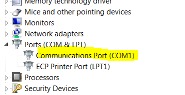

Thanks to paulvlase‌
The error is cause due to missing COM port. Please make sure you at least one COM port enabled in the Device Manager/Ports (COM&LPT)
Hope this helps!

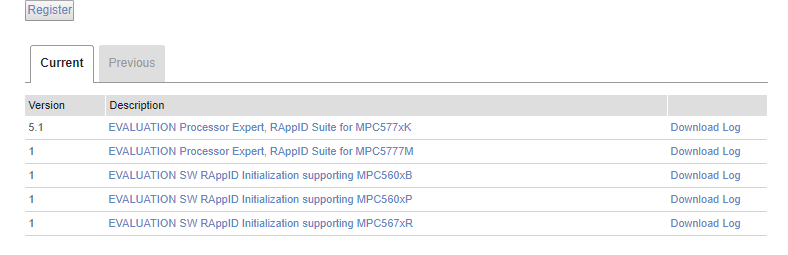

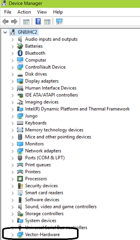

Could you please help me understand better? I basically have vector CANcaseXL connected to my computer and it is setup correctly (image attached below)
rappidBL_Error1.pngrappidBL_downloadpage.png.
There are two problems I face at this moment.

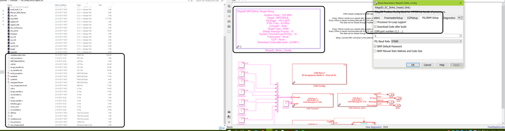

1. But when I use simulink to generate code, the generation is successful BUT after this the RappID application does not open. Nothing happens after the code is generated. Ideally I expect the generated code to be compiled (I have DIAB compiler installed) and then the RappID BL application to open and program the microcontroller. This is the first problem.
2. Now as an alternative I am trying to open RappID BL application.exe (standalone) and then trying to program (first even testing the connection does not work) the microcontroller with some test applications. I am not sure what the problem is and that's what is troubling me. So both ways (standalone as well as integrated with simulink) I am stuck without much progress.
Also the RappID BL application does consist of newer software for the MPC564xL series of controllers (image attached just above).
Thank you for your support. :smileyhappy:
15,985 Views
Daniel_Popa
Hi raghurajappa‌,

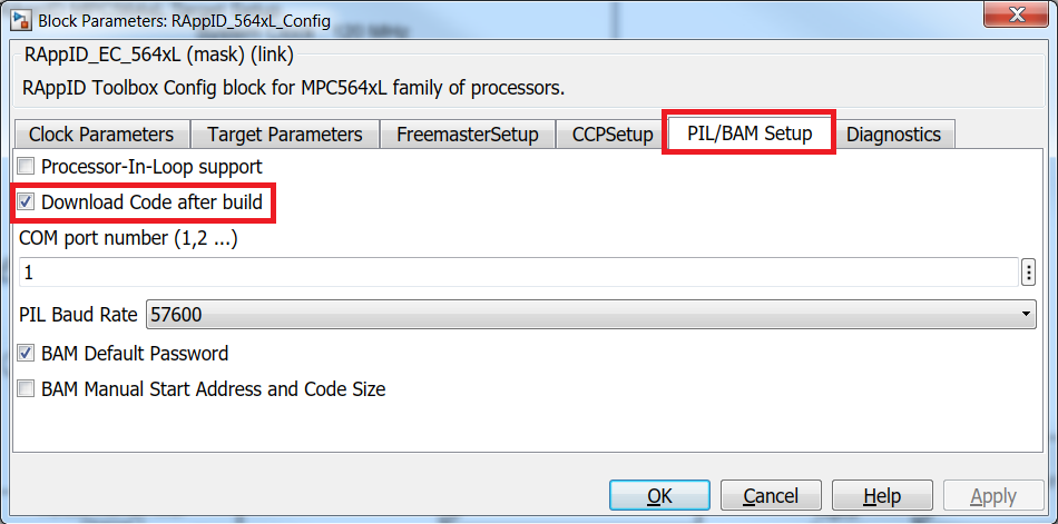

Please select "Download Code After Build" option in the PIL/BAM Setup within the "RAppID_564xL_Config" This works only if you connect the MCU with the Host PC via UART. Application download via CAN is not supported in the Simulink.
Have you set the board correctly ? Please have a look here: where to look for MPC564xL.rbf file ?
Then, please refer to chapter 2.9 Enabling Vector Hardware from RAppIDBL_UserManual.pdf. Some additional information here: https://community.nxp.com/message/898475
Hope this helps!

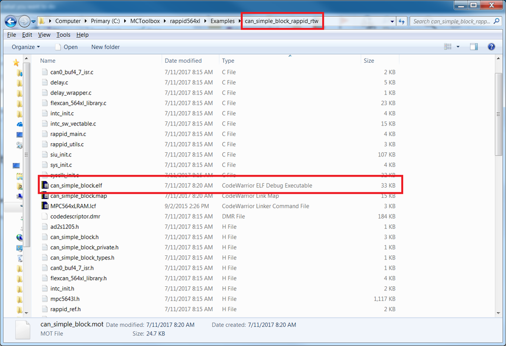

I would like to use Simulink on one PC to generate code (and HEX file) and another PC somewhere else to flash this hex file to the microcontroller. But from what you explain, it looks like Simulink will not generate hex file without the hardware connected. Is this true?
This use-case it is perfectly supported by the Simulink. You can have the MATLAB/Simulink + NXP Toolbox on one computer and generate all the C/H/makefile/elf/mot files into a folder called ***_rtw that is placed in the current MATLAB path.
Inside this folder you can find all the generated files.
 In my folder structures also I could not locate any hex files that I could use separately in my IDE. I did this as an alternative where I can use Simulink to generate hex files, then take these hex files into the CodeWarrior IDE (or FreeMaster) and use JTAG to program these. But I could not find the hex files.
By default the toolbox is configured to generate the *.elf and *.mot files
ELF is the standard DWARF format file that can be used in any IDE. You can use this file to load the application in the MCU with the available Debugger (that is DWARF compliant) via JTAG.
The hex file is special format that could be generated (by default the toolbox generates the mot file format) via 2 different approaches:
#1: starting from ELF you could use jfrey‌ suggestion as here: https://community.nxp.com/thread/452609#comment-910812
#2: you could modify the toolbox makefiles to generate hex instead of mot as per paulvlase‌ suggestion: https://community.nxp.com/thread/452609#comment-912694

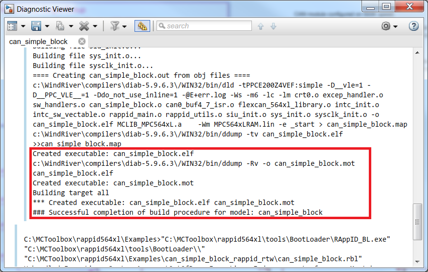

raghurajappa
Hi Daniel,
I tried it with the exact same example. Attaching the screenshot. I cannot find .elf/.mot files in there. rappidBL_error2.png
Everything else is the same. I have not configured FreemasterSetup or CCPSetup in the "Block Parameters" tab. But I find the generated code and everything else in there :smileyhappy:
15,985 Views
Daniel_Popa
Hi raghurajappa‌,

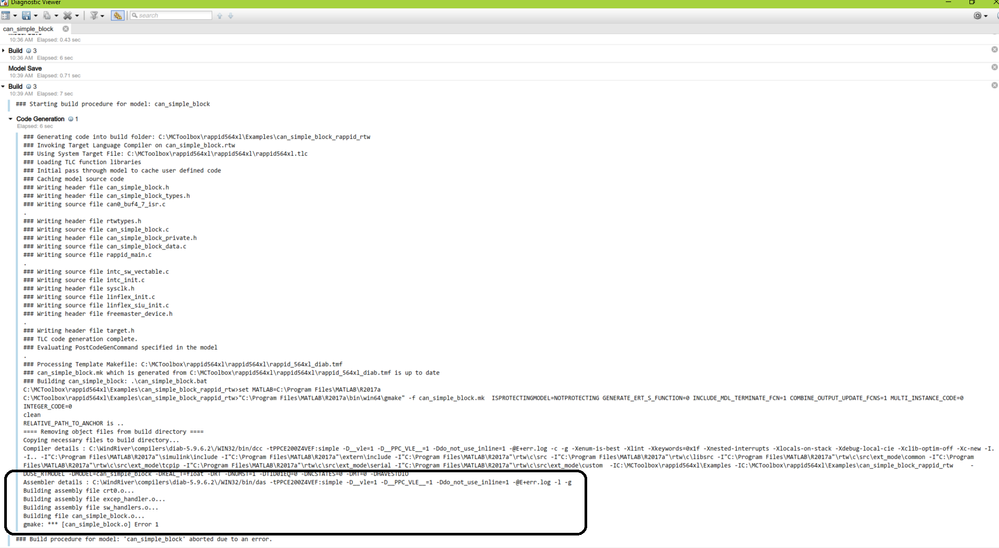

Have you configured the DIAB compiler ?
Here is my folder with the same setting as yours. Please find it attached.
Also, can you share your build log file, eventually as txt file ?
Here is how mine looks like:

raghurajappa
I was about you send you this information :smileyhappy: and you asked for it. It looks like the compile/link error exists but I could not figure out what the problem is. Does it have to do with the VLE enable option? If yes, how do I switch it off?? diagnostic_view_error.png
15,982 Views
Daniel_Popa
Hi raghurajappa‌,
Supposing you have not changed the mdl example (here's mine for reference with 2017a) the only other difference i see is the DIAB compiler version (i'm using the 5.9.6.3)
If the error still persists and you can't upgrate to a newer version of DIAB perhaps you could give a try to CW for MCU 10.7

Daniel_Popa
We can't really fix the error. We use only the binary of RAppID_BL.exe
The only way to avoid that error is to have at least one valid communication port - and that will make the RAppID behaves normally (without complaining about CommCombo)

Daniel_Popa
Hi raghurajappa‌,
Please note I have not yet connected the hardware to the UART
Please make sure you have at least one COM Port enabled and available on your PC. You should connect it to the board and power on the board. After that you'll have the RAppID BL running ok.

paulvlase
Hi raghurajappa‌
For Diab all compile errors are redirect to err.log file. You can find there the actual error.
Can you attach this file? It is in the rtw folder with the generated files.
