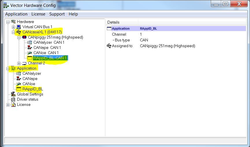

I am interested in developing target boards using Motor Control Toolbox.
Basic my environment
MCU: MC9S12ZVMC128
Target Board: Self-developed board
External communication port: CAN only. (Serial port not created.)
My CAN device: Vector VN7600
Question
I have confirmed that there are three options to support RAppID BL Tool's Comm Mode setting (Serial port, Vector CANCaseXL, Vector CANCardXLE).
Can not connect to Vector VN7600 .?

Daniel_Popa
Hi eungsoo Lee,
Regarding #1, i see you have done all the configurations correctly. I think is safe to say that RAppID BL is not currently supporting the device you are using and that is the main reason for the failure your are seeing.
You might want to add a service request to ask for a new feature to add support for other Vector Devices like yours here: Sales and Support|NXP at Support Requests
Is is a hazard to add a serial port on your board ? or to get another CAN device that is officially supported by our application ?

eungsoolee
Thank you for your answer.
But I have not been able to connect to my board yet.
please Check the my RAppID BL Tool window
(CAN Test SW downloaded with Jtag works well...ㅠㅠ)
Comm mode : Vector CANCardXLE
Channel : CH2 (CH1 of VN7600 is assigned to FlexRay.)
Raud Rate : 500k
When I run the Start Boot Loader button to display the following message.(ㅜㅜ...)
Question
1. when you connect using VN1610, Is Comm Mode set to Vector CANCardXLE?
2. Is there any other way I can verify that CAN communication is connected?

Daniel_Popa
Hi eungsoo Lee,
Regarding your questions:
ANS: CANCardXLE option is used for Vector boards that are connected over the PCI with the Host PC.
For Vector devices that are connected via USB you should use the "CaseXL" option.
ANS: One simple way - is to create a small program that broadcast a CAN message from the processor. This way you will validate that the CAN msgs will go out.
Now, coming back your error:
It looks like you have not configured the setup correctly because the RAppID is not able to connect with the Vector Devices.
In the RAppIDBL_UserManual.pdf there is a chapter called "Enabling Vector Hardware" where you need to open the Vector Hardware Config application and assign RAppID_BL to one of the CAN channels. Have you configured this step ?
To conclude, i would approach this problem as:
- step#1: build an application that will transmit a counter value over CAN all the time (infinite loop).
- step#2: then load this applicaiton via JTAG
- step#3: using any CAN device i would check that i can receive those messages and decode them correctly. This will ensure the CAN baud rate and CAN network is OK (perhaps you need to lower the CAN speed and/or add a 120ohm termination resistor)
- step4#: configure the RAppID Bootloader download the code via Serial (this will validate that your code will fit into S12ZVM flash.
- step5#: configure the RAppID Bootloader to use the Vector device and then download the code via CAN interface
Hope this helps!
