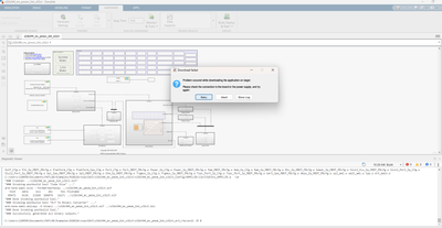

Problem when I try load my program in MDB
12,706 Views
JonAnder_Amante
I am using th example of "s32k344_mc_pmsm_2sh_s32ct" with model based design in simulinkin version 2022b. When I try to load to my Kit MCSPTE1AK344 I can´t load well and I don´t get any result. Moreover, I think the file .mex it´s wrong so someone can give a project with .mex?
Could you give some solution?
Thank you,

stefanvlad
Hi @JonAnder_Amante ,
Thank you for using MBDT for S32K3,
I do recommend you follow the Getting started with MCSPTE1AK344  | NXP Semiconductors
Have you connected USB cable to the board and PC?
3.5 Connect the Debugger Cable
Connect a micro-USB cable to the J40 connector to debug via the onboard S32K3 debugger.
If yes, than can you open Device Manager, to see if the PEMicro shows up as OpenSDA Debug Driver and OpenSDA CDC Serial Port:
if not, than you need to install the latest PEmicro drivers from PEmicro Hardware Interface Drivers, v.12 (7/8/10/11)
Stefan V.

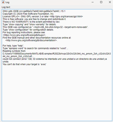

JonAnder_Amante
When I try to show the errors I have:

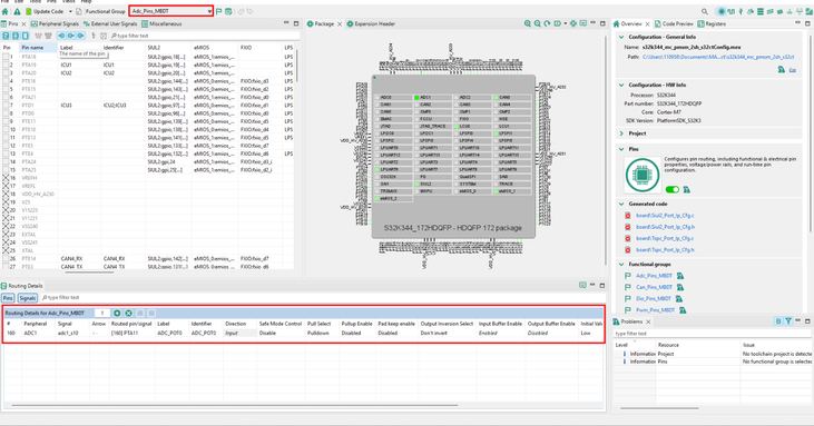

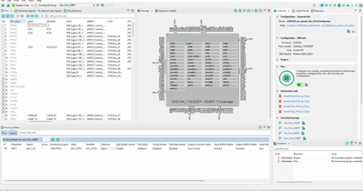

Sorry but I have a critical question. I am using Simulink with Model Based Design but I haven´t installed the application S32 Design studio. I have bought a kit MCSPTE1AK344 and I am trying to compile the example of project called "S32K344_mc_pmsm_2sh_s32ct". I compile well but when I open the configuration of pins, peripherals ... appear empty (in this picture you can see the configuration). I don´t know if you need to install S32 Design studio to see well the configuration. Moreover, the version of Matlab and Simulink and S32 Design Studio is important as I have 2022b version in Matlab in Simulink.
Thank you for all,
12,617 Views
dragostoma
Hi, @JonAnder_Amante,
Please consider the following aspects: S32 Design Studio is an IDE used for debugging, but its absence does not affect the proper functioning of the toolbox. S32 Configuration Tools is the utility through which you configure pins, clocks, peripherals, and all necessary settings required to build a model. It can be confusing because S32 Configuration Tools is also integrated into S32 Design Studio, which may lead to some misunderstanding. However, for the current situation, installing S32 Design Studio is not required.
Furthermore, what you see in the image is not empty. You have simply selected the Functional Group named Adc_Pins_MBDT from the dropdown menu in the top bar, which displays only the pins configured for the ADC peripheral. By clicking on the Functional Group section, you will be able to select the pins you need.
The image you presented is from the Pins tab, but by switching to the Peripherals tab, you can view the configuration settings for each individual peripheral. Similarly, you can switch between tabs depending on what you need to modify or inspect: Pins, Peripherals, or Clocks.
Hope this helps,
Dragos

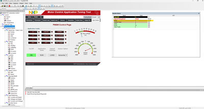

JonAnder_Amante

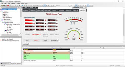

I have connected all connections well but I have the same problem so the led is always red. Moreover, if I look the interfaz of freemaster I have different problems in current Ia and current Ib.
12,525 Views
stefanvlad
Hi @JonAnder_Amante
The FreeMaster S32K_PMSM_Sensorless.pmpx file you opened is not from MBDT S32K3 Toolbox, it is from the Bare-metal C code from C:\NXP\MC_DevKits\MCSPTE1AK344\sw\MCSPTE1AK344_PMSM_FOC_2Sh_ll
Use MBDT S32K3 Toolbox project from S32K3\src\S32K3_Examples\mc\PMSM\s32k344_mc_pmsm_2sh_s32ct
  • open the model s32k344_mc_pmsm_2sh_s32ct.mdl and press CTRL+B to build and deploy
  • or you can flash the .elf file on the S32K344 board with Matlab command: >> mbd_s32k3.nxp.download.jtag('s32k344_mc_pmsm_2sh_s32ct.elf','S32K344')
  • open the corresponding FreeMaster file: s32k344_mc_pmsm_2sh_s32ct.pmpxstefanvlad_1-1760629608356.png

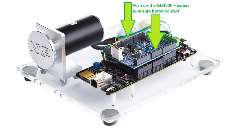

Second i have kindly asked you to press on the GD3000 Pin Headers to make better contact with S32K344-T172 board, as in the picture below:
Third , have you connected the 12V power supply on the GD3000 board, as below?
Can you send me a picture with your boards and setup?
Have you followed the steps above?

JonAnder_Amante
I have managed to get the engine to turn correctly but I have a qquestion. When I open freemaster there are some variables that have a interrogation and I don´t know why.
Thank you for all
12,079 Views
stefanvlad
Some variables appear with "?" since they haven't been implemented in the Simulink model, as the FreeMASTER project comes from the bare metal S32K3 Motor control SW examples.

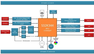

Today I load my project but suddenly the led switched off and the chip FS26 started to heat so I don´t know if I have done dead short.
11,907 Views
stefanvlad
Sorry to hear that, you can check voltages in the S32K344-T172 Schematic, there is also a block diagram:
You can order a new board from S32K3X4EVB-T172 Evaluation Board
or you can also order the new S32K312MINI-EVB Evaluation Board
Stefan V.

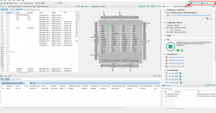

JonAnder_Amante
I have found the solution but I have another problem. I got debug my project but in the example which I told you, the configuration of S32 Config tool is empty as there aren´t any pin configured. The example is "S32K344_mc_pmsm_2sh_s32ct". I don´t know if you can help me. Thank you
12,638 Views

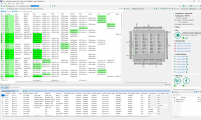

stefanvlad
In the screenshot you provided there is ADC_POT0 pin PTA11, there are more pins in Functional Group, by selecting other than Adc_Pins_MBDT.
Also press on Pin Name to sort it, and you will see all green highlighted pins that are used:
For more details we have a compressive guide here Interacting with Digital Inputs/Outputs on MR-CANHUBK344 - NXP Community
