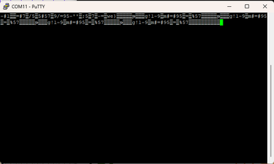

GUS979
Hello @dragostoma , thank you for your attent

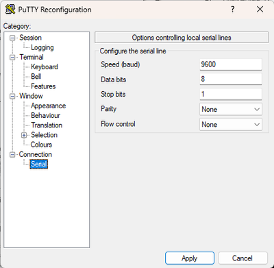

Your clarification was very helpful. However, when I try to run the "Uart DMA Transfer EBT" example following the recommended instructions, the code appears to work (the LEDs behave as expected), but there seems to be some error in the DMA communication between the computer and the board, as can be seen in the following figure. I've already reviewed all the Baud Rate, Putty, and DMA settings, but the terminal still doesn't print the expected message.

dragostoma
Hi, @GUS979,
I’m glad to hear that the information provided was helpful. I have downloaded your archive and deployed the generated .elf file, which worked correctly on the S32K312-Q172 board, as shown in the attached picture.
The issue you are encountering may be related to your hardware connection. Please ensure that the RX pin from the USB-to-Serial converter is connected to the TX pin on the board, and not RX to RX. This mismatch could be the cause of the problem you’re experiencing.
Dragos

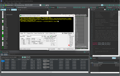

GUS979
Hello, @dragostoma,
I followed the recommended instructions, but when I reverse the RX and TX pins, there's no communication between the board and the computer. I've already checked the USB 2 serial cable. I've modified the output ports and switched to LPUART2, but although the code works, the response is still inconsistent, as can be seen in the image below. I'd appreciate any suggestions, as I'm at a loss as to what else to test.
