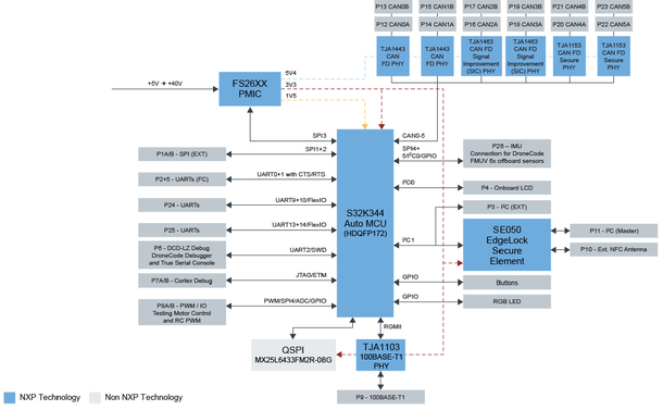

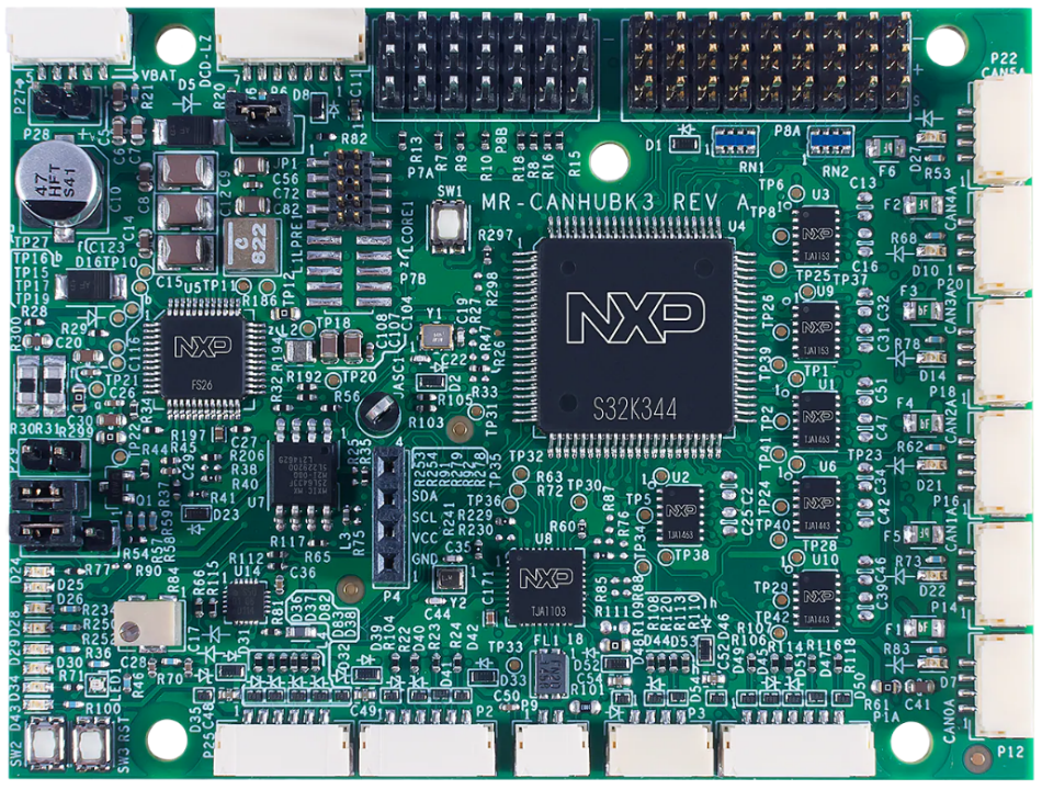

The MR-CANHUBK344 evaluation board provides a T1 ethernet interface alongside 6 CAN (Controller Area Network) interfaces, two for each of the three different types, CAN-FD (Flexible Data-Rate), CAN-SIC (Signal Improvement Capability) and CAN-SCT (Secure CAN Transceiver). The board is designed for mobile applications, and it is based on the NXP® S32K344, an Arm® Cortex®-M7 general-purpose automotive microcontroller, which features advanced safety, security and software support.
Below you can find the block diagram for the MR-CANHUBK344 board.
For more details about the MR-CANHUBK344 board, please follow the link:
https://www.nxp.com/design/development-boards/automotive-development-platforms/s32k-mcu-platforms/s3...

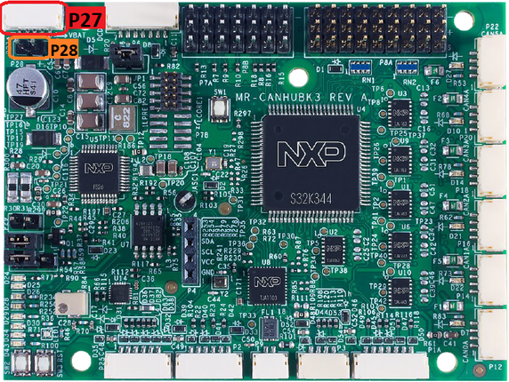

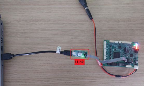

1.4. Powering up the MR-CANHUBK344

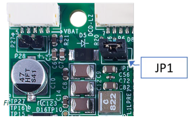

First, the CANHUBK344 board accepts a wide range of input voltages, from 5V to 40V, which can be delivered through 2 different ports.
  • P27 is the main power delivery port and it is used with a 5-pin JST-GH connector. This connector has 2 lines for power, 1 is not connected and the last 2 are ground lines.
  • P28 is an alternate way of powering up the board and it consists of a 2-pin header.
Regardless of the port chosen for powering up the board, precautions should be taken to make sure that the polarity is correct and that the pins align properly with the ports.
Note: By default, the FS26 PMIC (Power Management IC) implements a challenger window watchdog that will reset the board’s MCU continuously if the challenge is not handled in software. To avoid this behavior, the FS26 must be put into debug mode. This is done by removing the JP1 jumper, then supplying 12V to the board and then inserting the JP1 jumper again.
An example of how to connect both the power supply and the J-Link Debug probe will be discussed in the next chapter.
1.5. Connecting the J-Link Debug Probe
When connecting the J-Link Debug Probe, pay attention to the connector, to make sure that you are aligning the red stripe of the connector with the pin number 1 on both sides.
The associated J-Link software is not included in the Model-Based Design Toolbox and has to be installed separately. Installing the J-Link's software in the default location will allow it to work without having to select the location of the installation every time a new model is created.

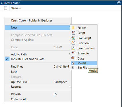

Create a new model:

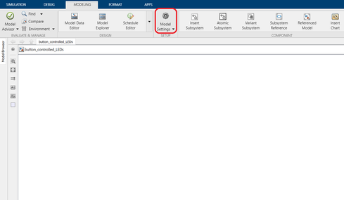

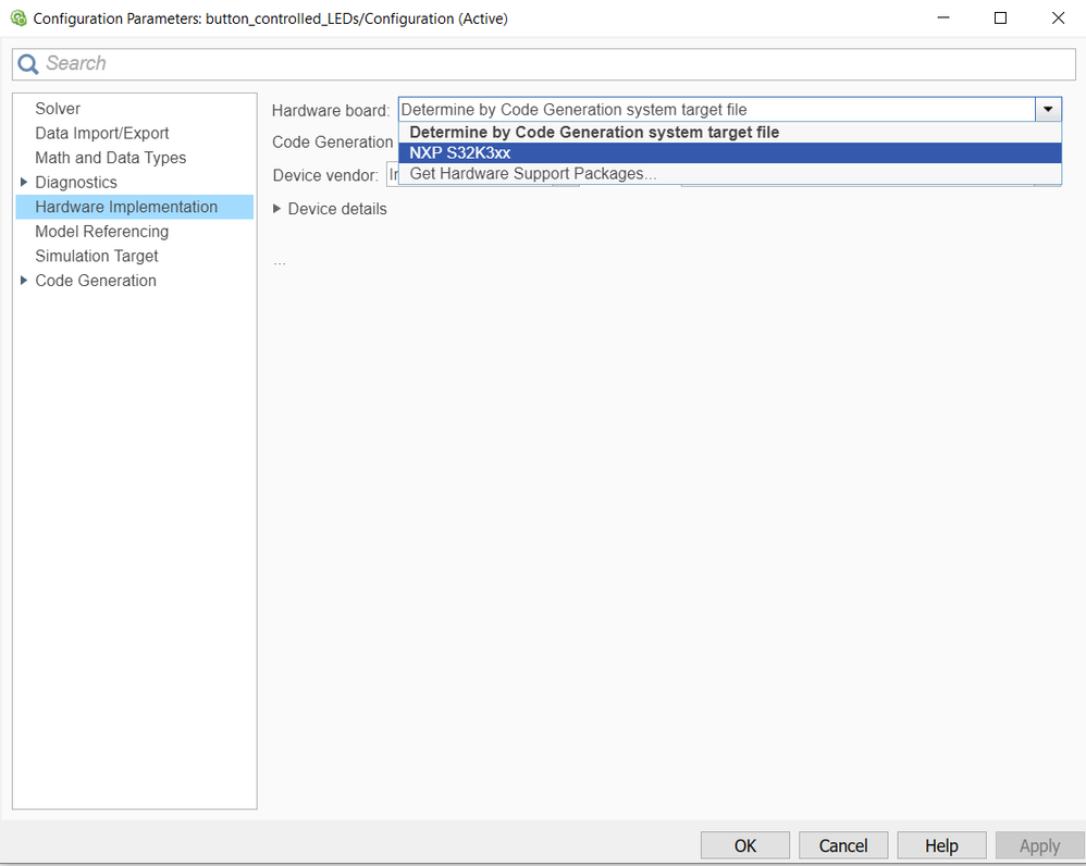

Next, open the newly created model and head to the MODELING tab. To configure the hardware, click on the Model Settings option. If you have a tough time finding the button, you can use the Ctrl+E shortcut to open the Model Settings window.
Moving forward, the correct Hardware board must be chosen from the Hardware Implementation tab. In this case, it is NXP S32K3xx.

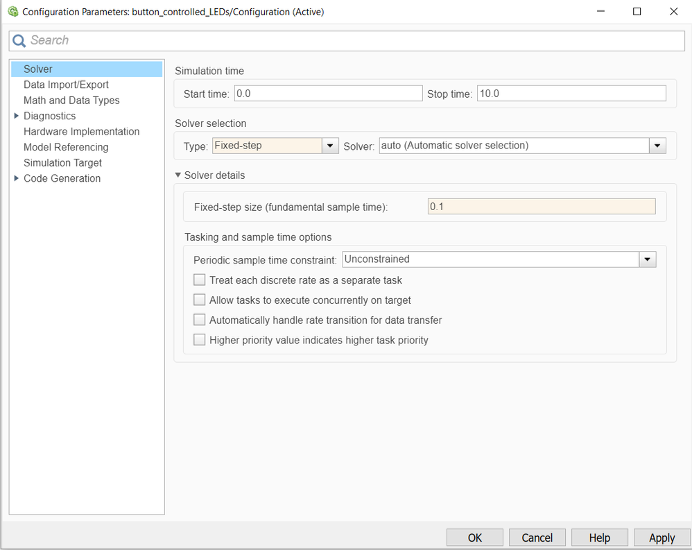

On the Solver tab, make sure to configure the Type to Fixed-step and set the Fixed-step size according to the needs of the application. This parameter controls how often the code in the model runs by setting the period time.
For example, a Step Size of 0.1s would make the code run 10 times in a second, once every 0.1 seconds. In the current project, this value ends up affecting the frequency of the LED that is being toggled by itself, so setting it to a very small value might make it hard to see that the LED is indeed blinking. Setting it to a higher value would make the buttons feel unresponsive because the code would check for button presses rarely. A good value for this example is 0.1s, because the toggling LED will be ON, and respectively OFF 5 times in a second, since it changes every 0.1 seconds. This way, the LED’s change is visible, and the buttons feel responsive because their interaction is checked every 0.1 seconds.

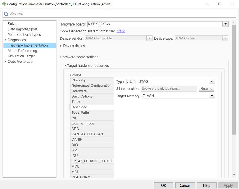

A few more options must be configured in Hardware Implementation. First, to access the submenu needed for the next changes, you have to click on the Target hardware resources option. From there, select Hardware and change the Hardware Part to S32K344-Q172. This will load the default configuration for the S32K344-Q172 hardware part. Later we will modify this configuration to work on the MR-CANHUBK344.
Afterwards, head to the Download tab, still under the Target hardware resources submenu. Make sure that the Type is set to J-Link – JTAG and that the Target Memory is set to FLASH. If your J-Link software has been installed in a location that is different from the default location, you have to select the path to the JLink.exe executable by pressing the Browse button next to the J-Link location label and selecting the executable from the location where it was installed.
The last step in the Target hardware resources submenu is to navigate to the Tools Paths and select S32 Config Tool in the Configuration Tool field. This setting changes the external configuration tool that will be used to configure the MCU’s pins, clocks and peripherals. This will allow the MCU to properly control all the components of the board. The Model-Based Design Toolbox for S32K3 uses integration with dedicated configuration tools to allow the configuration of the board's pins, clocks and peripherals, providing options for both Elektrobit Tresos (EB Tresos) and S32 Configuration Tools. More details on this configuration will be provided in the following sections.
After all the changes have been made, do not forget to click Apply and Ok.

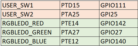

The next step is to take note of the pins used for the project you intend on creating. In this example, we will be using 2 LEDs and one of the 2 push buttons available on the board, which are part of the Dio component. By studying the schematic, we can obtain all the information we need about the pins used.
To be able to easily find a pin, search for its name and then look for the correspondence. In this example, by looking for the USER_SW1 pin, we can see that it is assigned to the PTD15 pin, also identified as GPIO111.

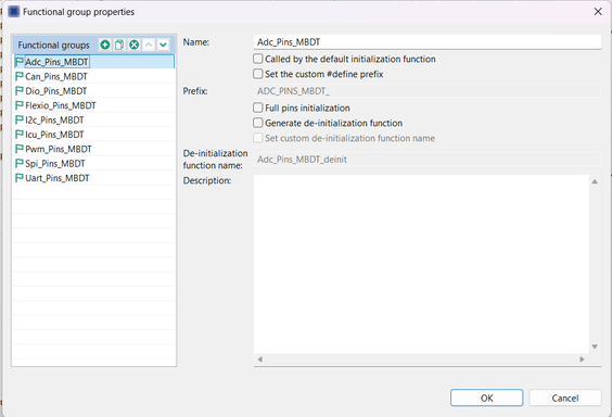

Before being able to see the configured pins, we must first select the pin’s functional group:
In the default configuration projects delivered by the Model-Based Design Toolbox, the pins are organized in Functional Groups based on the peripheral they are routed to, e.g. Adc_Pins_MBDT.
If there are no such groups already defined, you can create them by clicking on the icon highlighted by the arrow. This will open a menu from which you can create and delete functional groups.
For now, we will select the Dio_Pins_MBDT functional group, to configure the available DIO pins.

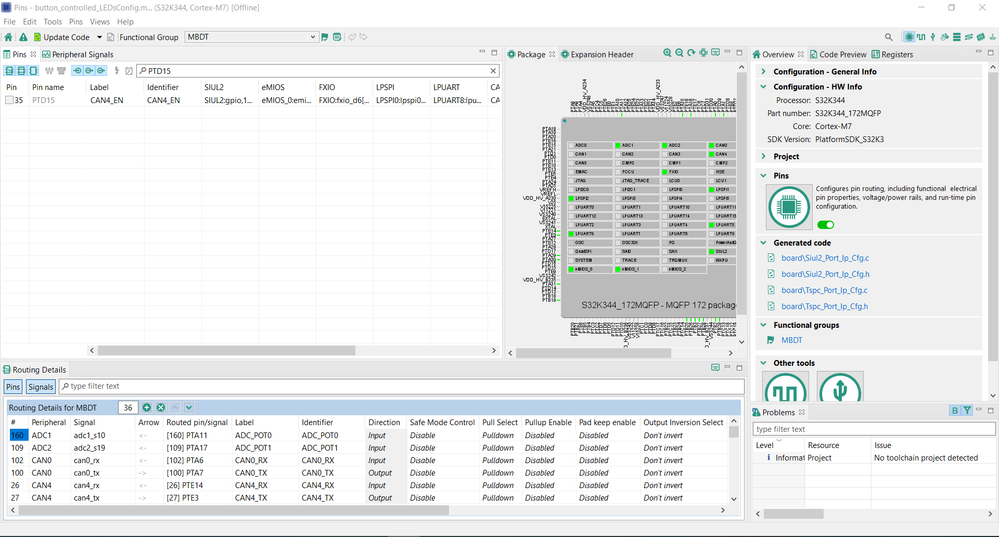

In this step, we will focus our attention on the top-left window, the Pins tab. First, we must check if there is any pin with the same name in the configuration. To do that for the button named USER_SW1 we can type its name value in the type filter text field.
Here we can see that a pin with the same name already exists, and it is configured on the pin PTB19. To avoid further configuration issues, we must disable this pin. We can do that by clicking on the green Checkbox from the left side of the row. Then, we deselect the already selected item and click done, making sure nothing else is selected.
To start the configuration process for the first pin, the button named USER_SW1, we can type its pin value in the type filter text field.

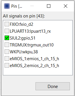

As we can see, the pin is not configured for our intended behavior. To change that, we must update the identifier, the label, and click on the checkbox on the left. By doing that, the following menu will pop up:
Here we will select the SIUL2:gpio,111 option since it matches our requirement. Afterwards, another window will pop up asking about the direction of the pin. In this case, we are configuring a button, so we only expect it to act as an Input.
This process of removing the old configuration and adding the new one has to be repeated for every pin that will need to be configured. Keep in mind that when configuring the LEDs, you will have to set the direction as Input/Output since one of the LEDs will be toggled from one state to another, which requires the LED to be read before the output can be inverted.
By taking a look at the bottom window, Routing Details, we can see more configuration options for the pins. You can use the type filter text field to limit the results to only the pins you are interested in seeing. The MR-CANHUBK344 board has its LED logic inverted, so, by default, the board's LEDs would turn on when powering the board. To avoid that, we assign an Initial Value to the LED. By setting the Blue LED's Initial Value to High, it is going to turn off as soon as the board starts.
Note: If you are using the Model-Based Design Toolbox for S32K3xx version 1.5.0, the pins’ configuration will require following these steps as well:
The configuration we are about to perform has to be identical to the configuration done in the Pins component.

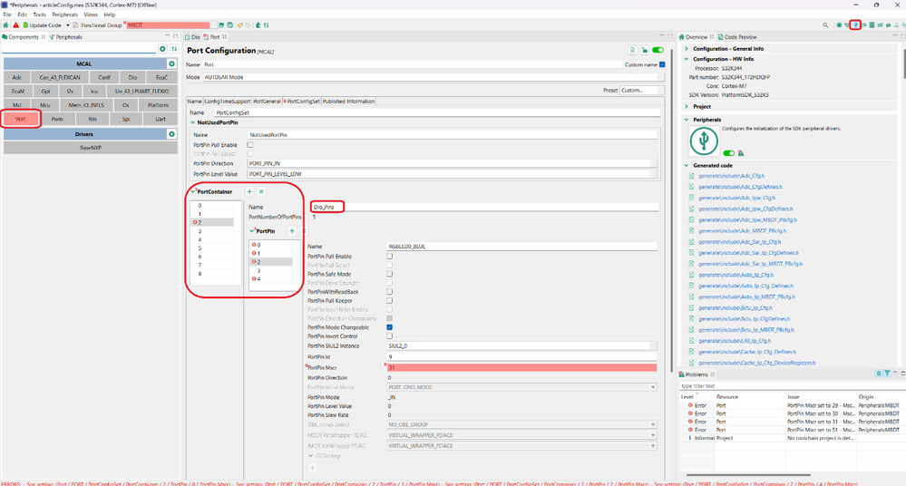

When we return to the Peripherals tool, the Port component will be highlighted in red due to inconsistencies in the pins configured. This is caused by the fact that we just updated the pins in the Pins tool, and now we have to update them in the Port component as well.
In the default configuration projects delivered by the Model-Based Design Toolbox, the PortPins are organized in PortContainers based on their respective peripheral, eg. Adc_Pins, Dio_Pins, Can_Pins, etc.
As we can see, when clicking on the Port component we are being shown which PortContainer has errors. In this case, it is the PortContainer identified by the number 2, which corresponds to Dio_Pins.
The best course of action here would be to start modifying the PortPin entries in such a way that they reflect the newly configured values in the Pins tool.
We can begin configuring the pins with the right PortPin Mscr and Name. The Mscr value can also be found in the schematic for the board. For this article, these values have been shown in the table from this chapter’s beginning. They are noted as “GPIO111” or “GPI25” where the numeric part represents the Mscr: 111 and 25. When filling in the PortPin Mscr, the other fields will retrieve their values from the Pins configuration.
Important note: The PortContainers in Port and the Functional Groups in Pins must respect the following naming convention: Pins’ Functional group = PortContainer Name + ‘_MBDT’. For example, the Pins’ Functional Group for the PortContainer called Dio_Pins is Dio_Pins_MBDT.
This process has to be repeated for each of the 5 added pins.
The PortPin Id is a unique indentifier for each item in the PortPin section. This identifier is also unique across all the PortContainers, so in case your PortPin Id is reporting an error about the value not being unique, it means that there’s another PortPin item with the same PortPin Id value.
This field can have values from 0 to the number of configured pins. For example, if your configuration has 40 pins, the PortPin Id can hold values between 0 and 40.
In this specific scenario, we are replacing 5 Dio pins with another set of 5 Dio pins, so as along as we keep the PortPin Id unchanged for each item, there should be no issues.

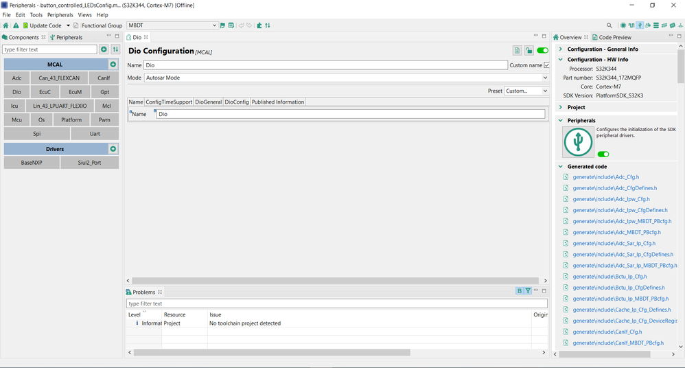

Head back to the Peripherals Tool by clicking on the Peripherals button.

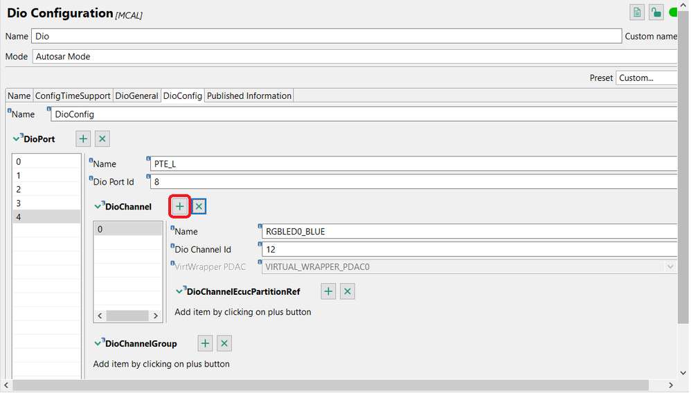

Finally, after configuring the pins’ directions, we have to configure the Dio component so that the pins can be used during the execution of the program. This will be done in the DioConfig tab under the Dio Configuration tab. If it is not showing by default, you can press on the Dio component on the left side of the screen and it should bring it up.
Understanding how the DioPort and DioChannel are organized might prove useful later. The number present under the DioPort label represents the corresponding value of the Dio port that you want to access. Below you can find a table with the correspondence between the values and the registers.
AL=0
AH=1
BL=2
BH=3
CL=4
CH=5
DL=6
DH=7
EL=8
EH=9

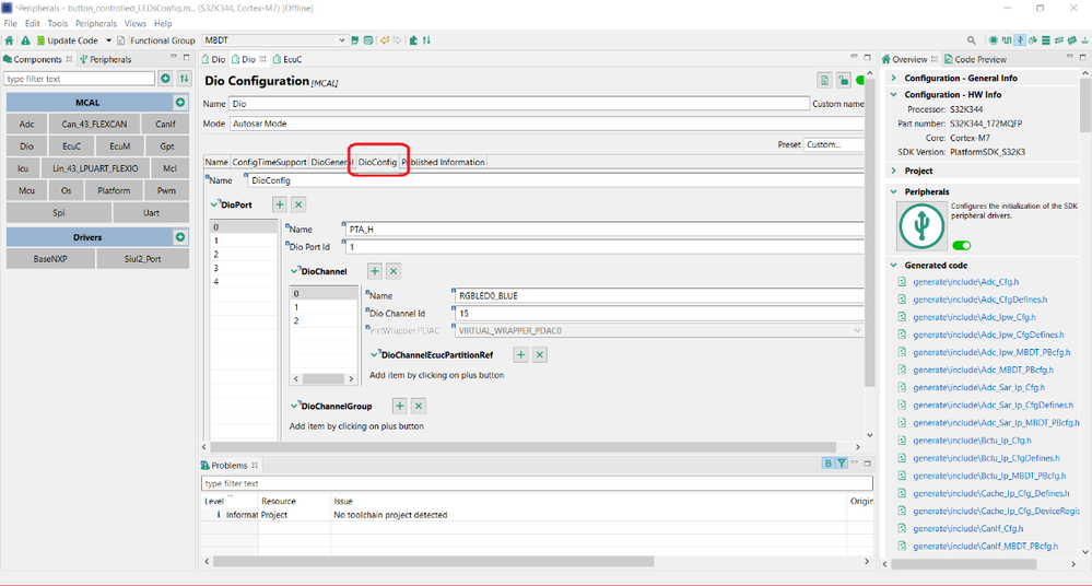

Each of those is half of a register and together every line forms a 32-bit register. For example, AL and AH contain all the pin values that are assigned to PTA. AL contains the first 16 pins and AH contains the next 16 pins.
For example, the RGBLED0_GREEN pin is assigned to PTA27. From that we can conclude that, since 27 is higher than 15 (the 16th value of AL, since the first value is 0), the PTA27 pin must be assigned to the AH register.
To reiterate, the PTA0-PTA15 pins belong to the AL register while the PTA16-PTA31 (the value must be offset by -16 when computing the Id) pins belong to the AH register, and this is true for the rest of the registers too, PTB, PTC, PTD, PTE.
Given that the previous configuration did not match our setup, we should first prepare the registers by removing the components that we have already disabled in the section 2.2.
For example, in the DioPort 0 we can see the old (disabled) LEDs, which can be removed by clicking the X button shown. This should be done for each DioPort Id to make sure there aren’t any incorrectly configured items. In the current case, we only have to remove the RGBLED0_BLUE, RGLED0_GREEN and USER_SW_1 items, which we will later replace with our own.
After removing the LEDs’ configuration from the previous ports, since now the LEDs are routed to different pins, we can start adding the pins that we have configured in the prior step. Figuring out where each pin should go relies on the explanations from the beginning of this chapter. As an example, adding the ping RGBLED0_BLUE, which corresponds to PTE12, means going to the DioPort 4 because the value 12 is found in the first interval, 0-15, which points us to the EL register.
To add a DioChannel, click on the + Button next to DioChannel. A new channel will be created and you have to fill in the details regarding the port.
This has to be done for every of the 3 configured pins, in their respective registers.

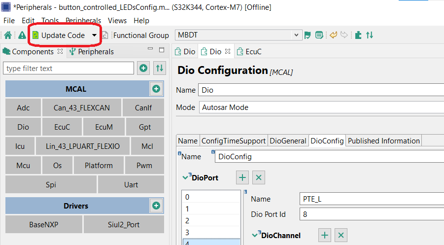

The last step is to save the configuration project and press the Update Code button. Afterwards, press Ok on the dialog window that popped up. Afterwards, feel free to close the configuration software.
To update the configuration in the Simulink model, press the Refresh button inside the menu that pops up when double-clicking a block.

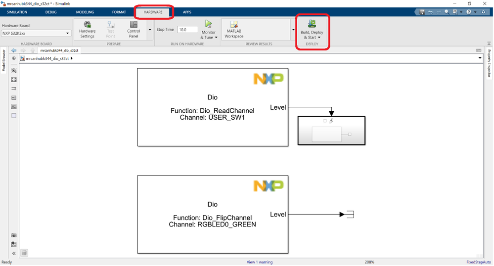

3. DIO Model Overview
This article’s goal is to explain the workflow of creating a model that toggles the LEDs based on the push buttons available on the board. The logic will be the following:
- The blue LED is toggled using the Push button 1;
- The green LED is automatically toggled every simulation step.

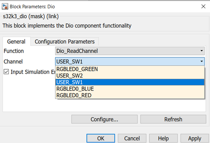

This means we will need blocks to read an input value, write an output value and flip an output value. These operations can be achieved using Dio blocks. A Dio block has multiple possible functions, which you can select from the Function dropdown. Once a new function is selected, the functionality and the block’s inputs and outputs will change accordingly.
The pin that is going to be the target of the function can be chosen by selecting it from the dropdown list of the Channel option. The items that appear in the dropdown list correspond to the Dio channels that have been configured in chapter 2.3.
The Input Simulation Enable option will not be used in this example, so it should be unchecked. Enabling this option will create an additional input for the block, which can be used to simulate the model’s behavior. For the functions Dio_ReadChannel, Dio_ReadChannelGroup and Dio_ReadPort, the block outputs the simulation input. For the Dio_FlipChannel function, the block will output the inverted simulation input

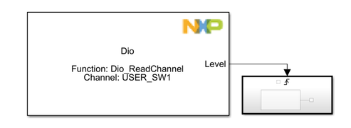

The way the Dio Block is currently configured, it will read the input value from the button USER_SW1 which we can later use to control the LEDs.

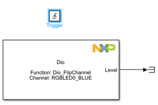

Since we want to toggle an LED when a button is pressed, it means we have to look for the rising edge of that input. To do that, a Trigger subsystem block will be used, that takes as input the value read from the button USER_SW1. The block’s Trigger type is configured to rising by clicking on the Trigger icon and when it detects that rising edge in its input, the subsystem will be executed. In this situation, we use the Dio block to invert the output of the LED.
The contents of the newly added Trigger subsystem are seen below:

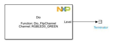

Automatically toggling the green LED is a much simpler task due to the function FlipChannel available in the Dio block. The FlipChannel Dio block also has an output, which outputs the current state of the LED. Since that information is not going to be used anywhere else, a Simulink Terminator can be attached to that output, to avoid having errors.
To upload and run the code on the MR-CANHUBK344 board, select the HARDWARE tab at the top of the window, and then click on the Build, Deploy & Start button. This will start the process of generating code from the Simulink model and uploading it to the board using the J-Link programmer.
Note: If the J-Link’s path was not configured in the earlier steps, a dialog box will pop up requiring the path to the executable. If the software was installed in the default location, pressing on the Default option will be enough.
Initially, after uploading the program or resetting the board, you will notice that the RGB LED is green and blinking. Keep in mind that the MR-CANHUBK344 board has its LED logic inverted, so writing a value of 1 to an LED output will turn it off, and writing a value of 0 to an LED output will turn it on. Pressing the SW1 toggles the blue LED, while the green one keeps blinking.

But i have an issue, if i interchange the rgb leds i am unable to see the change even after building it to the microprocessor
my question is apart from led configuration shoud we configure any other peripherals to interchange the action.
I have replicated this in the nxps32k312 please clarify!
