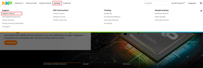

Furthermore, as you require support for multiple topics related on how to use NXP Software, we would kindly ask you if you could open a support ticket on nxp.com, from the Support Tickets tab.
I would also like to let you know that the majority of the MBDT Community answers are posted by our team of MBDT engineers, and we are providing this support on a best-effort basis, as we are mainly focused on the toolbox development tasks.
By submitting such a ticket, you could get support from teams specialized on such activities, on multiple topics that you are interested in, not only MBDT usage, which I think might help you and your team with the development activities associated to the project you are working on.
