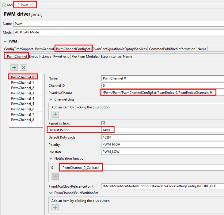

Requirement is like, want to generate two PWM signals and one PWM signal should start to generate other signal rising edge and stop at falling edge. To achieve this, Is any library or supported document available?

First of all, I apologize for the delayed response. You could find attached a possible solution for your application, which I will describe below:
1. PWM channel 0 configuration
- configured based on instance eMIOS 0 channel 9;
- has a default period set to 64000 ticks;
- based on the eMIOS instance, has assigned PwmEmiosChannels_9 configuration;
- flag generation is set to Both_Trailing_and_Leading_Edge, meaning that the Interrupt Callback Notification will be triggered at each edge (rising and falling edge);

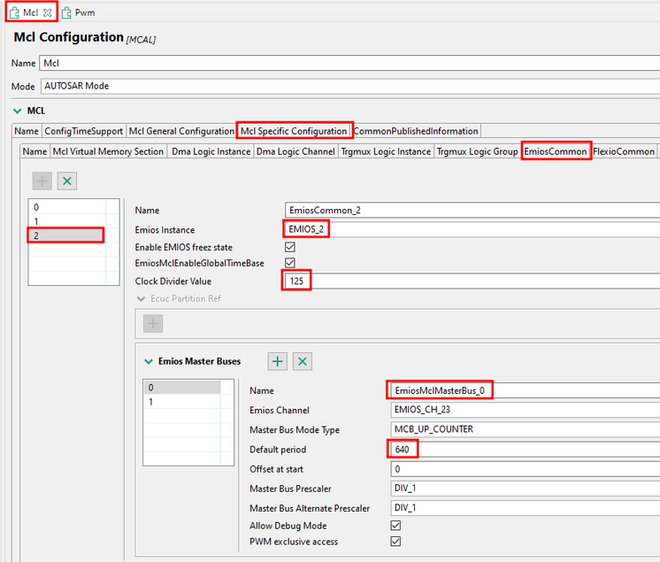

- configured based on EmiosCommon_0, which uses a clock divider value of 125;
- uses EmiosMclMasterBus_0 (EMIOS_CH_23), with a default period of 64000;

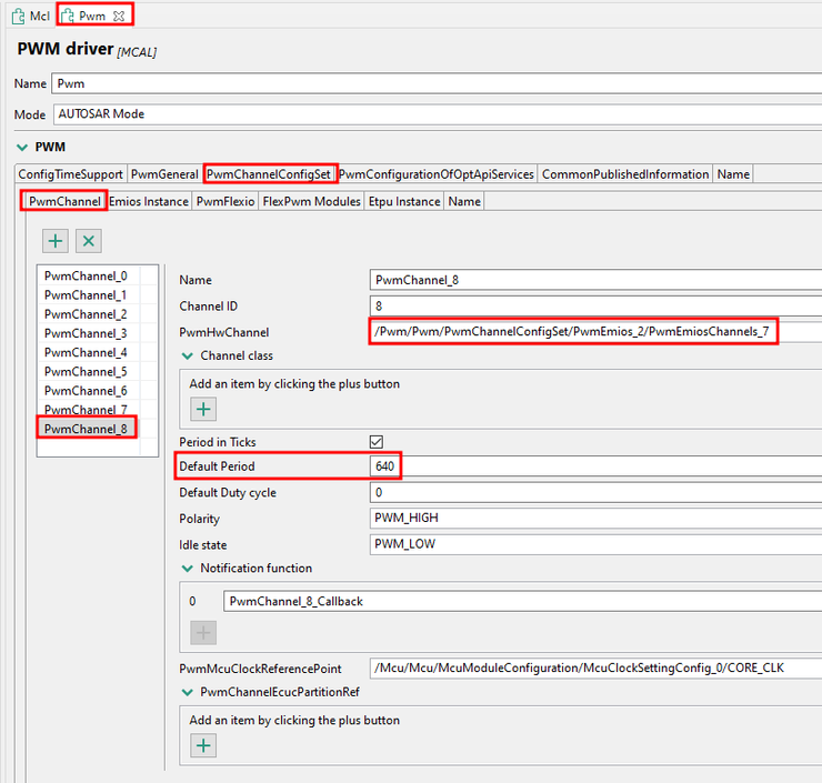

2. PWM channel 8 configuration
- configured based on instance eMIOS 2 channel 7;
- has a default period set to 640 ticks;
- based on the eMIOS instance, has assigned PwmEmiosChannels_7 configuration;
- configured based on EmiosCommon_2, which uses a clock divider value of 125;
- uses EmiosMclMasterBus_0 (EMIOS_CH_23), with a default period of 640;

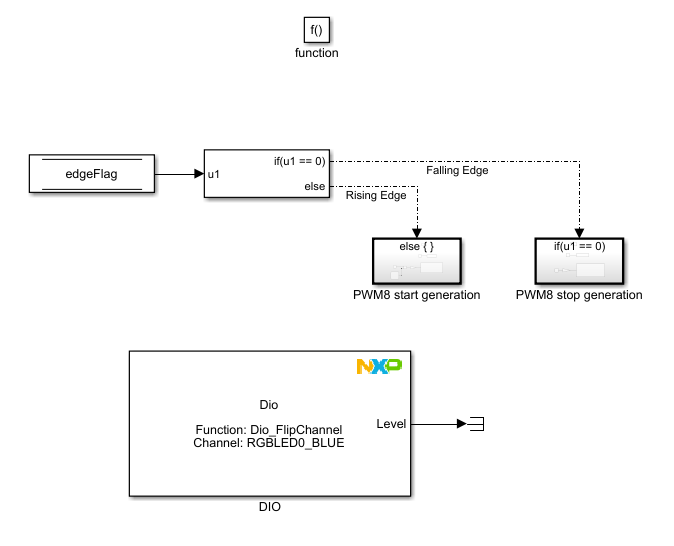

3. Simulink application
The Simulink application consists of:

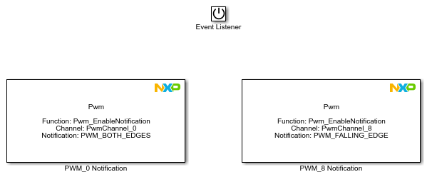

3.1. Initialize subsystem where the notifications are enabled for the PWM channels:
3.2. Main application:
- the PWM Channel 0 generates the signal based on the above configuration;
- the edgeFlag variable is initially set to 0, and its purpose is to detect the edge of the generated PWM;
3.3. Hardware Interrupt Callback:
- the RGBLED0_BLUE is toggling at each interrupt callback trigger, and its purpose is to follow the PWM signal;

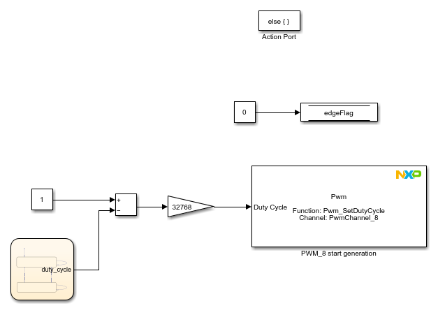

- when the edgeFlag is set to 1, a Rising Edge is detected on the PWM Channel 0, and the PWM Channel 8 starts to generate the signal based on the above configuration; the edgeFlag is set to 0;

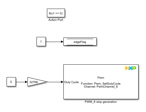

- when the edgeFlag is 0, a FallingEdge was detected on the PWM Channel 0 and the PWM Channel 8 stops the generation of the signal; the edgeFlag is set to 1;

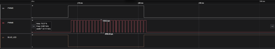

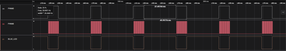

5. Results
Based on the above configuration, the PWM signals will be defined as follows:
6. Conclusion
The PWM Channel 0 will generate a PWM signal with a 20 Hz frequency. At each PWM Channel 0 edge change, the RGBLED0_BLUE is toggling, and based on a flag initially set to 0, the PWM edge that triggered the interrupt callback is determined. When a rising edge is detected, PWM Channel 8 starts to generate a PWM signal with a 2 kHz frequency. When a falling edge is detected, PWM Channel 8 stops to generate the PWM signal.
