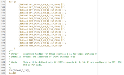

Hi all,
     Trying to create variable period and variable duty cycle in s32k3 using simulink (MBDT)
While config. PWM I have selected mode as OPWFMB.
Received some error can't rectify it...
Attached sample images for reference...
Can any one kindly suggest me some solutions... if possible share some examples and reference documents.

Hi @Kavin_raj_mbd
The error you are encountering states that the reference to the EMIOS0_3_IRQ can't be found during the linking process. The EMIOS0_3_IRQ represents the Interrupt handler for the channels 8-11 of Emios instance 0, and it is defined only if EMIOS channels 8, 9, 10 or 11 are configured inside the PWM, ICU, GPT or OCU components.
As I can see from the attached screenshot, you have two PWM channels configured for instance EMIOS0. The one in the image is CH_2, and you have also an additional one, which I don't think is one from the ones mentioned above (8-11).
Hence, if those channels (8-11) are not configured, you would need to disable from the Platform component the Interrupt associated to these channels, and set its ISR to undefined_handler. Please see the screenshot below.
Let us know if this solved the issue.

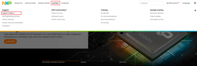

Furthermore, as you require support for multiple topics related on how to use NXP Software, we would kindly ask you if you could open a support ticket on nxp.com, from the Support Tickets tab.
I would also like to let you know that the majority of the MBDT Community answers are posted by our team of MBDT engineers, and we are providing this support on a best-effort basis, as we are mainly focused on the toolbox development tasks.
By submitting such a ticket, you could get support from teams specialized on such activities, on multiple topics that you are interested in, not only MBDT usage, which I think might help you and your team with the development activities associated to the project you are working on.
