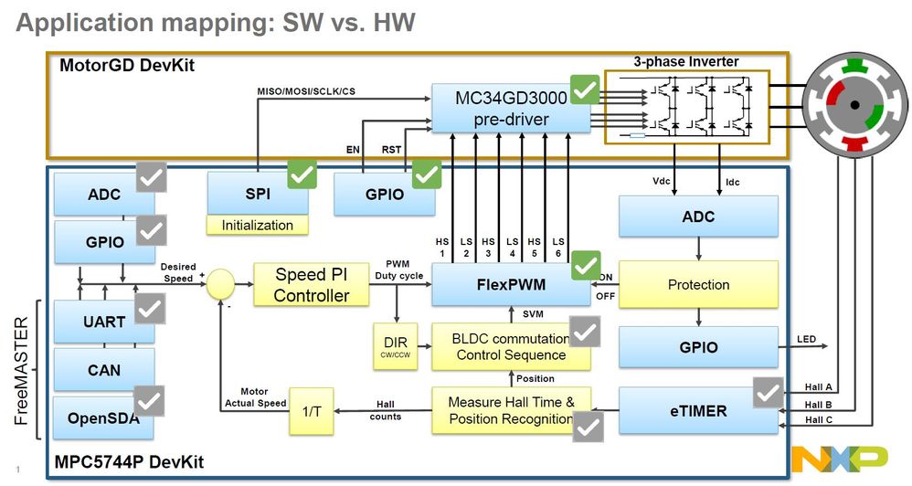

In this 8th lecture of the motor control course we discuss about power stage (DevKit MotorGD) configuration that involves the configuration and initialization of the MC34GD3000 FET pre-driver via SPI commands and the setup of the FlexPWM peripheral to generate PWM commands to the inverter MOSFETs.
Main topics:

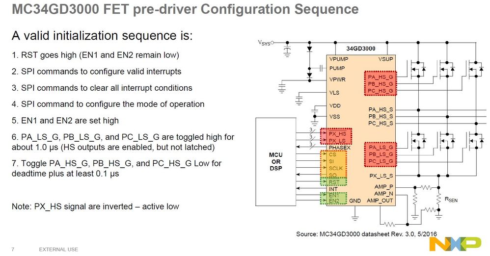

    - What is MC34GD3000 FET pre-driver and how it works;
    - FET pre-driver initialization sequece;

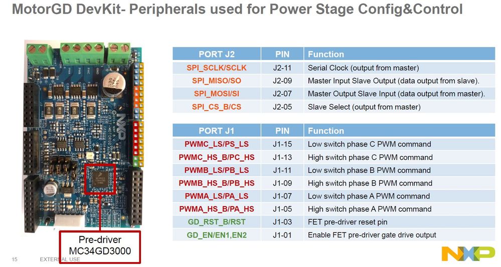

    - Power Stage Configuration and Control pins;
    - How to configure the FlexPWM to generate PWM commands and validate the hardware;
    - How to configure the SPI communication;
