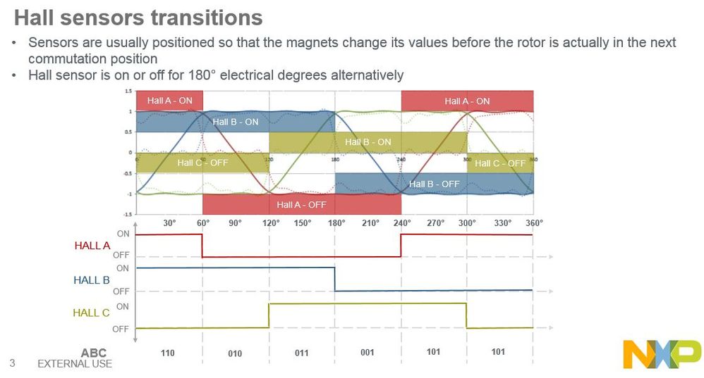

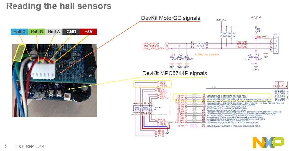

In this fifth lecture of the motor control course we discuss about how can we read the hall sensors to obtain the rotor position in order to know how to apply the correct voltage sequence to the motor phases.
Main topics:
    - How Hall sensors works;
    - How to define a commutation sector;
    - How to identify the hall sensors and hall sensors alignment;
    - How to build applications to read the hall sensors via GPIO and eTIMER Capture;
    - How to implement an enhancement to read the rotor initial position to allow the startup from any position;

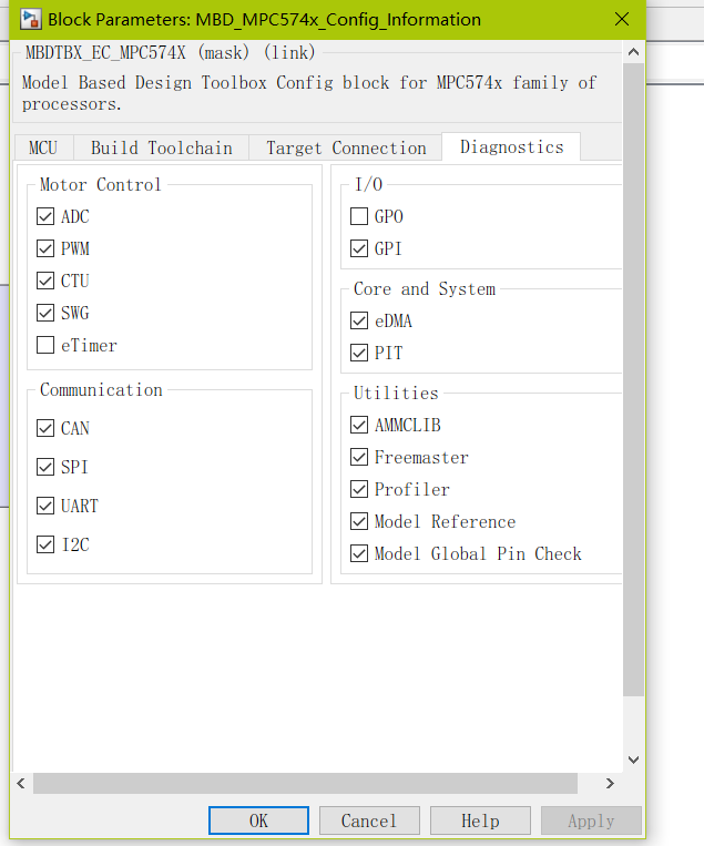

haoxue1027
Contributor V

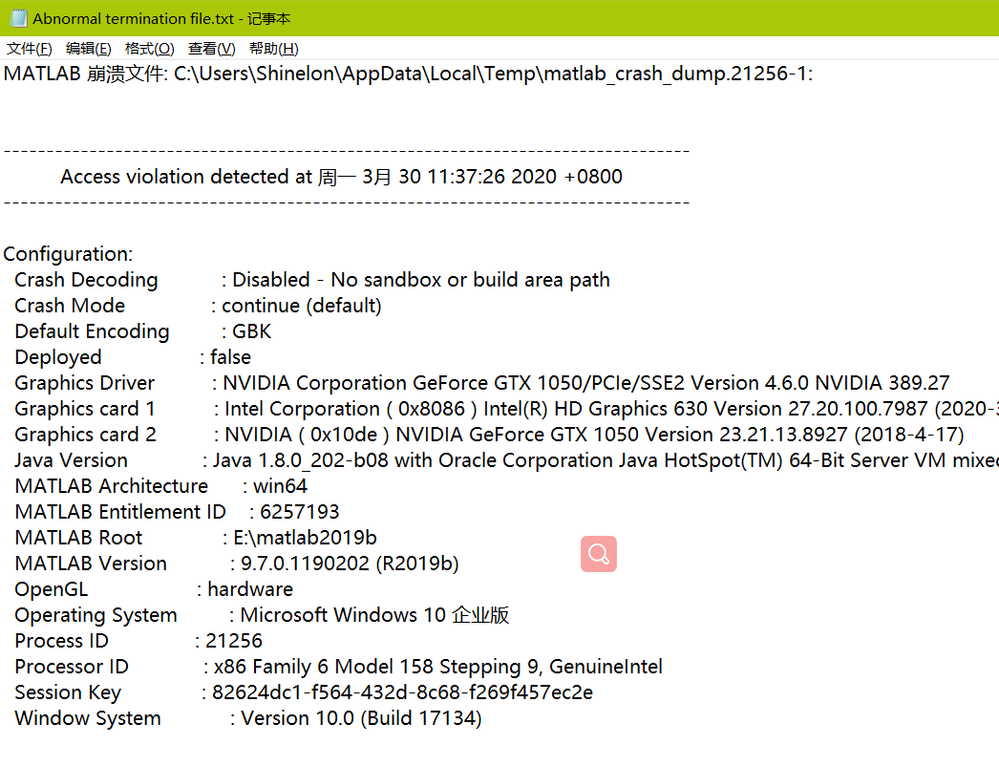

Hi Dear Daniel,
dumitru-daniel.popa
when i follow the course of lesson 9 to cancel  the diagnostic :eTimer and GPO like this
the matlab is abnormal termination .  I have added the  text of abnormal termination.
Can you help me solve the problems.
best regards.
hao
51,566 Views
Daniel_Popa
constantinrazvan.chivu‌,
Can you please have a look and if necessary fill a bug to MathWorks ?
Thank you!

51,567 Views
constantinrazva
Hello [email protected]‌,
Can you share the model you are using and let us know what toolbox version you are using? This way I can see if the issue is within our toolbox in the etimer_mpc574x_config.mex64 or some Simulink issue and open a ticket to MathWorks.
Kind regards,
Razvan.
51,563 Views
haoxue1027
Contributor V
Hello Constantin Razvan Chivu
Thanks for replying.
The model i used is the attachment of the Lecture 5-Hall Sensors .
 MATLAB versions is  matlab2018a
best regards
hao
51,562 Views
constantinrazva
Hello @[email protected]
I was referring to what version of our (NXP) toolbox. Can you run the following command in the MATLAB terminal and share the output with us?
ver
I suspect some setup issue and for that I'll have to replicate yours to come up with a solution. Thank you for understanding.
Kind regards,
Razvan.
51,556 Views
haoxue1027
Contributor V
hello@Razvan
I'm sorry to bother you, is there a solution for this problem?
I run the course again for the demo given by the course , found that system began to collapse until i use the Function-Call subsystem.
There is nothing wrong with using the routines from before lesson 5.
Please check if there's a link between the use of subsystem and system collapse ?
When I use demo"PMSM_ClosedLoop_mpc5744p", system collapse occured.
best regards
hao
51,546 Views
constantinrazva
Hello [email protected],
Please try what I've said in the topic you opened error during build (hall sensors)MBD for MPC5744P. Let us know if that fixed your issue, as I can not reproduce it.
Kind regards,
Razvan.
51,546 Views
haoxue1027
Contributor V
Hello,Razvan
thank you very much for reproducing the issue.
I have reset the path as you mentioned in error during build (hall sensors)MBD for MPC5744P ,but it seems not work.
There is something wrong with my computer system.
Thanks again for the answer to this question.
best regards
hao

constantinrazva
Sorry for the late reply - I found that you are using the 3.1.0 version of our release - I answered on the topic you opened on this issue. Briefly - I can not seem to be able to reproduce this issue you are having; please try my recommendations and let us know if that did the trick.
Kind regards,
Razvan.

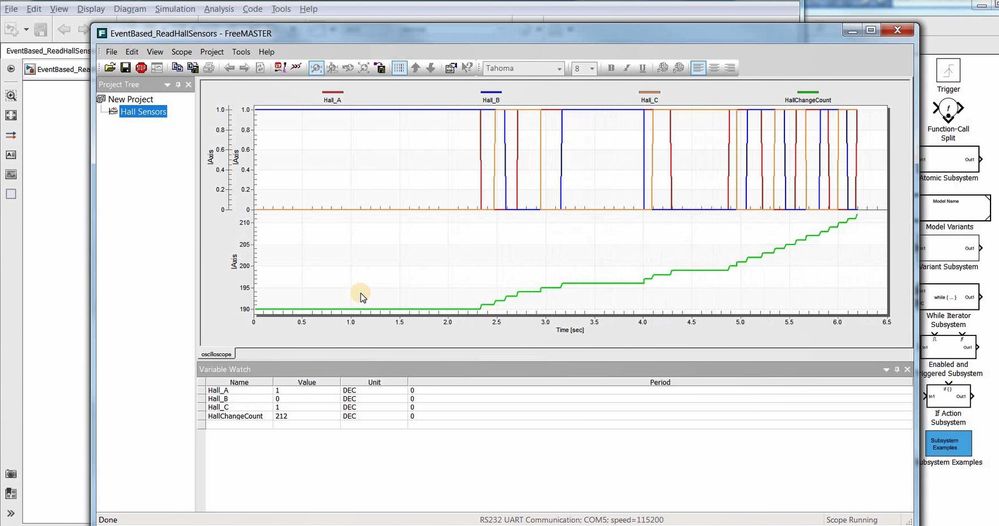

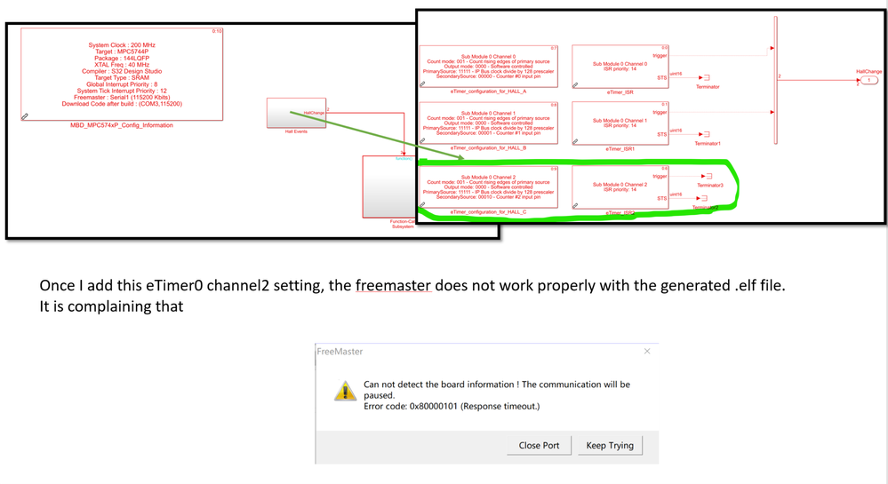

yujiangwu
Hi Dear Daniel,
dumitru-daniel.popa‌
Thanks for the excellent video first. I encountered a @Mahd Khalid. When I try to implement "EventBased_ReadHallSesnor". I get the error "Can not detect the board information" on FreeMaster. Specifically, when I add eTimer0 channel2 into the diagram. I start running into trouble.
In the picture, if I remove the portion circled by the green circle. I am good.
Thanks for your help!
Sincerely,
Yujiang Wu

mahdkhalid
Hi yujiangwu‌
Thank you for the reply.
How do you read the hall sensor C after removing this block?
Mahd Khalid
51,559 Views
yujiangwu
Hi mahdkhalid‌,
I did it just for debugging to see what was causing the issue with Freemaster. Yes, you do need it to read Hall_C. Please have a look at Freemaster Can't detect the board information.  Hope you can solve the issue as well.
Sincerely,
Yujiang Wu
51,559 Views
mahdkhalid
When using the EventBased_ReadHallSesnor file I get the same error "Can not detect the board information" on FreeMaster
I don't get this error in the ReadHallSensor file.
I have already applied the hotfix
Do I need to use CAN instead of UART?
Mahd Khalid
51,559 Views
Daniel_Popa
Hi mahdkhalid‌,
Switching to CAN is only required when your will use the MOTORGD to spin the motor because only then the TX1 will interfere with GD_RST_B pin that is supposed to be hold to 1 during pre-driver initialization and normal operation.
In this case i think there is a different issue. Perhaps and error in the model - like FreeMASTER configuration.
Hope this helps!

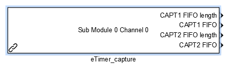

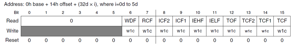

Daniel_Popa
Hi lukasschäfer‌,
The STS output maps over the Channel n Status Register (ETIMER_CHn_STS)
Each flag description can be found in the Reference Manual at page 1092.
To count between 2 edges you can:
#1: use the eTimer_capture block
#2: Or, you can use the STS to trigger some subsystem to count for.
#3: Or, you can use the eTimer ISR trigger output to start a SW counter (as i did in the Lecture 10) assuming there is no HW support for such capture event.
