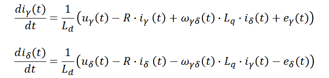

Starting from Eq. 15, lets start to write the equations for the predicted currents in γδ axes. First lets get rid of the matrix from and write them as a system of equations:
Eq. 16
Now, lets transform the Eq. 16 from s-domain to time-domain using Inverse Laplace transformation:
Eq. 17
If we rearrange the Eq. 18 in order to highlight the derivative terms for each current in  γδ axes we will obtain a system of differential equations:
Eq. 18
Is case you are interested to do the math and solve these 2 equations, then you will obtained the PMSM motor model as:
Eq. 19
All inputs and outputs of the Eq. 19 are limited to the fractional range (-1,1) and the  incorrect setting of the scaling constants may lead to an undesirable overflow or saturation during the computations. Scaling constants must be positive values equal to or greater than the expected maxima of the corresponding physical quantities. The following scaling constants are applied to the back-EMF estimator coefficients:

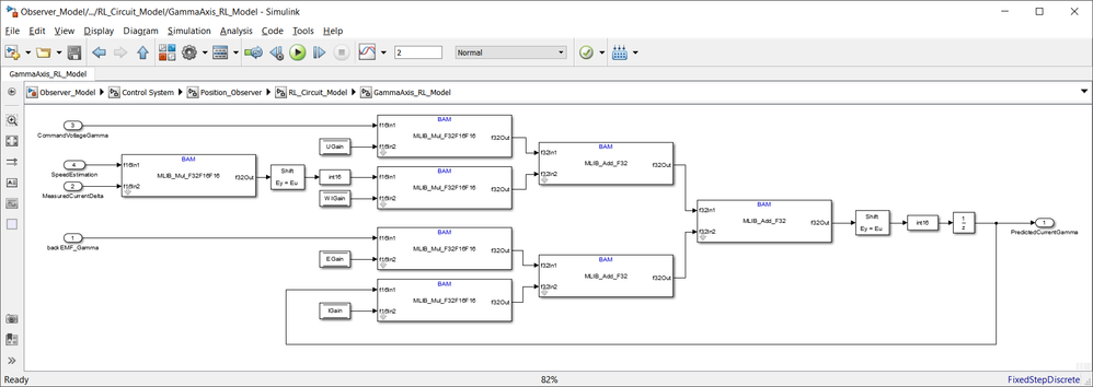

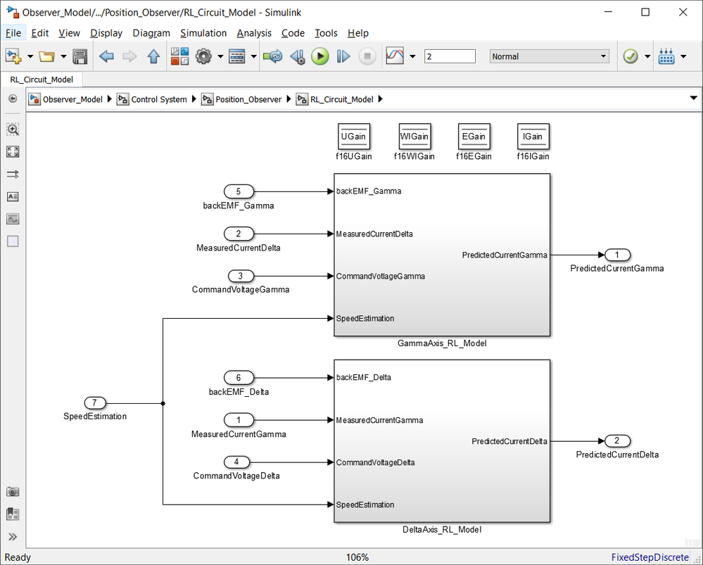

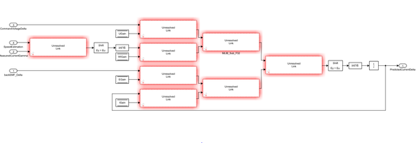

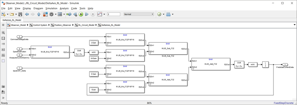

The Simulink model used to implement the Eq. 19 is shown below:
Fig. 12: RL circuit implementation used to predict the current in γδ axes
Fig. 13: Implementation details for each of the gamma and delta axis based on Eq. 19

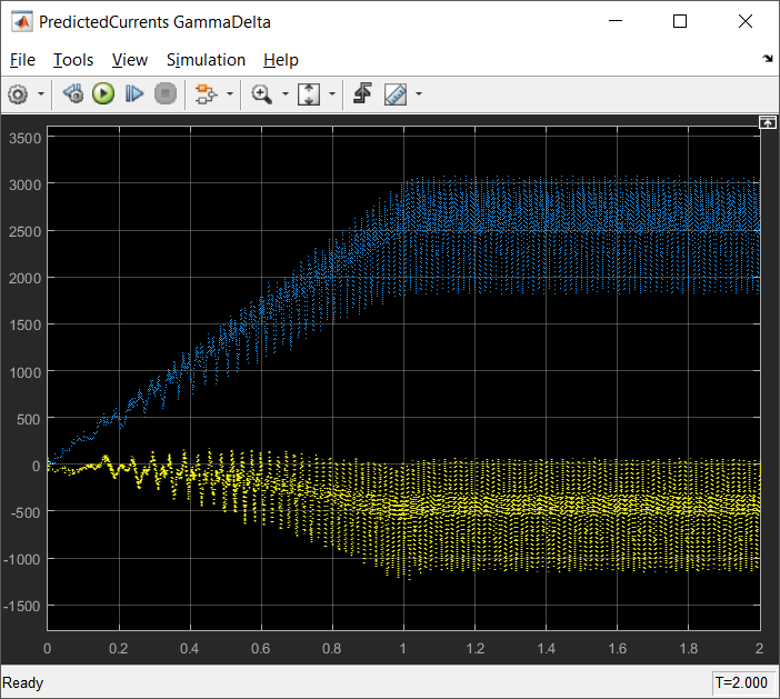

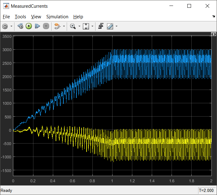

In order to check the accuracy of the predictions using this RL model lets compare the measured currents in dq frame with the predicted currents in γδ quasi-synchronous frame.
Fig. 14: On the left hand side are the dq measured currents, while on the right hand side are the predicted currents using Eq. 19

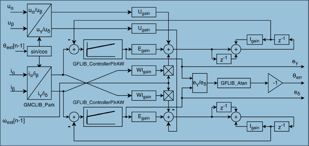

2.3 back-EMF Estimator
The back-EMF estimator is formed in both of γδ axes and the resulting θerr is later on extracted from the division Eγ/Eδ. If we assume sufficient rotor speed to create back-EMF then, the result of the Eγ/Eδ division is insensitive to the actual level of back-EMF. This allows correct setup of the PI controllers.
The PI controllers (one for each of the gamma and delta axes) coefficients can be easy computed as shown before using the root-locus method. All you need to do is to set ξ (the current loop attenuation), and ω0 (the current loop natural frequency) and the easiest way for choosing those coefficients is to use same values chosen for the FOC current loop controllers.

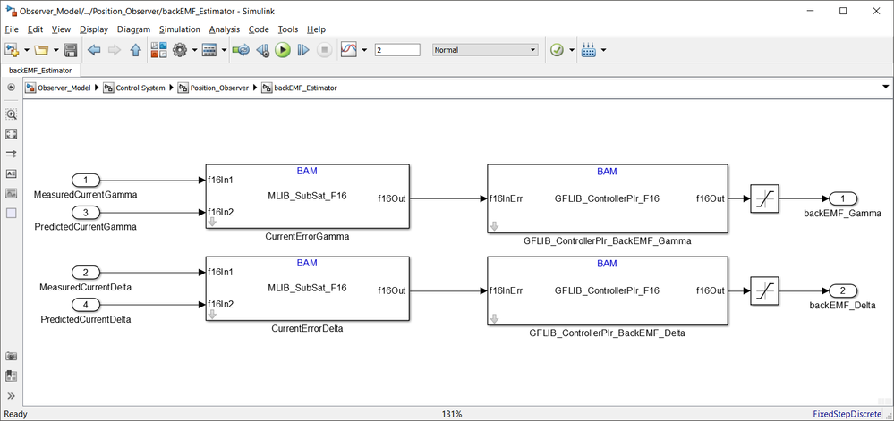

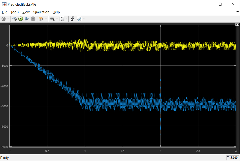

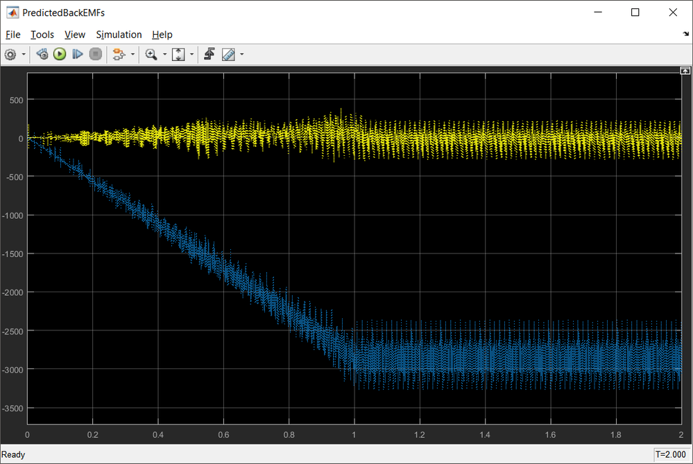

The Simulink model of the actual back-EMF estimator is shown in Fig. 15:
Fig. 15: back-EMF estimator based on PI in recurrent form model
The outputs of the PI controllers represents the predicted back-EMF terms produced by rotating magnets in the motor stator coils and are shown in the Fig. 16:
Fig. 16: The back-EMF estimator predicted back-EMF waveforms for a speed profile with 1000rpm/sec ramp

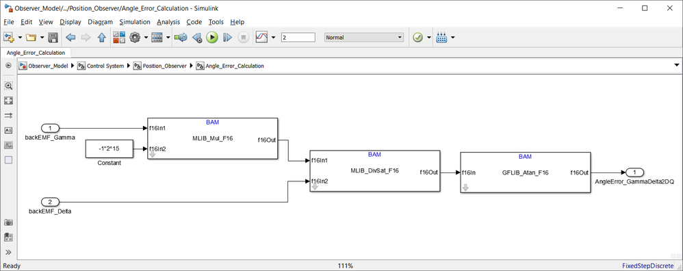

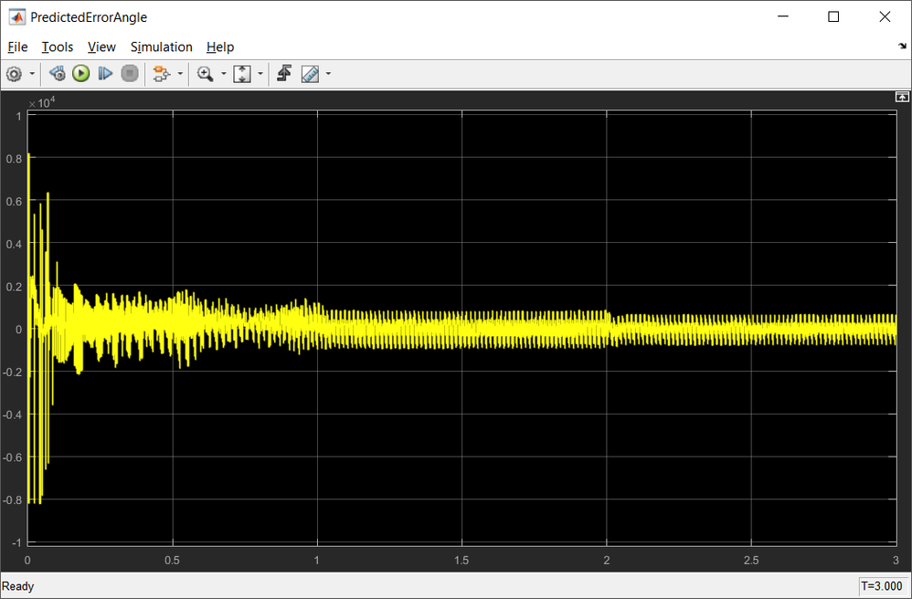

3. Position Tracking Observer
And finally we reached to the point where we can compute the actual rotor position and speed.

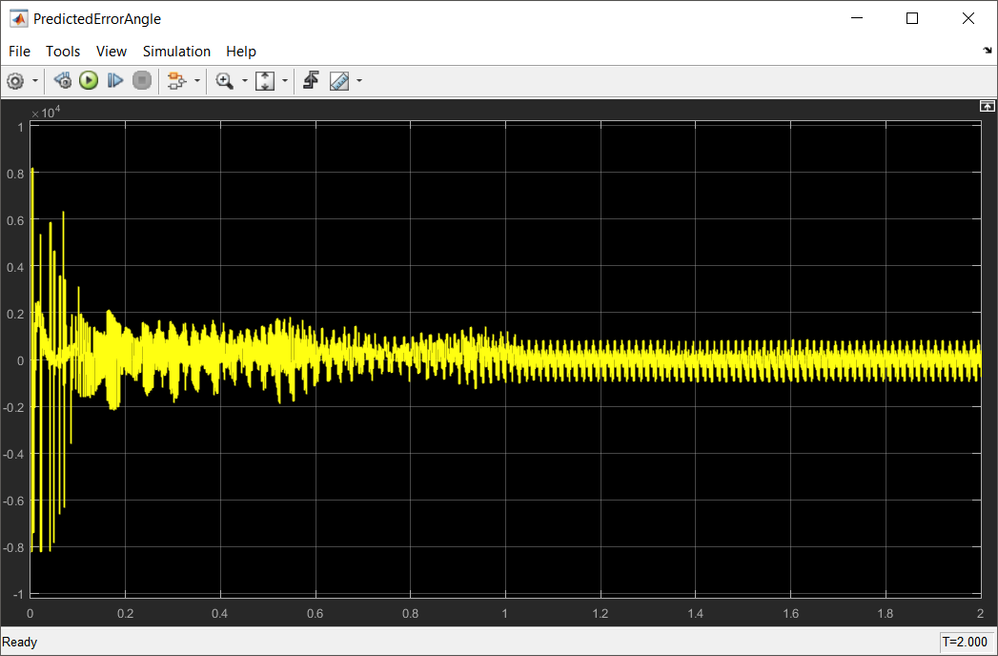

Since for the back-EMF estimator we have used the differences between the actual and estimated parameters, the resulting back-EMF estimates as outputs of PI controllers can be divided, to extract the information about the displacement between the estimated γδ and dq reference frames, while reducing the effect of the observer parameter variation. The position displacement θerr is obtained from Eq. 3.
The Simulink model used is shown in Fig. 17:
Fig. 17: θerr angle computation
Fig. 18: θerr angle variation during startup and steady state regime

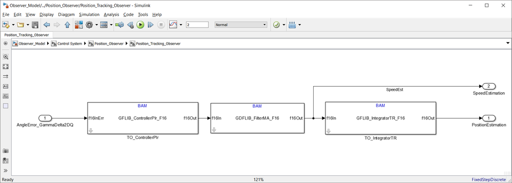

The Simulink model of the position tracking observer with a standard PI controller used as the loop compensator is shown in Fig. 19:
Fig. 19: Position tracking observer based on PI controller
As shown in Fig. 19, the position tracking controller consists of the standard PI controller and an Integrator. In between there is a moving average filter to level out some of the peaks within the estimated quantities.

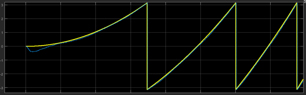

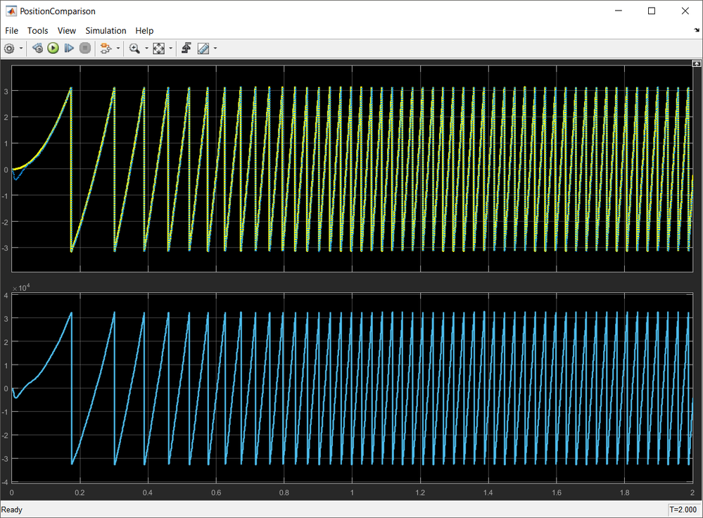

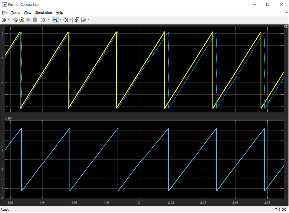

Now, if we run the model, we can get both the rotor position and speed.
Fig. 20: Predicted position (blue) against rotor true position (yellow). The predicted position is shown in both [rad] top, and scaled units [Q15] bottom
Fig. 21: Predicted position details: startup and delays
(yellow - true rotor position, blue - predicted position using back-EMF estimator and Position Tracking Observer)

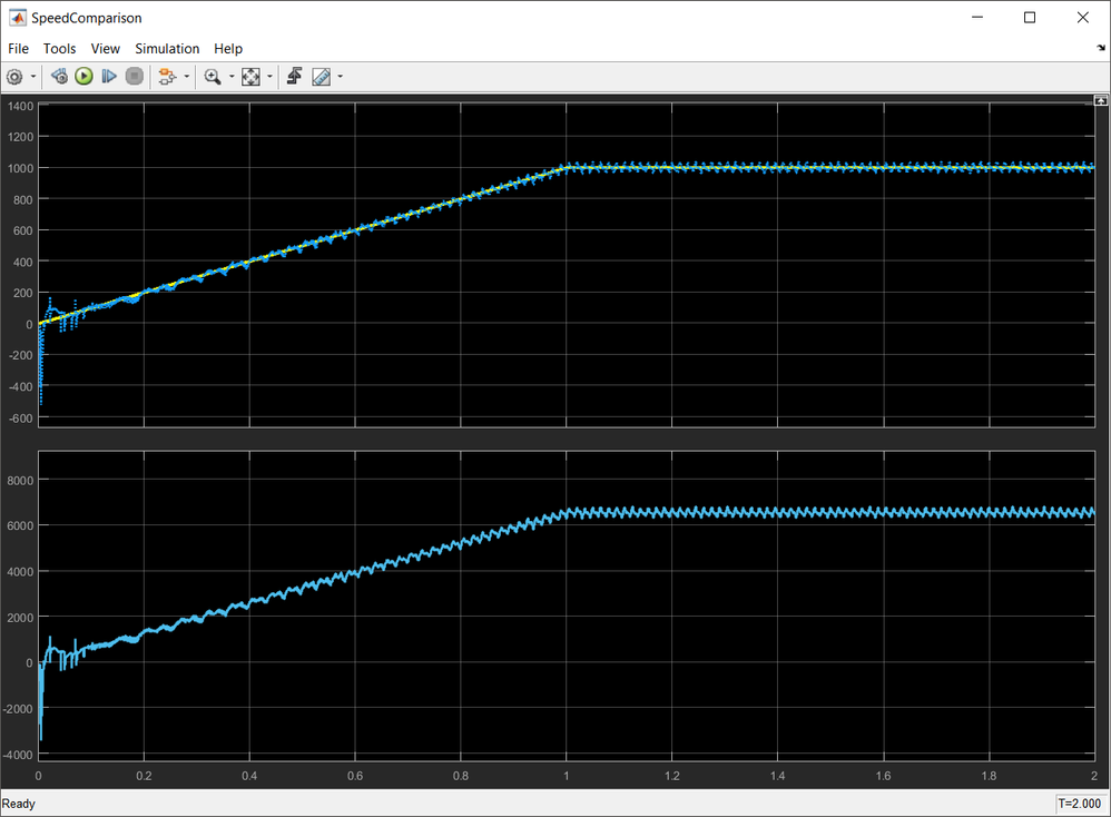

In Fig. 22 is shown a comparison of the motor actual/true speed and the predicted value based on the position tracking observer output. As can be seen at startup the speed information is subject to error due to low back-EMF levels but once enough back-EMF is built into the motor coils the estimation becomes accurate. Fortunately we have the means to get rid of those errors by using the special startup sequence.
Fig. 22: Rotor speed comparison: (yellow) true motor speed vs (blue) predicted speed

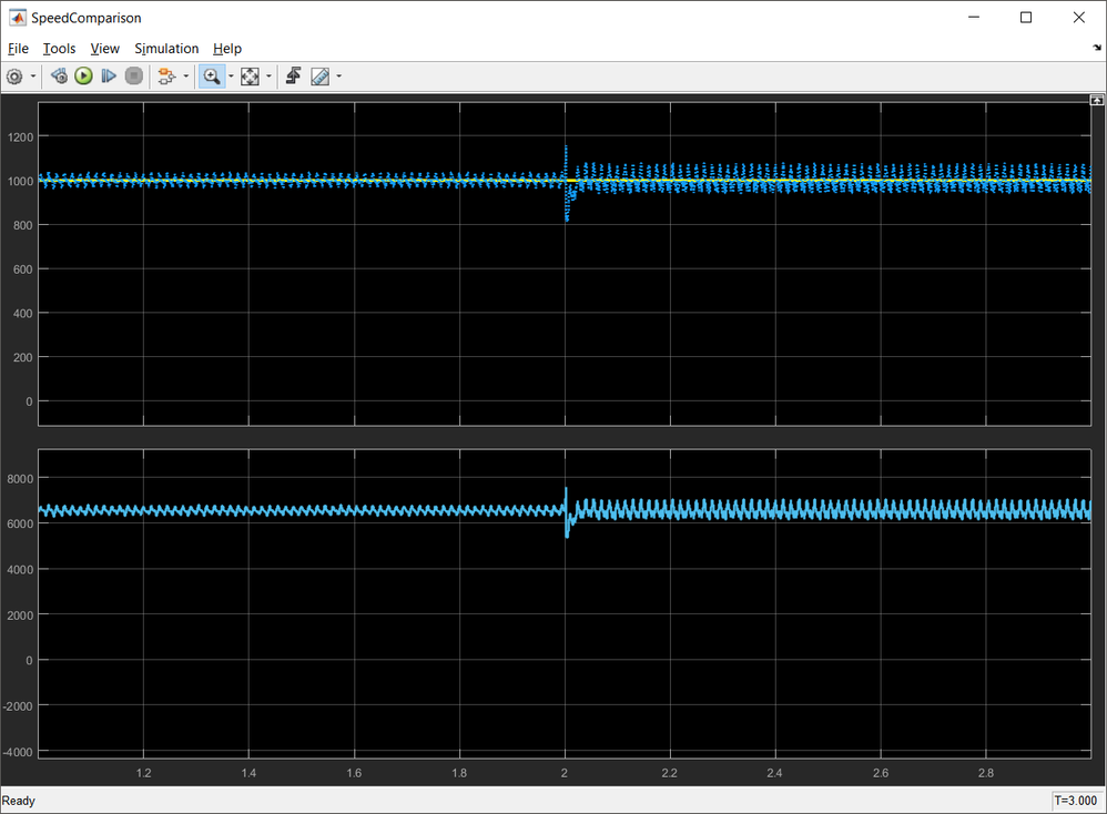

EXPERIMENTS and VALIDATIONS
At this point we can say we have managed to build and tune a position observer using only standard blocks from AMMCLIB package. The main question that may arise now: can it handle motor parameter variations due to temperature changes ?
To check that, at 2 seconds after startup we are going to simulate an increase in motor phase resistance as is the motor copper coils have increased the temperature from 20 degC up to 100 degC
Fig. 23: Disturbance due to phase resistance increase by 30%

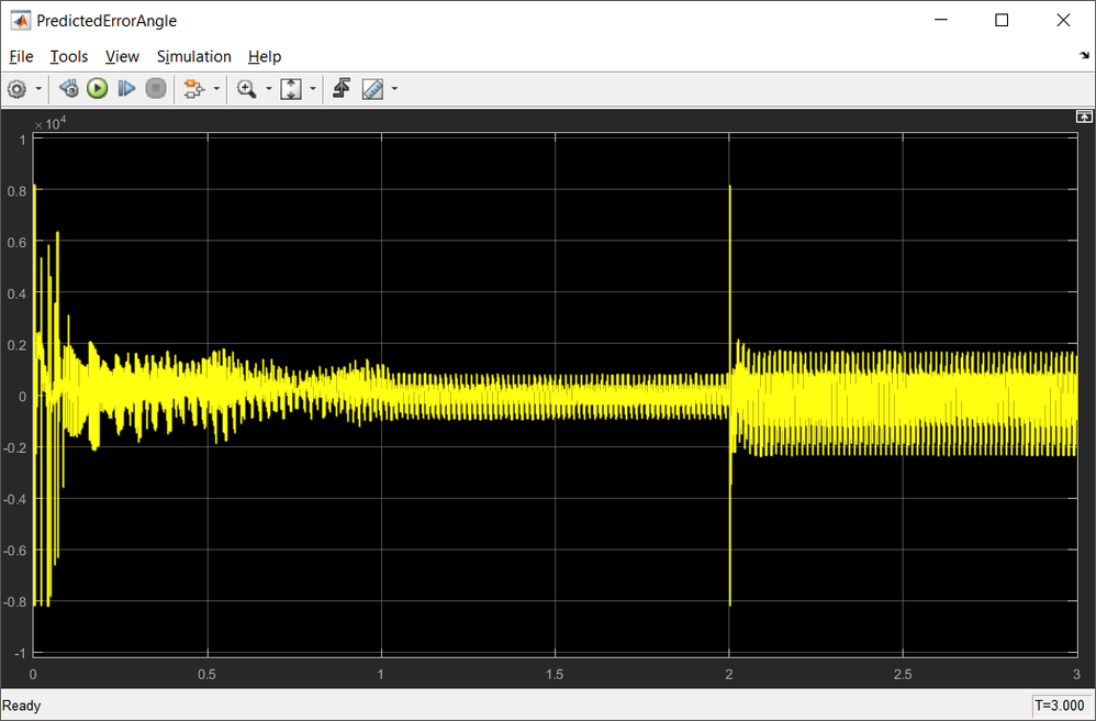

In this case the position observer predictions are:
Fig. 24: Back-EMFs and Angle Error predictions in case of R increases suddenly by 30%

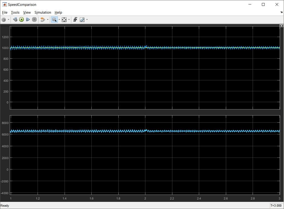

The only noticeable effect is small glitch in the estimated speed.
Fig. 25: Speed and Position prediction in case of R increases suddenly by 30%
Now, let's assume that the R decreases by 50%:
Fig. 26: Angle Error, Predicted Speed and Position in case of sudden decrease in R by 50%
What other scenarios can you imagine for testing such position observer ?

AjRj14
Hi Dainiel,
My matlab version is matlab 2019a and Model-Based Design Toolbox for S32K1xx Series Version 4.2.0.
When I am opening the simulink model Observer_Model.mdl from M9_2018.R1 , all the libraries are showing as "unresolved link".
Could you please help me to resolve this issue.

Dear Daniel,
Thank you for a great workshop within this topic!
I have a couple of thoughts/questions that I would be glad if you cleared out to me!?
A. "If we rearrange the Eq. 18 in order to highlight...", shouldnt that be referring to Eq. 17 instead?
B. When looking at your implementation of Eq 19 in the simulink environment I get insecure.
   B0. As people are asking about where the (k-1) variables disappears I guess that the variable is
         considered to be fairly constant from one sample to another? But then there should be a *2 in there too, shouldn't          it?
   B1. The "Shift Ey = Eu" blocks, what is that?
   B2. Shouldn't the output of the "PredictedCurrentGamma" be routed from before the 1/z block?
C. Under the section when you calculate the parameters for the Back-emf controllers. Can you please tell what PIr_BackEMF_Gamma_f16CC1 and  PIr_BackEMF_Gamma_f16CC2 are? Are these the proportional and integrating controller amplificatons?
Hope you can help out!
Tomas

jihan
Hi,Daniel
    In the  Eq.19, we have to add E(k-1)、W(k-1)*I(k-1)、U(k-1),
     but in the RL_Circuit_Model  block, we no need to add this, I have a doubt about it , thanks you!
44,034 Views
shey_alex
Daniel,
I would like to know the answer on this question as well.
44,034 Views
Daniel_Popa
Sorry for delay! For some reasons i was not aware of these replies.
First of all, thank you all for highlighting this issue. I think you are right.
The correct implementation should be something like this:
I'm going to recheck the model in the next days and i'll let you know my finding.
In any case if anyone of you have already fix the model and is willing to share it - i would be more than happy to reuse it.

i am from china。
Position Observer (Part 1/2):question about Eq1,Eq2。
how these eq1,eq2 come from?
can you give me some book name about that? thanks。

Daniel_Popa
Hi wu chao,
There are many articles and books available for free on the internet. I can't indicate a specific book but the eq. 1 and 2 represent the PMSM mathematical model in fixed orthogonal system (alpha/beta) which is standard.
Anyhow, please find here attached a generic article about PMSM equations. Have a look at eq. 1-7 (page 9). It is the same with eq. 1 with the following assumptions:
- v0 = 0 due to the motor symetrie
- rs = R
- Lls+3/2Lms = L
- p (Laplace operator) = d/dt
lapbda*dOr/dt =kv*w
Hope this helps!
