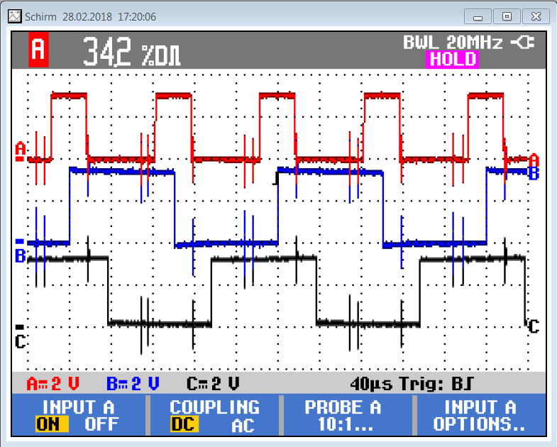

For a better understanding off all the variables we need to take into consideration lets us have a look at a typical shunt resistor voltage drop in case of a positive current passing thru. For readability, please consider the case of the phase A current measurement as depicted in Fig. 5.
As it shown in this Fig. 7,oscilloscope capture using the MotorGD DevKit, with cyan we have the 10kHz PWM signal command that controls the lower inverter switch on phase A, while the yellow signal represents the voltage drop on the inverter phase A shunt resistor. When there is no current flowing thru the value of the drop voltage is zero. When the current flows thru the MOSFET the voltage drop as a stable value, while by the time the current flows thru the anti-parallel diode the voltage is slowly going down to zero.
For more details regarding the current flows thru transistor or diode please check the training video in Module 4: Space Vector Modulation
Fig. 7: Voltage drop across a shunt resistor placed in lower part of inverter leg in case of the positive current passing thru
If we zoom in a little bit we will see the effect of voltage drop stabilization time and why we need that delay when performing the current measurements. Any measurement in that region is prone to error due to current oscillations due inductance nature of the load. We have to wait until the current reaches a steady state regime thru the load and shunt before standing the ADC sampling and acquisition.
Fig. 8: Zoom in detail with shunt voltage drop stabilization.

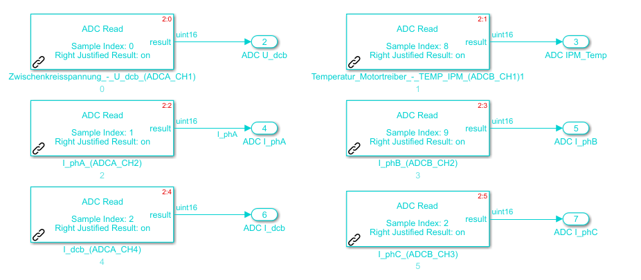

Expect for the phase currents that needs to be sampled in the same time, nothing prevent us for measuring additional analogue values that does not need to be synchronized with the PWM waveform. As it shown in Fig. 17, we are going to read two additional signals that will helps us with motor and drive protection in the future. These two additional signals represent the DC-link voltage and current.
Fig. 17: Analogue values to be read from MotorGD DevKit
This signal are routed to the S32K144 MCU via dedicated pins that reach the ADC converters as shown in Fig. 18.
Fig. 18: S32K144 analogue signal routing
By default the correspondence between the signals and the ADC instances is shown in the table below. Note that the phase currents are routed by default to the same ADC0 converter. If we leave them like this is going to complicate the application since we will have to deal with an additional delay between the sampling moment of phase A current and the moment when we sample again to read the phase B current. In this time interval the current thru phase B might change the value and the FOC may be distorted.

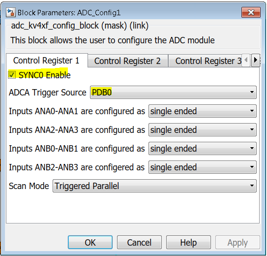

To solve these kind of issues, the S32K14x product families allows you to perform ADC hardware channels interleaving as shown in Fig. 19. In the hardware interleaved mode, a signal on the pin PTB1 can be sampled by both ADC0 and ADC1 in the same time. The interleaved mode is enabled by SIM_CHIPCTL[ADC_INTERLEAVE_EN] bits.
Fig. 19: S32K14x ADC hardware interleaved channels
Using this hardware trick we are going to re-route the phase B current measurement to the ADC1 instead of ADC0 and the new analogue pin assignment will look like this:
The last unknown piece of the puzzle is how synchronize the ADC measurement with the PWM command. Once again the S32K14x product family comes in handy with a rich feature set. The MCU contains a dedicated module for inter-connectivity of various hardware modules. This module is called TRGMUX and provides an extremely flexible mechanism for connecting various trigger sources to multiple pins/peripherals as shown in Fig. 20.
To trigger the ADC conversion we are going to use the FTM initialization trigger (INIT_TRIG) functionality. The INIT_TRIG is going to raise an event each time the PWM counter is re-initialized signaling this way the beginning of a new PWM period. This way the TRGMUX can re-route this event to the ADC modules to signal the moment when the ADC should start the acquisitions.
Fig. 20: PWM - ADC synchronization

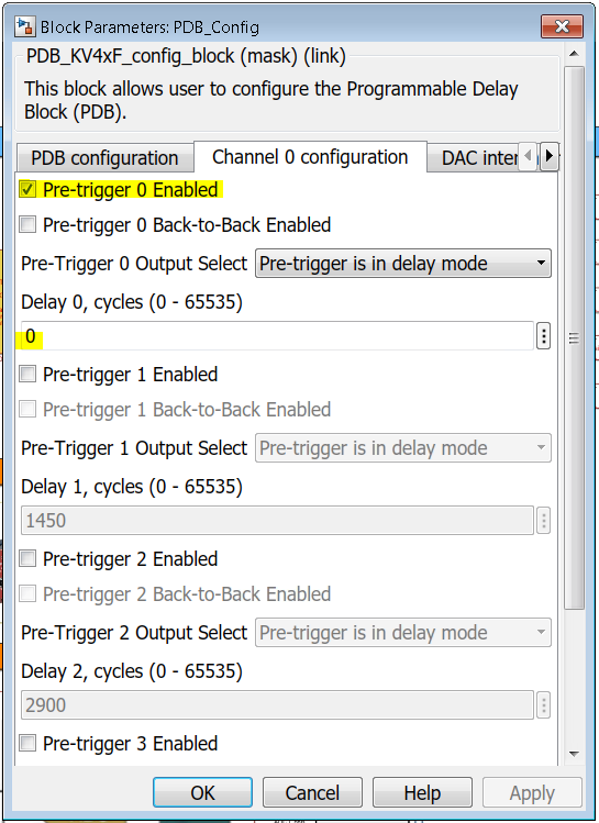

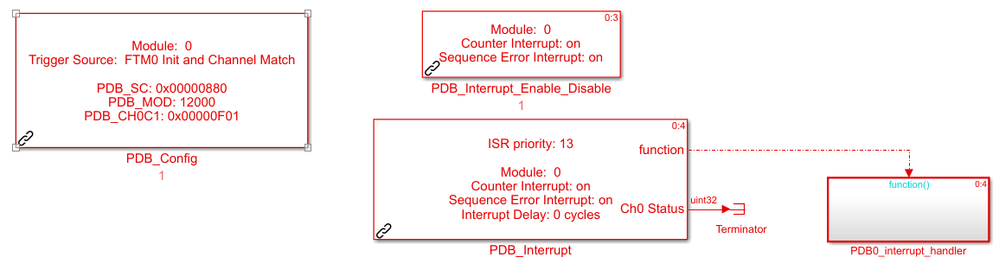

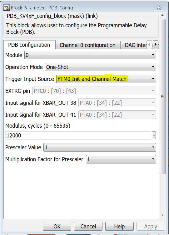

As we have found out from Dual-Shunt Sensing Technique section, apart of PWM to ADC synchronization we also need to handle various sources of delays in the system. The S32K14x MCU families have a dedicated peripheral called Programmable Delay Block (PDB) that can trigger specific events based on a pre-condition.
In our case, we are going to configure the PDB instances to receive the same FTM INIT_TRIG event and to command the ADC acquisition at a specific moment in time which is delayed compared to the beginning of the PWM period. The specific delay timing intervals will be discussed in the next section.
Fig. 21: PDB triggering scheme of ADC conversion using same event synchronization source INIT_TRG

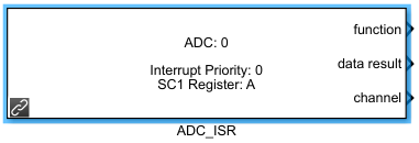

The overall ADC triggering concept can be summarize in Fig. 22. The FTM issue the counter initialization trigger which is used as a trigger input of the PDB. The PDB is then used to trigger the ADC. Each ADC channel in the PDB module supports up to 8 pre-triggers, which could be used as the ADC hardware channel selection to precondition the ADC block prior to an actual trigger. After a pre-trigger, the ADC trigger initiates the ADC conversion. When a PDB pre-trigger starts an ADC conversion, an internal lock associated with the corresponding pre-trigger is activated. This lock becomes inactive when receiving the conversion complete (COCO) signal from the ADC.
Fig. 22: ADC trigger concept that implements the PWM-ADC synchronization
As can be seen from Fig. 22 the main CPU is not involved in this mechanism once the entire chain of events is configured. This leaves more resources available for the programmer to implement the application.

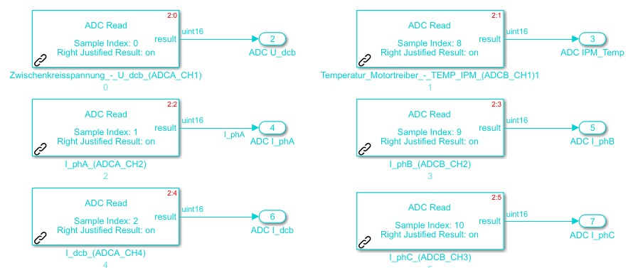

  • Hardware configuration for a proper current sensing using PWM-PDB-ADC synchronization
  • Software computation for scaling the ADC conversion into the real values for currents and voltages
The Simulink blocks that are going to be added in this module are highlighted in Fig 23, in red while the blocks that are going to contain small modifications relative to the previous module are marked with magenta.
Fig. 23: Top level Simulink model used for ADC measurements

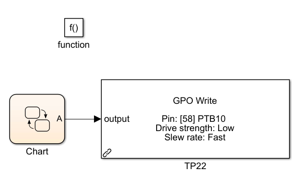

MOSFET Pre-Driver Configuration
The first thing we have to do is to make sure MOSFET pre-driver is configured correctly according with MC34GD3000 datasheet. To do configure it correctly we need to perform a specific sequence of commands in order to make sure pre-driver outputs are enabled and latched prior to normal operation:
  • RST input signal goes HIGH while the EN1 and EN2 input signals remain LOW;
  • EN1 and EN2 inputs are set to HIGH state
  • PA_LS_G, PB_LS_G, and PC_LS_G outputs are toggled HIGH for about 1.0 μs (HS outputs are enabled, but not latched)
  • Toggle PA_HS_G, PB_HS_G, and PC_HS_G outputs LOW for dead-time periord plus at least 0.1 μs
Fig. 24: MOSFET pre-driver configuration (a) - left side shows the pre-driver signals (b) - right shows the full initialization sequence

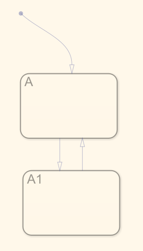

The entire initialization sequence is implemented in Simulink using the State-Flow charts and triggered subsystems that mimics the sequence shown in Fig. 24b. The subsystem is implemented in the Fast Loop Control and it is executed only once after reset.
Fig. 25: Pre-driver initialization Simulink model
The SPI communication is not yet implemented since it is not in the purpose of this module. All the data are prepared and will be sent to the pre-driver in a future module when we will have to configure various hardware protections.

The actual pre-trigger vs. ADC channel pairing is done via SC1 Register selection. If you wish to have a particular order in which you capture the analogue conversions then you simply assign the appropiate latter A, B, C, D, etc to the conversion block: A corresponds to R0, B to R2 and so on.
Ok I think I understand, your PDB1_IRQHandler:
ADC0, Pre-trigger0 - SCI Register A - Ia (6900 cycles)
ADC1, Pre-trigger0 - SCI Register A - Vdc (0 cycles)
ADC1, Pre-trigger1 - SCI Register B - Idc (4100 cycles)
ADC1, Pre-trigger2 - SCI Register C - Ib (6900 cycles)
Now KV4x
With KV4x It is only possible to configure the sample indes and I don't have this SCI Register Options like you see here:
Also in the ADC Sample or ADC Config block I didn't found this SCI Option. So how do I know which ADC pair is read with which pre-trigger here?

First of all the three PWM low side igbt signals:
Now I have set the Initialization Trigger in the external Trigger tab of "FTM Three Phase Output", which should be exactly in the middle of PWM low side Signal.
With the Timer Overflow I checked the time of the initialization with a testpin
TOF Interrupt handler:
In the PDB config block I have configured "FTM0 Init and Channel Match"
I only configured one Pre-Trigger in the Channel 0 configuration without any delay.
The ADC(in simultaneous mode) is triggered from the PDB0
The configured ADC samples:
After the PDB triggeres the ADC all ADC samples are read !

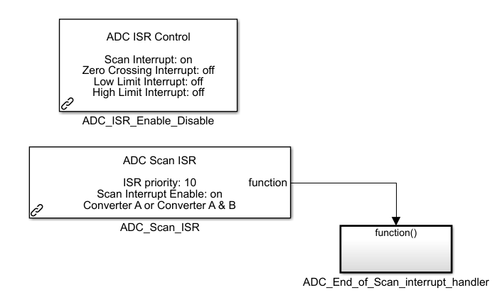

After the end of scan I checked this with a second testpin
End of Scan Interrupt handler
Here you can see the PWM A low side (red) Timer Overflow (blue) and ADC End of Scan (black) with pre Trigger delay 0
The same with pre-Trigger 3000, you see the time of switching the state of the black Signal is later (this would lead to Problems because the low side IGBT isn't in conduction over the complete measurement.

Obviously all the configured ADC samples are read if the pdb triggeres the adc in the middle of pwm low side Signal.
So also U_dcb, IPM_Temp and I dcb are read here, which requires sample time.
To improve the measurement it would be better only to measure I_phA and I_phB directly with the Initialization Trigger.
The measurement of the other samples U_dcb, IPM_Temp could be leter in the pwm cycle
Do you know a way for this, so to seperate the Timing of reading the different samples ?
I'm not quite sure with I_dcb, at which Point of one PWM cycle this should be read ?
Leon

Why you set 8000 cycles in the PDB configuration ? I think this corresponds to 10kHz ? But why ?
The S32K14x operates at 80MHz. To obtain a 10kHz frequency from the PWM you need a counter that counts up to 80MHz/10KHz = 8000 ticks.
The PDB is syncronized with PWM, therefore the PDB counter is also set to restart at 8000 counts.

with FTM_CHN_ISR block I'm now able to generate a Trigger Event at the Moment the lower IGBT is in conduction.
but with the stateflow diagram below of course the pin only switches every time the trigger occurs.
Could you Show me your example to Switch back the testpin before a new Trigger Input occurs ?
with eFlexPWM_Interrupt I get this message...
It is just copied out of the "kv4xf_eflexpwm_isr" example and also worked in another model.
Function Call Subsystem:
Do you have an idea to fix this ?
That is a consistency check error because the toolbox has detected that you are using an interrupt from an uninitialized block. Make sure you have the same selection of Sub-module in both PWM and ISR Simulink Blocks.

I just want to switch on a testpin for a short Moment and not for a complete PWM cycle. Just like you did in "Fig. 32: Synchronization between PWM command for the lower switch (cyan) and PDB Interrupt (yellow) as result of FTM initialization Trigger". This code isn't in the M6 part 2/2 I think. With my stateflow model the testpin only switches at every point of the Trigger Event.
Of course there are the same Sub modules, you can see it on the Picture:
- eFlexPWM Three Phase: Sub Module 0 1 2
- eFlexPWM Interrupt: Sub Module 0
This is the Image I'm talking about. Your testpin (yellow) switches on for a short Moment (a pulse of something like 4us) with falling edge PWM command Cyan.
My testpin only Switches the state with every falling edge of pwm, so it requires something to Switch back without having a new Trigger Input.
Does this make it more understandable what I mean ?

I have found out that the eFlexPWM Interrupt works if I use three complementary pwm Output blocks (module 0, module 1 and module 2) instead of one three Phase Output block... is that a bug ?
