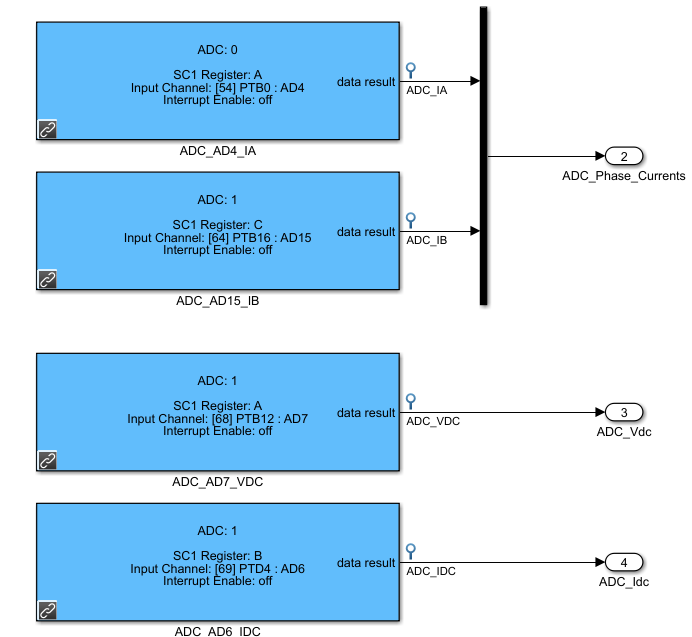

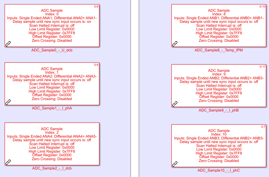

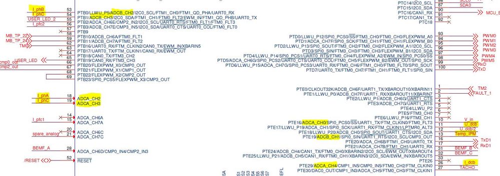

This signal are routed to the S32K144 MCU via dedicated pins that reach the ADC converters as shown in Fig. 18.
Fig. 18: S32K144 analogue signal routing
By default the correspondence between the signals and the ADC instances is shown in the table below. Note that the phase currents are routed by default to the same ADC0 converter. If we leave them like this is going to complicate the application since we will have to deal with an additional delay between the sampling moment of phase A current and the moment when we sample again to read the phase B current. In this time interval the current thru phase B might change the value and the FOC may be distorted.

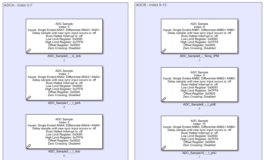

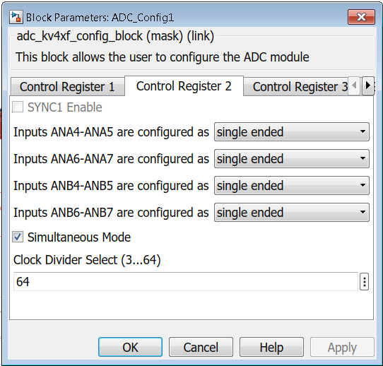

To solve these kind of issues, the S32K14x product families allows you to perform ADC hardware channels interleaving as shown in Fig. 19. In the hardware interleaved mode, a signal on the pin PTB1 can be sampled by both ADC0 and ADC1 in the same time. The interleaved mode is enabled by SIM_CHIPCTL[ADC_INTERLEAVE_EN] bits.
Fig. 19: S32K14x ADC hardware interleaved channels
Using this hardware trick we are going to re-route the phase B current measurement to the ADC1 instead of ADC0 and the new analogue pin assignment will look like this:

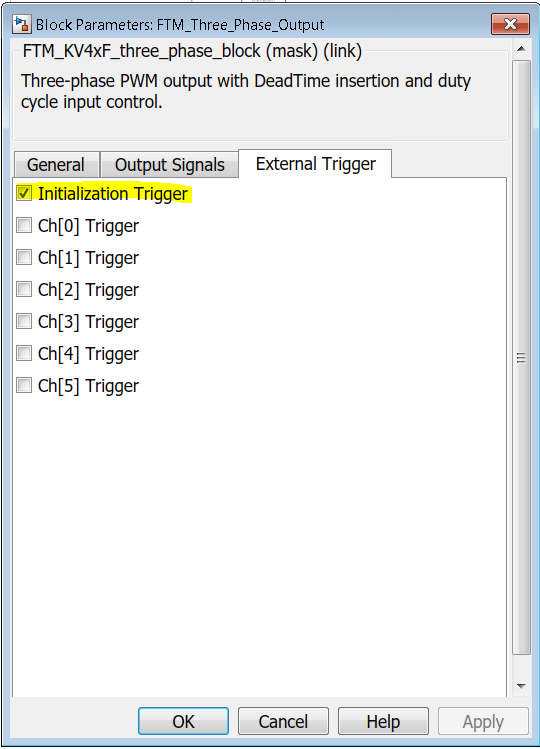

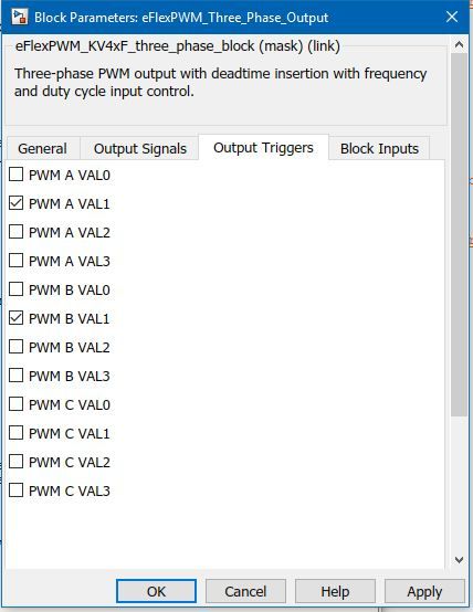

The last unknown piece of the puzzle is how synchronize the ADC measurement with the PWM command. Once again the S32K14x product family comes in handy with a rich feature set. The MCU contains a dedicated module for inter-connectivity of various hardware modules. This module is called TRGMUX and provides an extremely flexible mechanism for connecting various trigger sources to multiple pins/peripherals as shown in Fig. 20.
To trigger the ADC conversion we are going to use the FTM initialization trigger (INIT_TRIG) functionality. The INIT_TRIG is going to raise an event each time the PWM counter is re-initialized signaling this way the beginning of a new PWM period. This way the TRGMUX can re-route this event to the ADC modules to signal the moment when the ADC should start the acquisitions.
Fig. 20: PWM - ADC synchronization

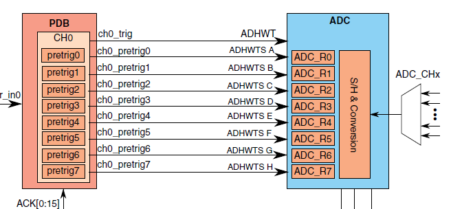

As we have found out from Dual-Shunt Sensing Technique section, apart of PWM to ADC synchronization we also need to handle various sources of delays in the system. The S32K14x MCU families have a dedicated peripheral called Programmable Delay Block (PDB) that can trigger specific events based on a pre-condition.
In our case, we are going to configure the PDB instances to receive the same FTM INIT_TRIG event and to command the ADC acquisition at a specific moment in time which is delayed compared to the beginning of the PWM period. The specific delay timing intervals will be discussed in the next section.
Fig. 21: PDB triggering scheme of ADC conversion using same event synchronization source INIT_TRG

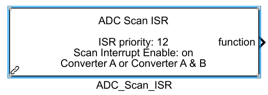

The overall ADC triggering concept can be summarize in Fig. 22. The FTM issue the counter initialization trigger which is used as a trigger input of the PDB. The PDB is then used to trigger the ADC. Each ADC channel in the PDB module supports up to 8 pre-triggers, which could be used as the ADC hardware channel selection to precondition the ADC block prior to an actual trigger. After a pre-trigger, the ADC trigger initiates the ADC conversion. When a PDB pre-trigger starts an ADC conversion, an internal lock associated with the corresponding pre-trigger is activated. This lock becomes inactive when receiving the conversion complete (COCO) signal from the ADC.
Fig. 22: ADC trigger concept that implements the PWM-ADC synchronization
As can be seen from Fig. 22 the main CPU is not involved in this mechanism once the entire chain of events is configured. This leaves more resources available for the programmer to implement the application.

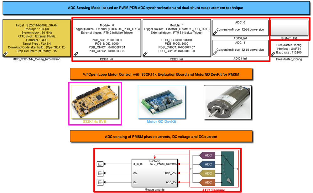

EMBEDDED TARGET APPLICATION DEVELOPMENT
As mentioned in the Introduction, we are going to reuse and enhance the model developed in the previous module Module 5: V/F Scalar Control to perform:
  • Hardware configuration for a proper current sensing using PWM-PDB-ADC synchronization
  • Software computation for scaling the ADC conversion into the real values for currents and voltages
The Simulink blocks that are going to be added in this module are highlighted in Fig 23, in red while the blocks that are going to contain small modifications relative to the previous module are marked with magenta.
Fig. 23: Top level Simulink model used for ADC measurements
The Simulink model can be broken apart in various configuration steps as shown below.

The Flex Timer Module needs to be configured to:
  • perform a special PWM start-up sequence to enable the pre-driver configuration;
  • send an interrupt each time the timer is getting reinitialized in order to allow PWM-PDB-ADC syncronization

The final ADC configuration that needs to be done is to setup the conversion channels associated with the values we want to measure. The ADC conversion results are currently read in the PDB interrupt handle which is synchronized with the FTM PWM initialization trigger.
Fig. 31: Simulink model for ADC conversion results reading

1) Your "FTM_Three_Phase_Output" is Module 3, why you have Chosen "FTM2 External Trigger" in your PDB0 and PDB1 init blocks ?
Nope, i've selected the FTM3 Initialization trigger. You can see that selection in
Fig. 37: PDB0 and PDB1 global configurations: trigger source, external trigger type and PDB counter value within Module 6: Current Sensing (Part 2/2)
Also, 211126_211126.pngyou can see the FTM3 Initialization trigger selection. Perhaps something went wrong during import of the slx in your environment.
Your ADC sensing is done in a PDB_ISR. How do you know which ADC sample is done with which pre-trigger ?
There is a specific HW arrangement that "connects" each PDB pre-trigger to each ADC hardware channel.
The actual pre-trigger vs. ADC channel pairing is done via SC1 Register selection. If you wish to have a particular order in which you capture the analogue conversions then you simply assign the appropiate latter A, B, C, D, etc to the conversion block: A corresponds to R0, B to R2 and so on.
Ok I think I understand, your PDB1_IRQHandler:
ADC0, Pre-trigger0 - SCI Register A - Ia (6900 cycles)
ADC1, Pre-trigger0 - SCI Register A - Vdc (0 cycles)
ADC1, Pre-trigger1 - SCI Register B - Idc (4100 cycles)
ADC1, Pre-trigger2 - SCI Register C - Ib (6900 cycles)
Now KV4x
With KV4x It is only possible to configure the sample indes and I don't have this SCI Register Options like you see here:
Also in the ADC Sample or ADC Config block I didn't found this SCI Option. So how do I know which ADC pair is read with which pre-trigger here?
Actual I use one PDB_config (module 0) and adc works in simultaneous mode. So I would expect this:
Pre-trigger0 - ADCA Sample Index 0, ADCB Sample Index 8
Pre-trigger1- ADCA Sample Index 1, ADCB Sample Index 9
Pre-trigger2 - ADCA Sample Index 2, ADCB Sample Index 10
Is that correct or am I wrong ? I also have looked in the KV4x Reference Manual, but it is not specially announced here which pre-trigger is for which adc sample.

The PDB_Interrupt only works if I activate the external Trigger Option in the FTM_Three_phase_Output block. Ch[1] Trigger should be the Moment of the LowSide IGBT A is in conduction ? This would be valid for I_phA but not for I_phB and I_phC ? Or should I configure "Initialization Trigger" ?
You don't have activated this Option in your s32k model...? But maybe because you was able to choose "FTM3 Initialize Trigger" in the PDB config ?
Obviously I don't exactly understand the Connection between "External Trigger" in FTM_Three_Phase_Output, PDB Trigger Input Source "FTM0 Init and Channel Match", PDB Pre-trigger 0,1,2 and ADC Sample. Could you explain that for me for KV4 ?

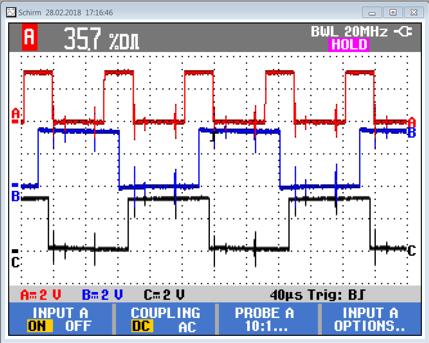

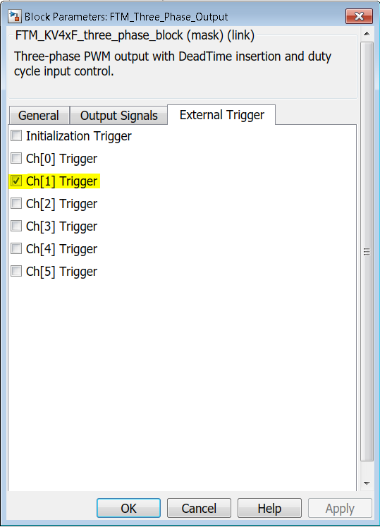

First of all the three PWM low side igbt signals:
Now I have set the Initialization Trigger in the external Trigger tab of "FTM Three Phase Output", which should be exactly in the middle of PWM low side Signal.

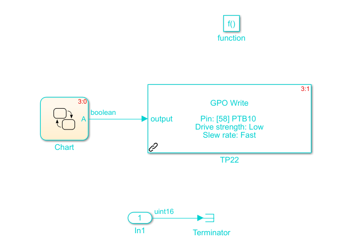

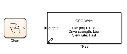

With the Timer Overflow I checked the time of the initialization with a testpin
TOF Interrupt handler:

The ADC(in simultaneous mode) is triggered from the PDB0
The configured ADC samples:
After the PDB triggeres the ADC all ADC samples are read !
After the end of scan I checked this with a second testpin
End of Scan Interrupt handler
Here you can see the PWM A low side (red) Timer Overflow (blue) and ADC End of Scan (black) with pre Trigger delay 0
The same with pre-Trigger 3000, you see the time of switching the state of the black Signal is later (this would lead to Problems because the low side IGBT isn't in conduction over the complete measurement.

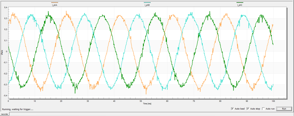

The currents in freemaster:
Now let me ask something.
Obviously all the configured ADC samples are read if the pdb triggeres the adc in the middle of pwm low side Signal.
So also U_dcb, IPM_Temp and I dcb are read here, which requires sample time.
To improve the measurement it would be better only to measure I_phA and I_phB directly with the Initialization Trigger.
The measurement of the other samples U_dcb, IPM_Temp could be leter in the pwm cycle
Do you know a way for this, so to seperate the Timing of reading the different samples ?
I'm not quite sure with I_dcb, at which Point of one PWM cycle this should be read ?

Congrats!!! You current measurements looks very good/clean. In my case i had to deal with various sources of measurements noise - but in your case i see the results are quite perfect.

Hello dumitru-daniel.popa‌,
first thank you again for this module which is really important to implement the FOR later on.
I think with the KV4x it will be a little bit different to trigger the ADC with the PWM.
The currents are already matched to the two ADC modules, so no interleaving should be required ?
Also the initialisation routine could not be the same, because there is no "PWM Enable/Disable" block in the KV4x library? The "Start pin generation immediately after initialization" option I couldn't found in the "FTM_Three_Phase_Output" or "eFlexPWM_Three_Phase_Output". What I have to consider here ?

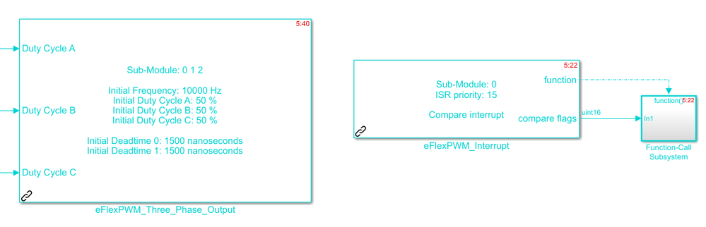

If I use the "FTM_Three_Phase_Output" I principle could use your way with Simulink Coder Custom Code blocks to call the FTM function that enables the trigger generation ?
With the "eFlexPWM_Three_Phase_Output" I could use the Output trigger tab shown below ?
Also I have a simple question to the beginning:
Why you set 8000 cycles in the PDB configuration ? I think this corresponds to 10kHz ? But why ?
Leon
5,696 Views
Daniel_Popa
Hi Leon,
Indeed, no interleave required in your case.In case of S32K14x and MotorGD that needs to be done since that is how the hardware was designed. In case of custom design - knowing that MCU support interleaving might save you from a lot of troubles regarding pin assignment and signal routing.
Yes, some of the older toolboxes does not have such options. In case of KV the PWM signal generation are done at the initialization stage.
That should not pose any important issues. Still make sure that at the startup the commands that are passed to the PWM are initialized with a same value that does not create a voltage potential at motor terminals. A good practice is to make sure at initialization the default duty cycle is 50% or the high and low signal are not overlapping.
Also, make sure the PWM block has the lowest priority in the model compared with the initialization of the other block like ADC, timers, etc.
Depending on the relative Simulink priority, the PWM should be the last block to be configured in Simulink initialization phase. This way to make sure that all the other blocks that depends on the PWM are not started accidentally.
That's a bug in our current toolbox for S32K - we can enable the trigger only once and since i need the special initialization sequence of the MC34GD3000 predriver i was forced to re-enable the trigger. I used the custom code to workaround that issue :-)
You do not need it.
Yes!
The S32K14x operates at 80MHz. To obtain a 10kHz frequency from the PWM you need a counter that counts up to 80MHz/10KHz = 8000 ticks.
The PDB is syncronized with PWM, therefore the PDB counter is also set to restart at 8000 counts.
You do not need it.
The KV4x "FTM_Three_Phase_Output" has no "Output Trigger" tab like "eFlexPWM_Three_Phase_Output".
How could I  generate a trigger with FTM_Three_Phase_Output every PWM sequence with KV4x?
S32K Toolbox has no "eFlexPWM_Three_Phase_Output", so for working with KV4x I should simply use this to use the Trigger event ?

with FTM_CHN_ISR block I'm now able to generate a Trigger Event at the Moment the lower IGBT is in conduction.
but with the stateflow diagram below of course the pin only switches every time the trigger occurs.
Could you Show me your example to Switch back the testpin before a new Trigger Input occurs ?
with eFlexPWM_Interrupt I get this message...
It is just copied out of the "kv4xf_eflexpwm_isr" example and also worked in another model.
Function Call Subsystem:
Do you have an idea to fix this ?
I'm not sure i understand. All the code is shared as part of the M6.zip here:Module 6: Current Sensing (Part 2/2)
That is a consistency check error because the toolbox has detected that you are using an interrupt from an uninitialized block. Make sure you have the same selection of Sub-module in both PWM and ISR Simulink Blocks.
I just want to switch on a testpin for a short Moment and not for a complete PWM cycle. Just like you did in "Fig. 32: Synchronization between PWM command for the lower switch (cyan) and PDB Interrupt (yellow) as result of FTM initialization Trigger". This code isn't in the M6 part 2/2 I think. With my stateflow model the testpin only switches at every point of the Trigger Event.
Of course there are the same Sub modules, you can see it on the Picture:
- eFlexPWM Three Phase: Sub Module 0 1 2
- eFlexPWM Interrupt: Sub Module 0

lethuer
Contributor V
Hi dumitru-daniel.popa
This is the Image I'm talking about. Your testpin (yellow) switches on for a short Moment (a pulse of something like 4us) with falling edge PWM command Cyan.
My testpin only Switches the state with every falling edge of pwm, so it requires something to Switch back without having a new Trigger Input.
Does this make it more understandable what I mean ?

I have found out that the eFlexPWM Interrupt works if I use three complementary pwm Output blocks (module 0, module 1 and module 2) instead of one three Phase Output block... is that a bug ?
