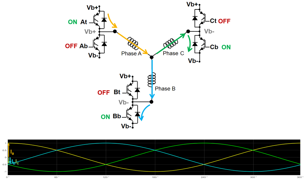

In case of PMSM that are controlled with Field Oriented Control, all three phase windings can conduct current at all times. The only constraint is that the sum of all phase currents must NULL, or putted in other words, the phase currents should form an isolated symmetric 3-phase system.
Using three pairs of switches connected to a voltage source,  we can control the current's flow and the magnitude by  switching ON or OFF the transistors as shown in Fig 2. The selection of switches ON/OFF state, will determine the current sense, and the time while the which is connected to actual power source will determine the magnitude of the currents that flow thru the windings.
Fig. 2: Commutation principle for 3-phase AC motors
Note: when we talk about "switch" we refer to an integrated device that contains one transistor (e.g.: MOSFET, IGBT) and one anti-parallel diode. The role of diode is essential in motor control applications due to the nature of the load: inductive
Since the load is inductive, there are times when the transistor must be turned ON while the current flows in the opposite direction. Since the MOSFET can carry only positive current (from drain to source), the diodes give a path for the current to flow. Without the diode the inductive current with stop instantly, generating high voltage peaks that may damage the transistor.
To control a PMSM we will need 6 switches that needs to be connected in pairs of two: one connected to a positive voltage source (we call that the TOP switch) and the other one connected to a negative voltage (we call this one the BOTTOM switch).
Each pair of switches will be controlled in complementary mode – meaning the switches can’t be ON in the same time. In general as a precaution, to avoid any accident like short-circuit, there is a small period of time referred as dead-time when both transistors are OFF.

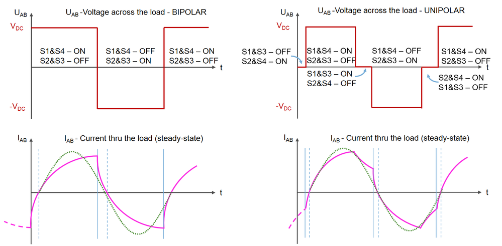

  • BIPOLAR – we use only rows 2 and 3 in Table 1 to control the switches. In this case the voltage applied on the load can have only 2 distinct values: +Vdc or –Vdc
  • UNIPOLAR - we use all four combinations of switches leading us to a load voltage that can have 3 distinct levels: zero, plus or negative DC bus voltage.
The main differences between BIPOLAR and UNIPOLAR commutations are highlighted in the Fig.4. On the left, we have the load voltage and current variation for bipolar case while on the right hand side we have the same quantities but this time for unipolar commutation method.
Fig. 4: Bipolar vs. Unipolar Modulation technique comparison

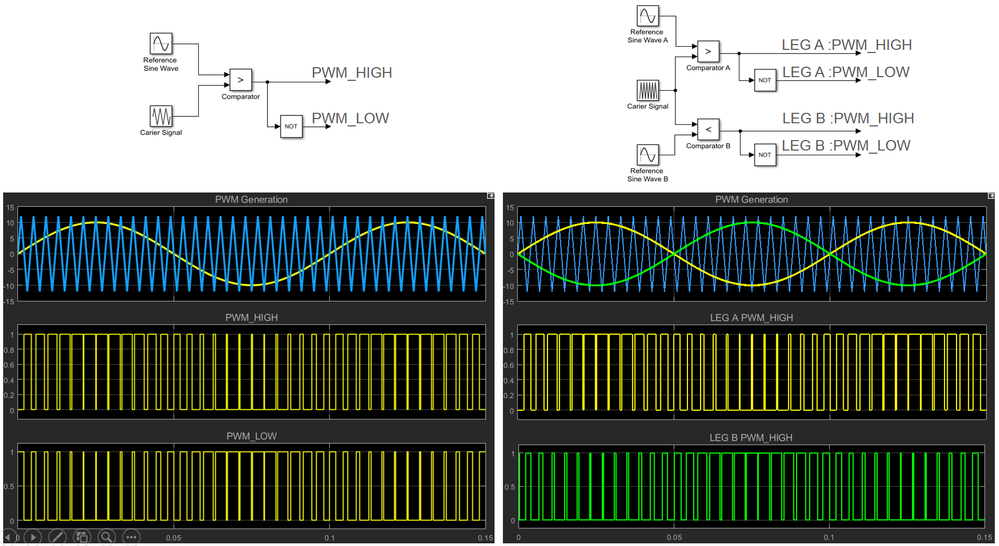

The bipolar modulation is quite simple and the logic to implement such method is elementary. All we need is a carrier signal, usually a sawtooth signal that is compared against the signal waveform you wish to obtain. The values obtained after comparison are used to control the top and bottom switches that forms one inverter leg. Since the control pulses varies in width – hence the name of Pulse Width Modulation (PWM).
In case of unipolar modulation, the logic to generate such signals looks similar, the only difference being the fact that we need to add a second reference source to control the switches on the second inverter leg. Usually this second reference signal is phased out with 180 degrees compared with the source for the first inverter leg.
In Fig. 5, we have an example of switching commands for bipolar (on the left hand side) versus unipolar (on the right side) commutation methods in case of 10 Hz sinusoidal waveform and a 1 kHz carrier signal.
Fig. 5: PWM generation for bipolar and unipolar modulation
If we are going to apply these sets of PWM commands to control the voltage and current over an inductive type of load like PMSM windings we are going to obtain the variations shown in Fig. 6. Here you can clearly see the main differences between both commutation methods.

Fig. 6: Bipolar vs. Unipolar modulation results: voltage and current thru an inductive load
As we can see there are a few fundamental differences between bipolar and unipolar modulation techniques:
  • The first notable difference is the current waveform that is much smoother  in case of unipolar commutation than the corresponding one obtained with bipolar modulation. The fact that we apply a smaller effective voltage helps keeping the current ripple smaller and reduces the harmonics produced. As you can seen the current waveform resemble better the sinusoidal waveform in case of the unipolar modulation.
  • Less voltage stress seen by the transistors in case of unipolar compared to bipolar method where the transistors needs to switch off 2 times the amount of DC voltage, in unipolar technique they see only half of that stress. This makes the unipolar method more suitable of high-voltage applications.
  • The switching logic is more complicated in case of unipolar method since we need to pass thru an intermediate state.
  • Effective switching frequency which is higher in case of unipolar commutation even if we used the same 1khz carrier signal.

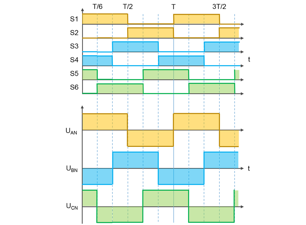

For PMSM control we will need to use a three leg inverter since we will have three motor terminals that needs to be supplied with power. The inverter is made of six switches that allows eight possible combinations (keep in mind that each pair of switches are controlled in complementary mode: when one is ON the other is OFF)
If we place a 3-phase symmetric load between the each leg mid-point we can build the Table 2 that summarize the sign and voltage level of each of the switching combinations.
Table 2: Terminal voltages in case of 3-phase inverter
If Table 2, is confusing to you, lets draw the terminal voltage variation based on the switches gate commands as shown in Fig. 7.
If we start with a random sequence for top switches commands (ON-OFF-ON), as shown in Table 2 line 6,  we see that the voltage sequence will be: positive for terminal A and C and negative for terminal B. Each time we have a top switch in conduction – meaning ON – the terminal voltage will be positive and vice versa when the bottom switch is ON the terminal voltage becomes negative.
Fig. 7: Gate commands and Terminal voltages in case of 3-phase Inverter

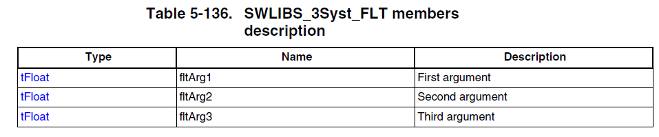

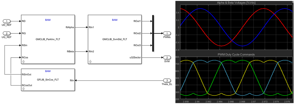

I have a question regarding the output of GMCLIB_SvmStd_FLT1 block. Why output of this block is not a square wave with varying duty cycle? Why its output is standard wave form of SVM.
46,436 Views
constantinrazva
Hello [email protected]‌,
So this block has the following outputs:
where:
  • sector is the output of the GMCLIB_SvmStd_FLT function from AMMCLIBpastedImage_2.png
  • fltOut1-3 represent the output argument of the GMCLIB_SvmStd_FLT functionpastedImage_3.png
So you can think of the block as this:
sector = GMCLIB_SvmStd_FLT(&Out, &In);
fltOut1 = Out.fltArg1;
fltOut2 = Out.fltArg2;
fltOut3 = Out.fltArg3;
in which Out is a struct of SWLIBS_3Syst_FLT type
I'm sorry I don't have more details on this matter, I can only point you to the AMMCLIB User guide for more details (you can find it in {INSTALL_ROOT}\mbdtbx_mpc574x\AMMCLIB_MPC574xP\doc\MPC574XPMCLUG.pdf.
