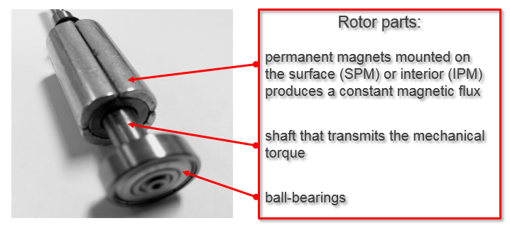

The PMSM's rotor (Fig. 2) is usually made of permanent magnets mounted on the surface (SPM) or inside the rotor (IPM) and a steel shaft that transit the torque to various devices.
Fig. 2: The rotor with surface mounted permanent magnets
The motor we are going to use thin this workshop was chosen to facilitate the development of the sensorless motor control. It has two pole pairs which are built in so called salient pole rotor type. This means that the stator flux path lengths varies in respect with the rotor position. This is a fancy way to say that the magnetic reactance is different between the motor flux and torque axes. This will helps us to build a magnetic salient tracking observer to estimate the rotor position and to eliminate the need for having a position sensor mounted on the motor shaft.

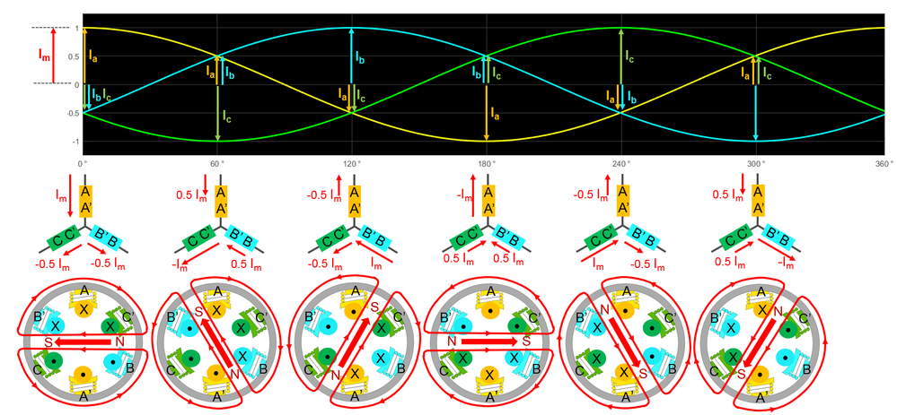

The key to rotate the motor's rotor is to be able to produce a rotating magnetic field in the stator like the one in Fig. 3. The most common way to produce a rotating magnetic field is to energized the coils with AC currents. If a three phase balanced current system is passed thru a system made of three windings/coils that are spatially distributed at 120 degrees apart, then the resulting magnetic field will rotate with the same frequency as the 3-phase AC current. The "guy" that figured this out was Mr. Tesla
Fig. 3: Producing a rotating magnetic field in the stator
If we oversimplify the physical processes that happens inside the stator coils and yoke, and instead of a continuous AC current waveforms we conveniently choose only 6 strategic interest points then you can easily see how the resulting magnetic flux vector is shifting its direction in sync with the AC current systems.
Controlling the position and strength of the magnetic field produced in the stator is the first step towards the Field Oriented Control.

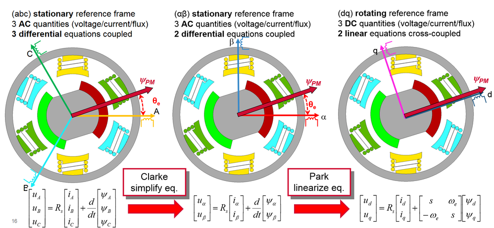

The ESSENCE of Field Oriented Control is to align the stator current vector (Is) that produces the rotating magnetic field (red dotted line arrow in Fig. 4.) with the rotor torque-axis. To have the motor to perform at its peek efficiency the magnetic flux produced by the stator windings must be at 90 electrical degrees compared to the magnetic flux produced by the rotor.
Fig. 4: Field Oriented Control Goals
To align the stator flux vector with the rotor torque axis a the key aspect of Field Oriented Control technique is to know the position of the rotor at any moment (the angle between the rotor flux axis and the stator phase A magnetic axis). Without this critical piece of information the whole mechanism will fail to perform.

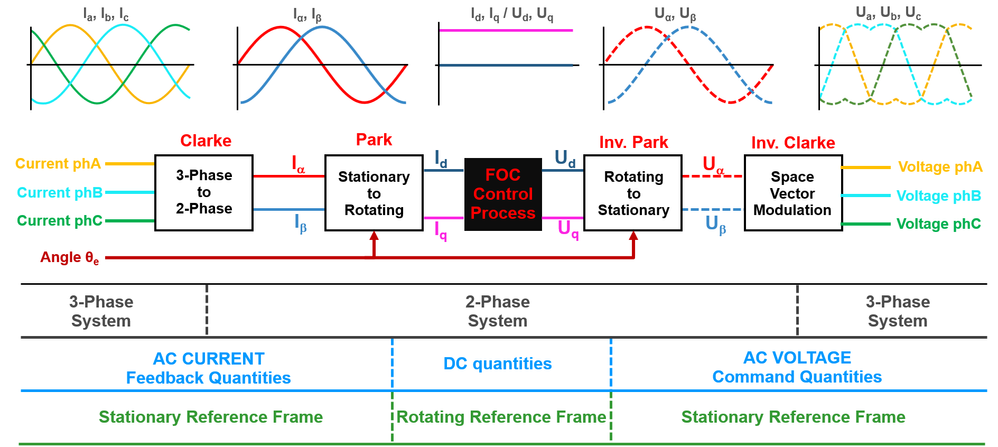

The Field Oriented Control gives us a the possibility to simplify the entire control structure of the synchronous machines using a series of mathematical transformations that allows us to think and act as in a linear domain rather that in a complex one where quantities varies in time and space. In other words, by using the FOC and the concepts derived from it we can transforms a 3-phase AC motor into a simple 1-phase DC motor where magnetic field and motor torque can be controlled separately and this mechanism is described in Fig. 5.
Fig. 5: Clarke and Park transformation used for Field Oriented Control
Starting from a 3-phase PMSM standard mathematical model that is described by 3 differential equations in a fixed reference system, we can perform a simple Clark transformation to reduce the number of equations and then have them translated using Park transformation from a time domain into a Laplace domain where the model can be described by 2 simple linear algebraic equations as shown in Fig. 6.
Fig. 6: PMSM mathematical model simplified with Clarke and Park transformations

Daniel_Popa
Hi [email protected]‌,
FOC does not care if the motor is wye or delta. It will drive the motor with the same voltage patterns in both cases.
Anyhow, you need to pay attention how you set the current and voltage limits&protections for wye vs. delta since in both case you work with line values.
Hope this helps!

jihan
Fig.4  , A winding Align the magnetic Axis  of Phase A, right? I think there is something wrong in the picture.
59,533 Views
Daniel_Popa
Hi jihan‌,
In Fig.4 the A winding is denoted as A-A'. In A the current flows in (.) while in A' the current flows out :smileyx:.
If you consider that as a round coil, then the magnetic flux will be perpendicular to the A-A' plane. That is why the Magnetic axis of phase A is shown in horizontal position.
Hope this clarify the issue. Let me know if this is ok with you. Anyhow, how would you draw it ? I know there are different way to represent motors abc/alphabeta/dq reference frames. Each university might have its own preferences. I would be interested to know your view.

jdavey
Hi Dimitru,
I too am confused about figure 4.
In figure 3 we see the (X) and (.) rotating such that there is always 3 (X) followed by 3 (.), yet in Figure 4 they are alternating (X) (.) (X) (.) (X) (.)
I think what you are trying to show is the magnetic axis of each coil when the current is in a positive direction (Yellow, Green and Cyan arrows).  However you would not energise the coils in this manner simultaneously as the magnetic fields would cancel each other out. is that a correct understanding?
So I was confused as to which of the 6 positions shown in figure 3 is Figure 4 most closely aligned to.
Can you clarify?
John
59,532 Views
adriantudor
Hi John,
In figure 4, as you can see, there is an alternating (X) (.) (X) (.) (X) (.), where (.) represent start of the coil and (X) represent end of the coil. So if you connect ( (.) to positive potential and (X) to negative potential) each of the coils to a power source, then for each of those coils there will appear an magnetic flux corresponding to current sense which flow through coil. Those three coils are connected together at one side (let say each end of those coils --> star connection). This common side of coils is not connected to any side of power source. Then if you want to energize the motor you will have to connect (through an switch/transistor) at least one coil to positive potential and at least one to negative (ground) side. The current entering the motor must also go out :smileyhappy: . Due to that it is not possible to have at the same time magnetic field like in figure 4.
Adrian
