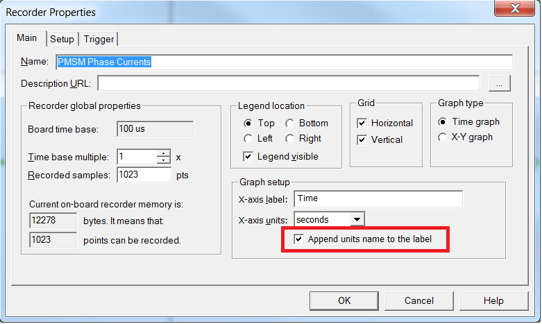

First successes !!!
After you made any changes in the freemaster_cfg.h file you simply have to Close Freemaster and open again to see the changings !
Also you have to delete the matlab generated <modelname> folder before the new compile.
Then the xAxis is labeled with "Time" after making any changes in the graph Setup !
Also the changed FMSTR_REC_BUFF_SIZE 12278 is visible now in the Recorder Setting window and it seems to work with this value. But I didn't found the available ram in the map file yet.
So Good hint dumitru-daniel.popa‌ !!!

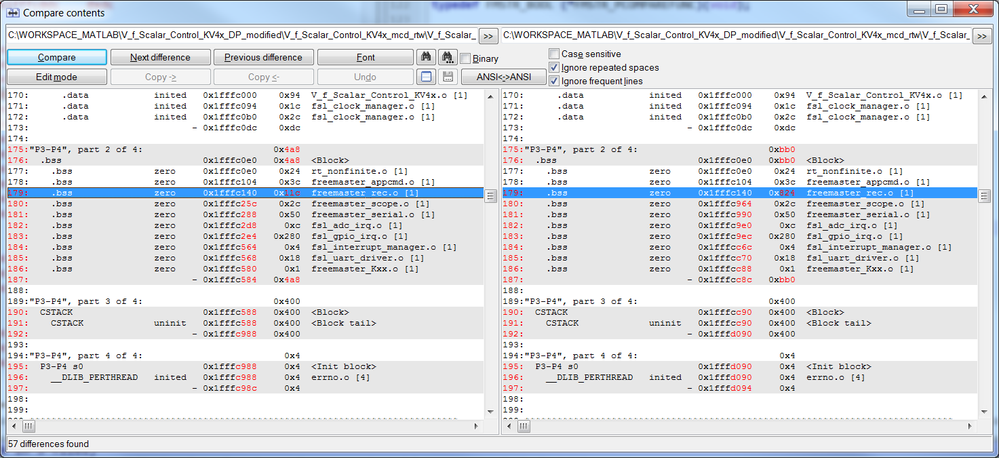

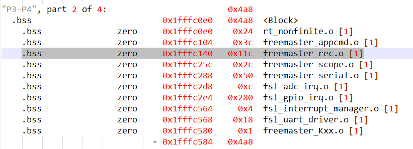

  1. programmatic approach: you check where is the buffer defined:
/* statically allocated recorder buffer (FMSTR_REC_OWNBUFF is FALSE) */
static FMSTR_U8 pcm_pOwnRecBuffer[FMSTR_REC_BUFF_SIZE];‍‍
The pcm_pOwnRecBuffer is statically defined in freemaster_rec.c file. This means it will be past of the BSS section for freemaster_rec.o
All you have to do now is to check the map file for mapping of BSS section of the freemaster_rec.o module
From linker file you compute how much space you still have available till the end of the segment
2. lazy approach: simply increase the size of the buffer and compare the memory files

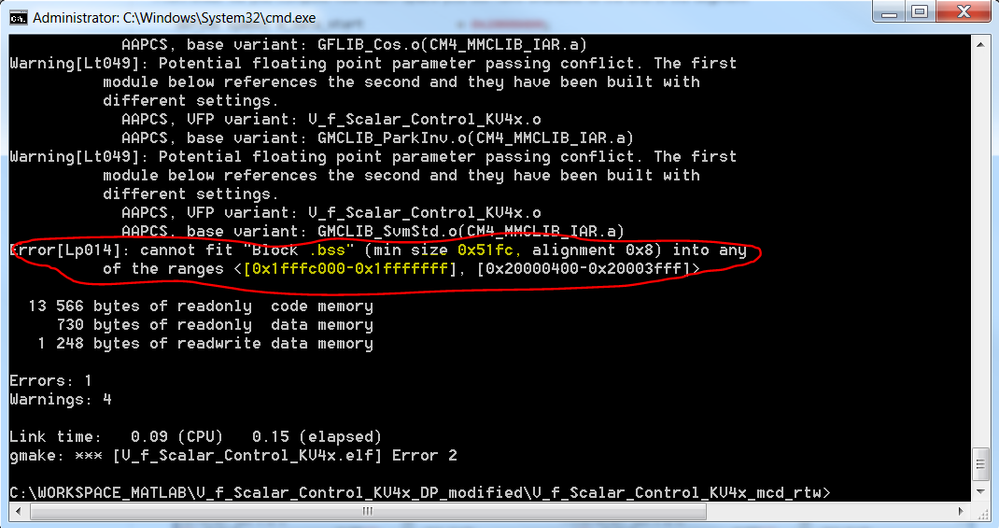

Now increase the size until you get a linker error. You can do this very fast from Windows CMD by calling the *.bat file from the generated folder.
In this case i tried to allocate
/* built-in recorder buffer (use when FMSTR_REC_OWNBUFF is 0) */
#define FMSTR_REC_BUFF_SIZE            20000                     /* built-in buffer size */‍‍
and it failed, indicating the *.bss section and the memory regions involved.

But in the "Recorder Properties" I saw that you used very much more samples than I'm able to use.
So it is not possible for me to record a long time like you did.
Maybe this depends on the required changings in the freemaster_cfg.h file so that there are more possible samples or are there any further options ?
I‘ve attached a picture of the freemaster window what I‘m Talking about.
1) Is there an Option to increase the "current on-board Recorder Memory" and so the number of samples in freemaster or is it a fix value which depends on the embeeded Hardware (in my case HVP-MC3PH) ?
2) The x-Axis is labeled with "Index" and not with "time". Also if I create a new recorder. How to Change this ?
