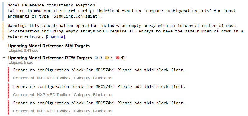

Does the Model Based Design toolbox support Model Referencing?

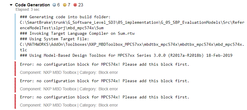

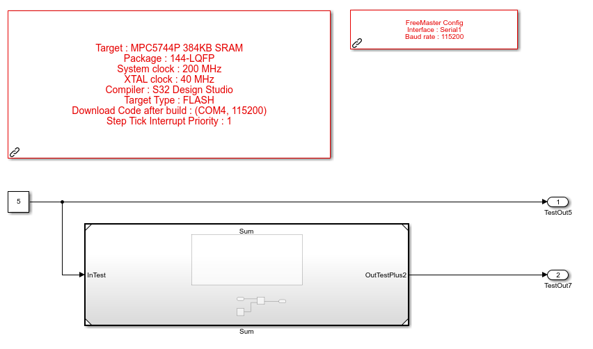

I am trying to build a simple example using Model Reference Block from Simulink, as you can see below:
But I am getting the following errors:
How can I build the model using model reference?
Kind Regards, Rafael Barbosa

I am trying to have the configurations and interfaces of the peripherals in separate reference models, and the MCU configuration block in the model of Model, any hint on how I can achieve that?
6,944件の閲覧回数
mariuslucianand
Hello @Wensh ,
The MPC57xx toolbox uses a custom .tlc file based on the ert.tlc. For now, you have to add our configuration block to all of the referenced modes. Adding our configuration block should not affect the simulation at all. One way of keeping all the referenced models in sync with the top model is to save the Configuration for the top model and propagate it to the reference models.

It is supported. Please have a look at the PIL example in the toolbox or here: https://community.nxp.com/thread/453726
You need to add a config block into the reference model too. (we currently working to remove this kind of limitation)

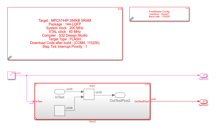

Regarding the PIL example, I could to run it here. However this example is different from what I am trying to do.
As you can see below, this model should just be executed and just the referenced block is build in the hardware.
In my current situation, I am trying to build the model with an inner referenced model.
And I can not do it.

ext-rafael_barb

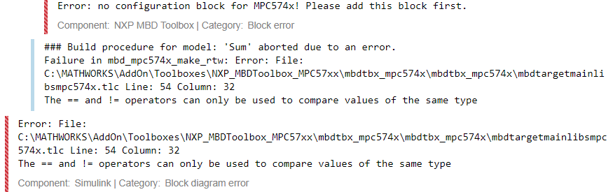

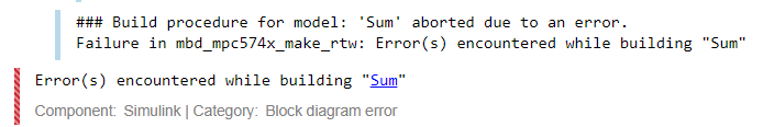

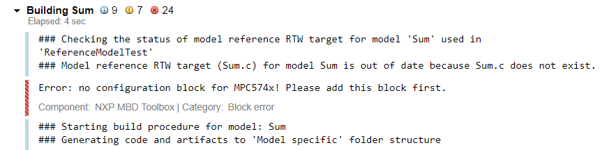

Hi Daniel,
I added a configuration block in the referenced model as well, but I still could not build it.
When trying to build the above model, I got the following error message:
It is important to mention that I could build the referenced model "Sum" in the board, before used it as a reference model.
