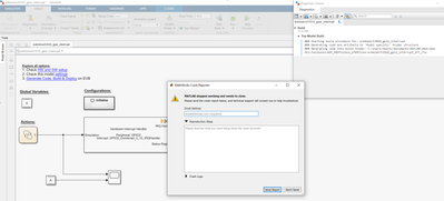

I'm trying to work though some of the examples but as soon as I try to build the code Matlab crashes.

Attached are the crash reports and images of my system+settings.
How can I resolve the issue?

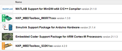

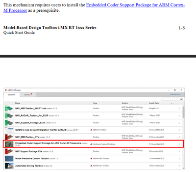

As an information point.  It isn't listed in the Quickstart Guide that "MATLAB Support for MinGW-w64 C/C++ Compiler" is required:
Sam_ECU_0-1652267558011.pngSam_ECU_0-1652267558011.pngSam_ECU_1-1652267600347.pngSam_ECU_1-1652267600347.png

I was not able to replicate this issue on my side. Can you check if you have installed the Embedded Coder Support Package for ARM Cortex-M Processors and  MATLAB Support for MinGW-w64 C/C++ Compiler?

I didn't have "MATLAB Support for MinGW-w64 C/C++ Compiler".
