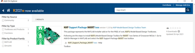

The NXP i.MX RT1xxx Toolbox enables automatic code generation for peripherals and applications prototyping from MATLAB/Simulink for NXP’s i.MX RT 117x, 106x & 101x Series of crossover MCUs.
The toolbox can be installed from Matlab add-ons page:

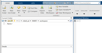

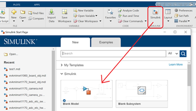

Step 1: Better to start on clean so first lets create folder to be used as workspace and switch MATLAB current folder to point to this workspace location:
Step 2: Create a Simulink Blank Model.
Step 3: Save and name your new model (E.g. mytest.slx).

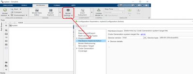

Step 4 : Choose the NXP IMXRT hardware board from the Model Settings in the MODELING tab.
        Step 4.1: Open  Model Settings -> Hardware Implementation menu
        Step 4.2: Select the NXP target from Hardware Board. This selection should match the             evaluation kit you plan to test the code for. After the selection is made, press the Apply button.

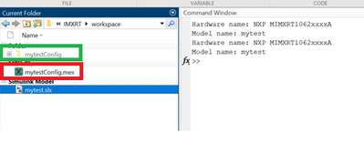

After the target is set, the workspace will be populated with new files and folders:
  • A file with extension <model_name>Config.mex – this is the file created with MCUX Configuration Tool that is used for pins, clock, and peripherals initialization. This configuration file will have enabled the peripherals that are supported by the toolbox. Starting from this, the user can change the default configuration for any of the peripheral instances (add new instances, disable instances, etc.) and also any of the configured pins.
  • A folder with naming pattern <model_name>Config -  this folder will have a structure that is similar to the MCUXpresso IDE projects, and will contain the SDK files that are needed to build the model and generate a binary application that will run on the board.

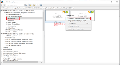

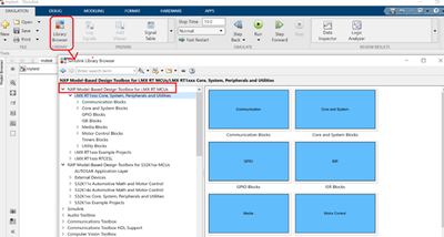

The user can now add Simulink blocks in the model from the NXP i.MXRT1xxx Simulink library from Simulink Library Browser:
Choose the desired block to add to the model:

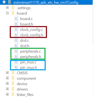

The new initialization settings, will be included in the Build Model step. The Toolbox will trigger a code generation starting from the .mex file. The generated files will be saved in the <model_name>Config folder, in board folder.

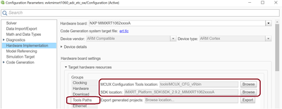

The default MCUX Configuration Tool used can be changed from Model Settings/Hardware Parameters / Tools Path, and the user can provide his/her own installation of the tool. Same approach is used with the SDK platform. The toolbox incorporates the release version of the SDK for the IMXRT1xxx targets. Also this path can be changed by the user, but it must consider possible integration issues of the toolbox with the user specified SDK.

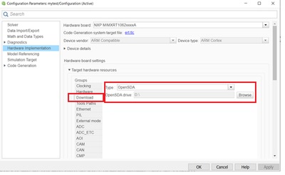

After the Simulink model is completed, follows the build and deployment of the model on the target board. Before Build and Deploy, the user must set the download method of the application.
Step 1: Select the Download method from Hardware Implementation in Model Settings.
The default Download method (without the need for additional software and/or hardware probes) is OpenSDA. For this, the user must select the Drive on his/her machine where the OpenSDA firmware of the board is mapped after the NXP evaluation board is plugged in via USB.
