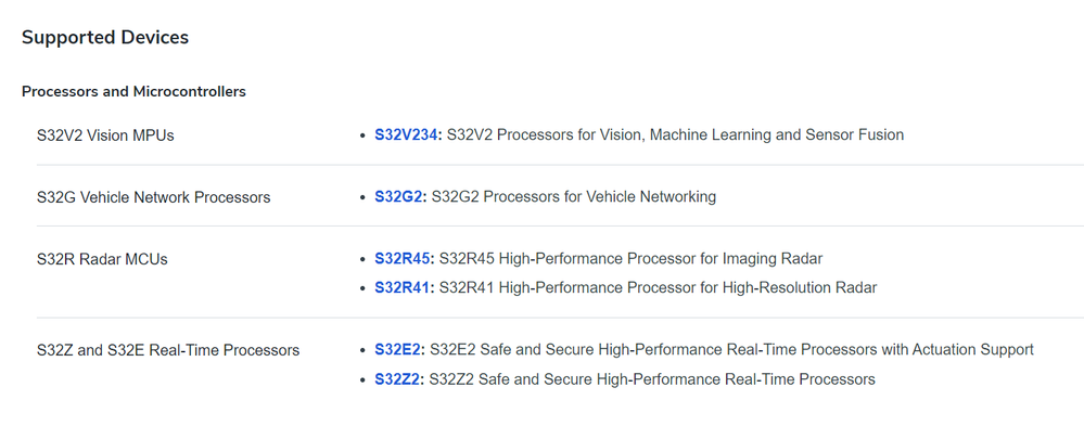

How can I program the MR-CANHUBK344 board using the S32 Debug probe with application generated using MBDT?
3 返答(返信)
1,701件の閲覧回数
robertv
Hello Chibi,
Unfortunately, the S32 Debug Probe does not provide support for S32K3, so it cannot be used to program the MR-CANHUBK344.
Programming the MR-CANHUBK344 board can be done using a J-Link Mini. The process of setting up the board, creating a model with MBDT and downloading the program to the board (using the J-Link Mini) is described in this newly written article that focuses on the MR-CANHUBK344: https://community.nxp.com/t5/NXP-Model-Based-Design-Tools/Interacting-with-Digital-Inputs-Outputs-on...
