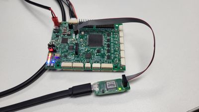

I connected the board through an external debugger - Segger J-LINK MINI (I was told recently that I need an external debugger to flash the codes in to the S32K344 board).
I noticed that the RGB LED status on EVB which was green before, turned blue now & it stays blue all the time now.

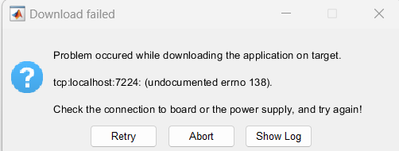

Also when I try to flash an example model 's32k3xx_dio_s32ct', I get the below download failed message (I was able to successfuly flash once, but now I cannot repeat the successful flash again).

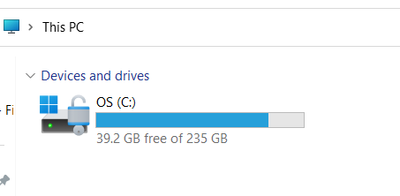

Also I noticed that the USB drive is not recognizing the board. Is this normal?
Attaching the error log in the thread.

After looking at the attached picture all the wires seem to be connected correctly, so i'd initially rule that out as a potential problem.

My first guess would be that one of the settings in the Hardware Implementation/Target Hardware Resources tab is not configured properly. This is all covered in the article so I would kindly ask you to double-check whether your settings resemble the ones presented there.
Still, there are a few things worth mentioning. Currently there is no configuration project for MR-CANHUBK344 included in the MBDT so it's being treated as a custom design. This means that for the examples to run properly, the user has to configure the board's pins and peripherals in the external Configuration Tool of choice (MBDT also comes with S32 Config Tools).
One such custom configuration project can be found in the linked article and it is set up to allow interacting with Digital I/Os, ADC Potentiometer, PWM (Red LED), UART and FreeMASTER.
