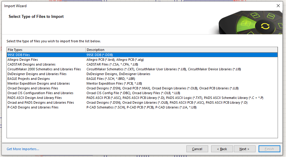

I'm facing the same problem because I'll develop a board that will be like a shield for DEVKIT-MPC5748.
Then I need the layout file of the devkit in a format that altium opens. Altium just opens allegro format if allegro is installed on the pc but allegro isn't free.
Altium can open different types of files according image below:
Is it possible to send the layout file in a different format than allegro?

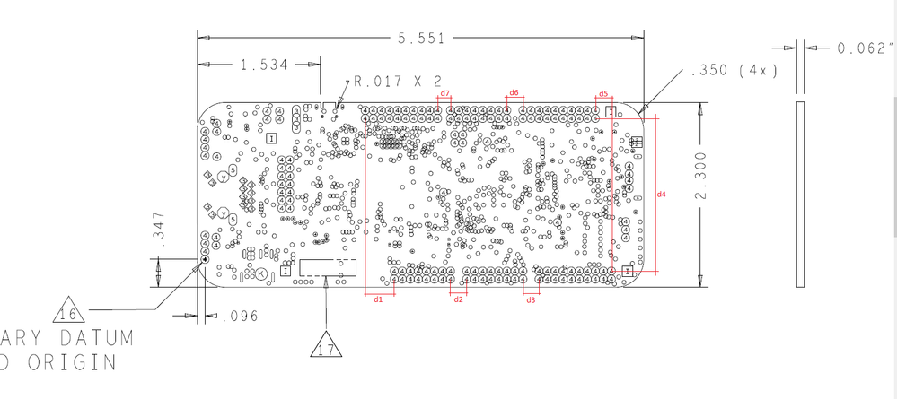

The main information I need is the distances between the center of holes that are indicated in the figure below.
This distances need to be very precise because as I'll do a shield for this board if the connectors doesn't match I won't be able to connect the boards.

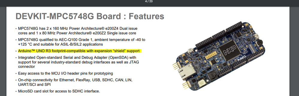

As far as I understand, you only need the pins header locations for your shield.
One of my suggestions would be to try to open the Gerber files and get the information required from there.
Another important piece of information I can give you is that, according to the QSG here https://www.nxp.com/docs/en/quick-reference-guide/DEVKIT-MPC5748G-QSG.pdf , the board is Arduino UNO R3 footprint-compatible so, being an open-source project you can get more easily the locations you need for the Arduino shields. You only have to use 2x headers but there are the universal 2.54.

Following alican özpay question, I am also looking for DEVKIT-MPC5748G mechanical design or dimensions details, which do not appear in the electrical schematics & layout files in your link. Where can I get this information from?

Unfortunately I am software guy so, I think the only public information you can get is stored in one of those archives. The mechanical information can be retrieved from the gerber files. Also, inside one of the archive I've found a pdf containing the following screenshot:

Thank you very much Marius-lucian Andrei!
No need to apologize, SW people are very important :smileysilly: :smileyhappy:
We will use this PDF.
