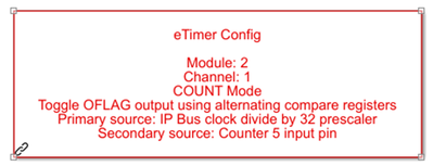

When I configured input capture based on MBD to measure the frequency and duty cycle of PWM, I encountered a problem:
First of all, I configured one input capture according to the official example, as follows:
The code generated by this model is working properly,Then I continued to configure a few others, but found that they did not work properly, the configuration is as follows:

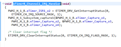

Through debug, it was found that this inoperable code did not generate a configured interrupt, that is, Input Capture 2 Flag Interrupt, and the corresponding interrupt function is as follows:

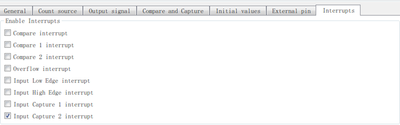

Of course, I have set the corresponding interrupt in the model and made sure that the PWM signal is input to the chip, as follows:
