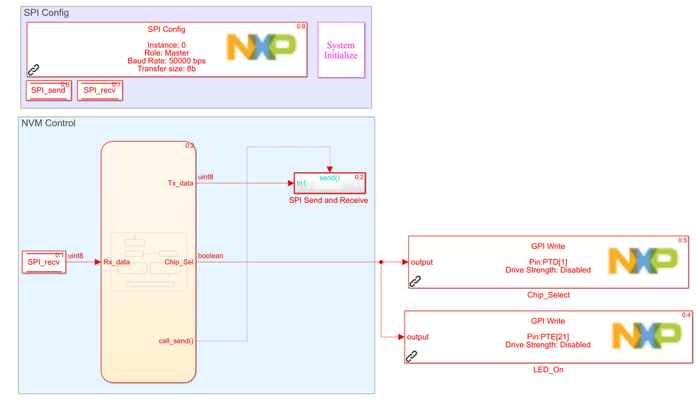

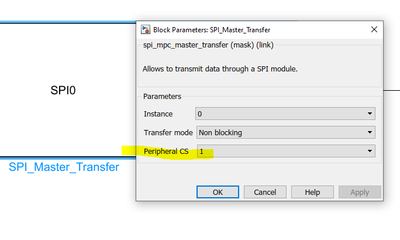

Chip is connected to SPI0 with CS1
And I have used these settings for SPI blocks

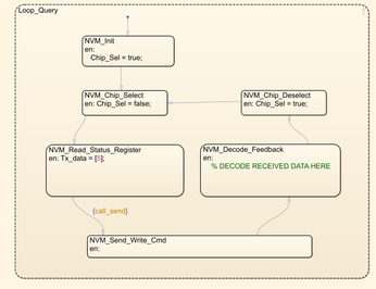

Then have prepared stateflow diagram to send control commands

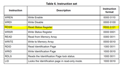

where Tx_data is control command (RDSR) from M95M01 datasheet
and this command goes after chip is selected
Finally I have got following model.

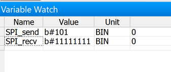

After flashing, I have used Freemaster to check SPI feedback signal from NVM and it is always 0xff.

Hello @sonik82 ,

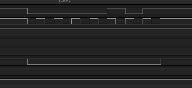

I had a look at your model and attached the model with a couple of changes. I don't have access to your board and I cannot test it, but I had a look at the signals using the logic analyzer. See the image attached below.
1.  SPI settings - for that you can select the CS pin in the SPI_Config, you don't need to change it by hand. To select the device you can select the CS in the Master transmit block, the one you have already used.
2. In the Stateflow, you can remove the chip select state, because the DSPI will handle that, so you can only send and decode the responses from the SPI.

As per datasheet, we need to keep Chip select low while sending command and getting data from chip
Your image shows that Chip Select goes High after transmitting of command, am I right?
Is it possible to keep this signal Low until we will get data?
